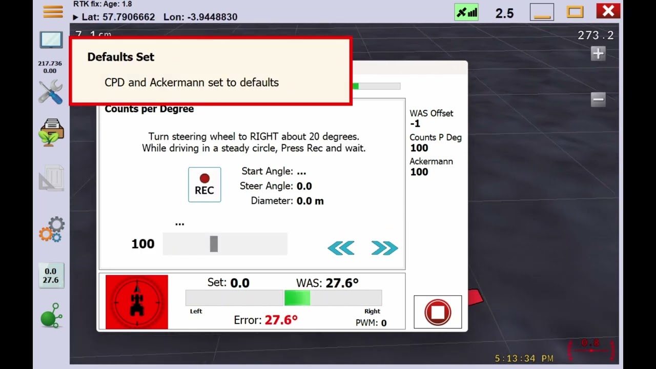

I don’t know if you have done the steer wizard yet but I would start over and do it again. Leave the integral at zero. That is for side hills and will only serve to confuse you when you are getting started. Familiarize yourself with with the settings generally do and it will make tuning much easier.
