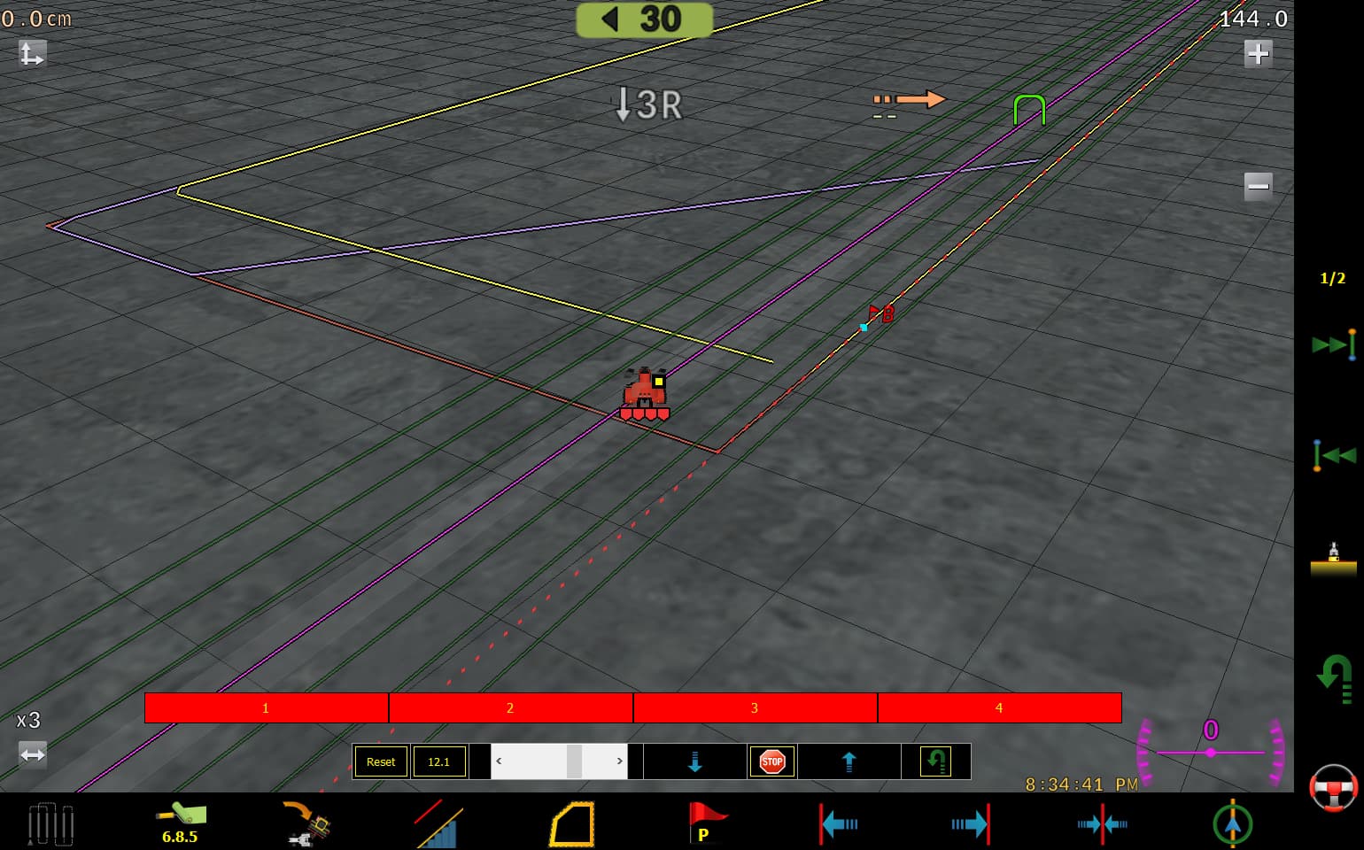

Sorry for reviving this old topic. I use latest version and had similar problem. I use u turns on larger fields and one field surprised me when tractor started U turning in the middle of the field. I noticed an additional line going diagonally across the field and when I drove near it it triggers a u turn.
I found a way to avoid it but Id like to know why it happens?

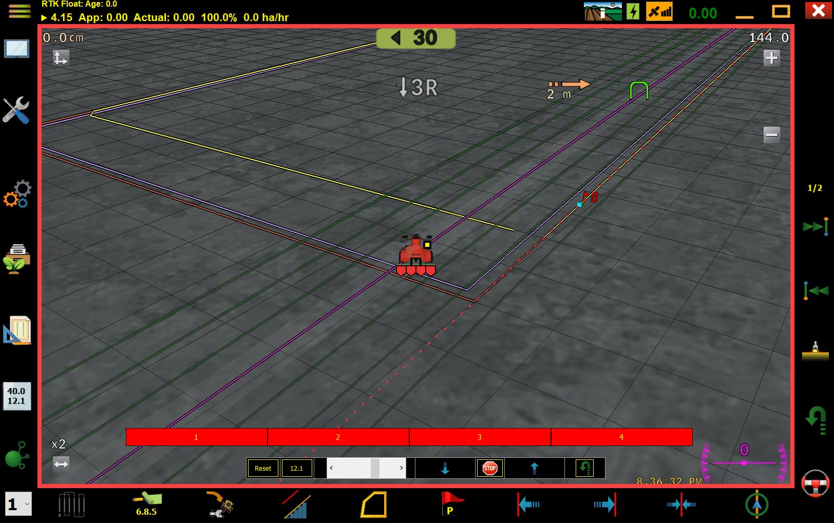

This wierd purple line that connects the two boundaries is the trouble…

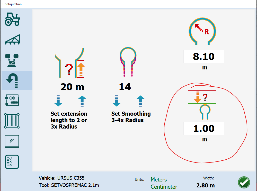

If I put higher value here:

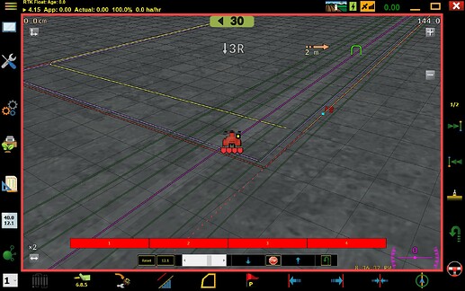

If I put 1 for example it looks like this:
I hope you didn’t tried with 0. Putting 1 or higher solved the issue?
I actually did, and it works on most of the fields, this one is fine when I put 1.
