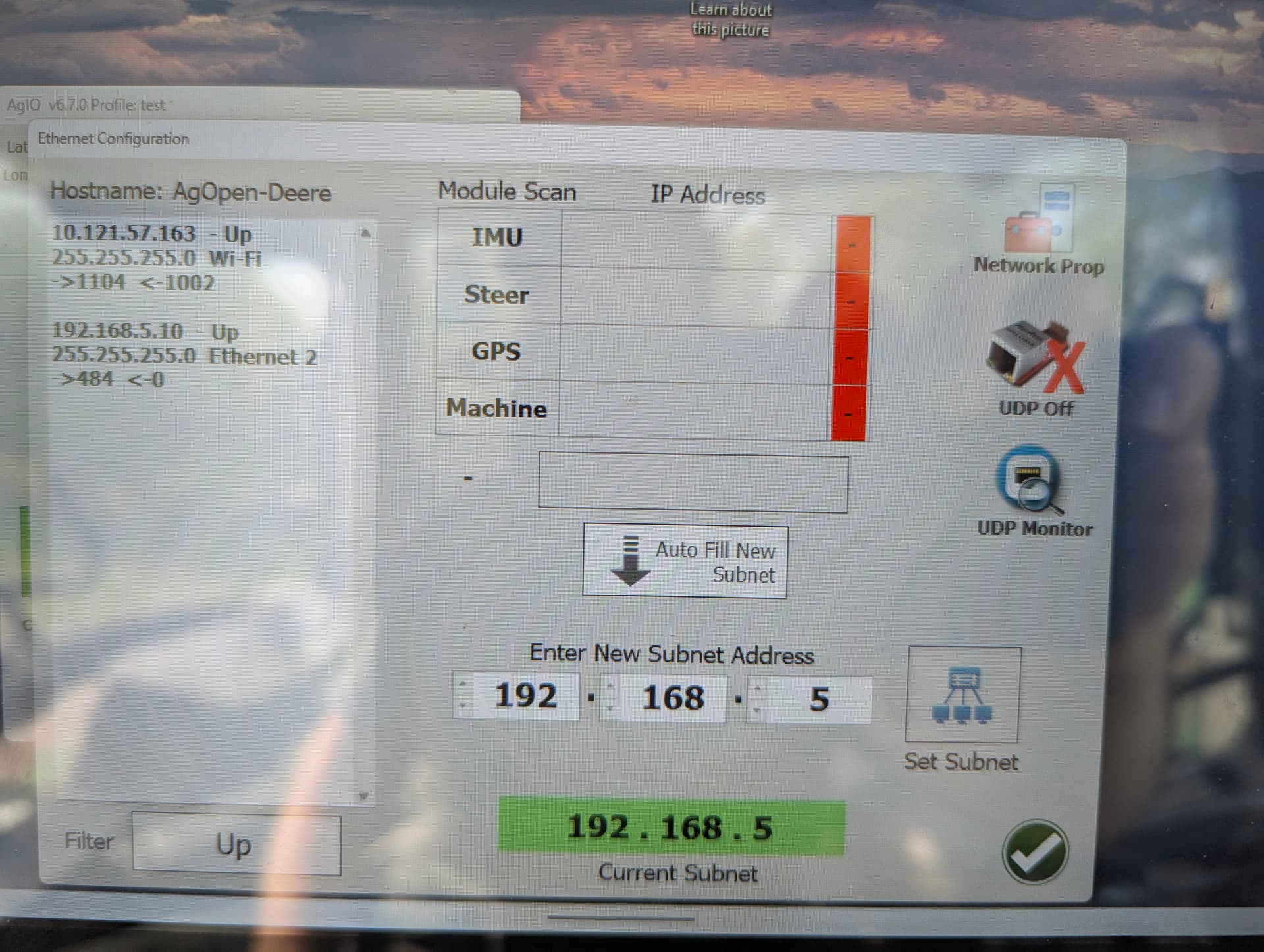

I have been running a v4 agio board for a full season. I wiped my tablet to clean things up and am now running v6.7 agio and agopen. I can’t seem to get the board to be seen by the tablet. I have tried with a laptop with the same settings to test and it sees it immediately. I’m at a loss. I did try testing on a home network to test the adapter and it sees the network at home. I must be missing something simple.

What if you tap the ‘UDP Off’ icon in the top right of your photo then hit the green checkmark on the bottom right?
That just turns off UDP. I tried cycling it to no avail.
