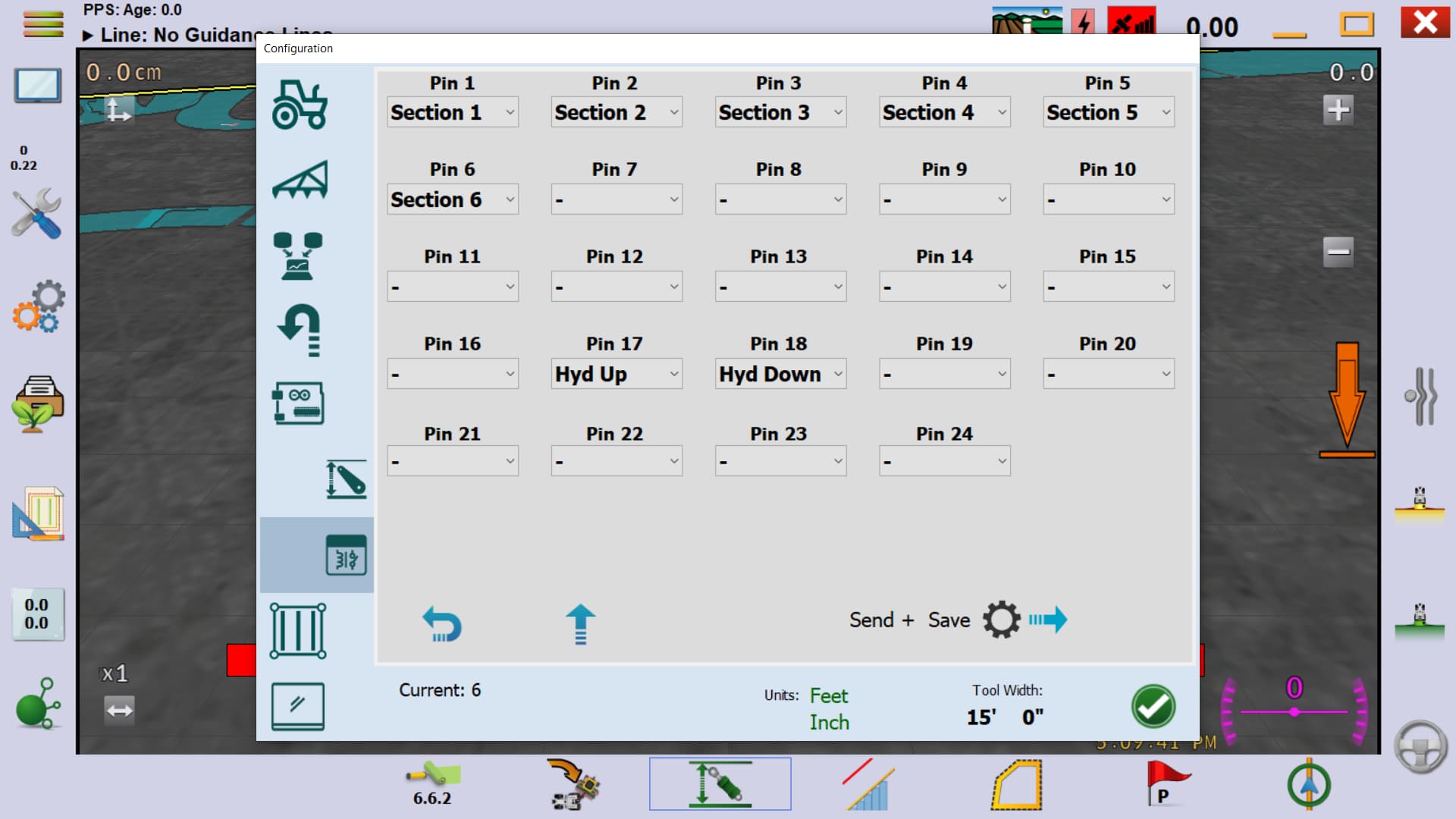

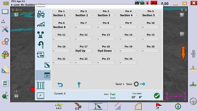

I have been working on my machine board and have it mostly together but I am yet to get the hyd Down to work. Using UDP with a nano to control sections and hyd up/down. I have tried a few different outputs on the nano and changes to the code but no different. I get the proper Up function when crossing the headland but never Down? Only other odd thing it always shows save and send anytime I open the machine board setting even if I have yet to change.

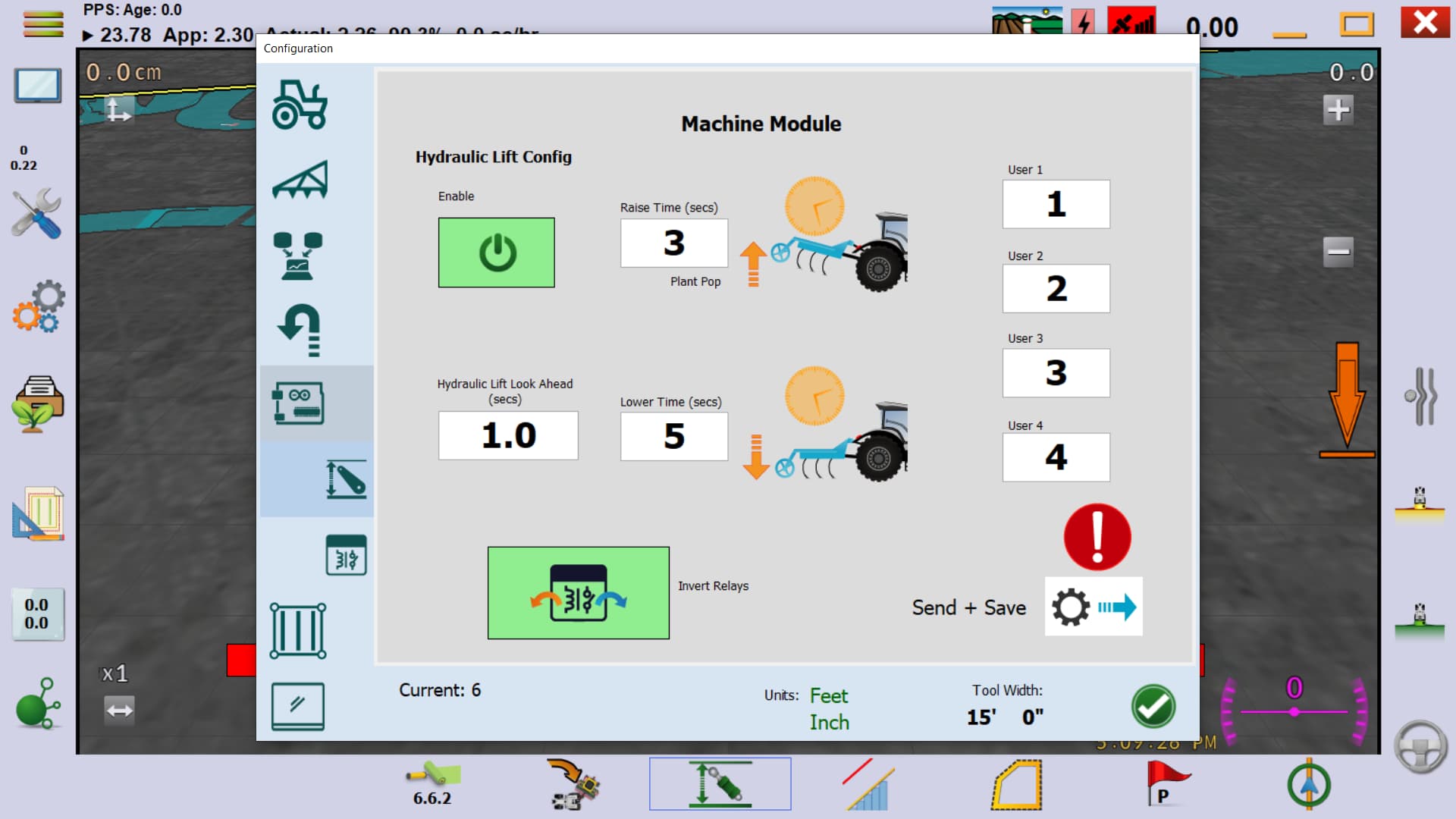

uint8_t raiseTime = 2;
uint8_t lowerTime = 4;
uint8_t enableToolLift = 0;
uint8_t isRelayActiveHigh = 0; //if zero, active low (default)
uint8_t user1 = 0; //user defined values set in machine tab
uint8_t user2 = 0;
uint8_t user3 = 0;
uint8_t user4 = 0;
}; Config aogConfig; //4 bytes

* Functions as below assigned to pins
0: -
1 thru 16: Section 1,Section 2,Section 3,Section 4,Section 5,Section 6,Section 7,Section 8,
Section 9, Section 10, Section 11, Section 12, Section 13, Section 14, Section 15, Section 16,
17,18 Hyd Up, Hyd Down,
19 Tramline,
20: Geo Stop
21,22,23 - unused so far*/
uint8_t pin[] = { 1,2,3,4,5,6,0,0,0,0,0,0,0,0,0,0,17,18,0,0,0,0,0,0 };

else if (udpData[3] == 238)
aogConfig.raiseTime = udpData[5];
aogConfig.lowerTime = udpData[6];
aogConfig.enableToolLift = udpData[7];
//set1
uint8_t sett = udpData[8]; //setting0
if (bitRead(sett, 0)) aogConfig.isRelayActiveHigh = 1; else aogConfig.isRelayActiveHigh = 0;
aogConfig.user1 = udpData[9];
aogConfig.user2 = udpData[10];
aogConfig.user3 = udpData[11];
aogConfig.user4 = udpData[12];

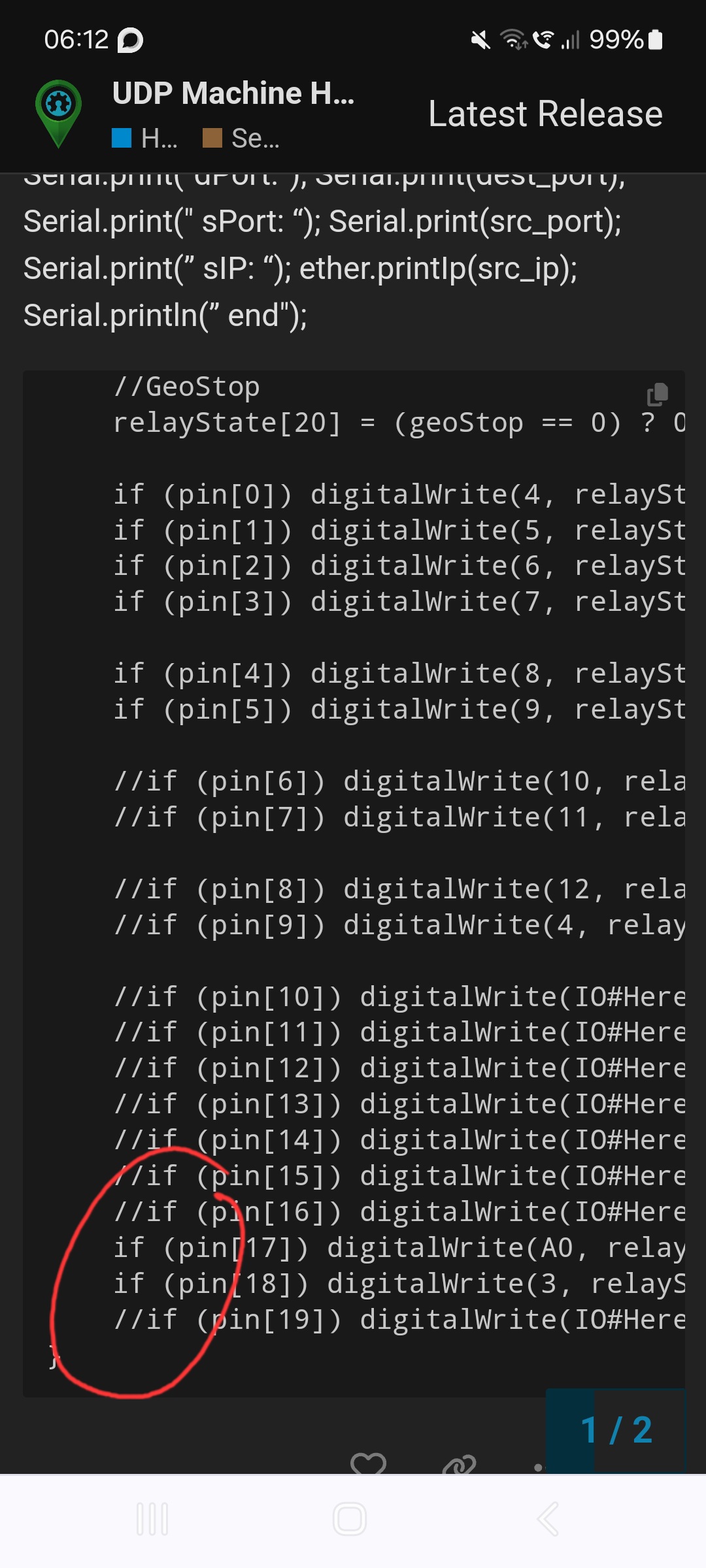

if (pin[0]) digitalWrite(4, relayState[pin[0] - 1]);
if (pin[1]) digitalWrite(5, relayState[pin[1] - 1]);
if (pin[2]) digitalWrite(6, relayState[pin[2] - 1]);
if (pin[3]) digitalWrite(7, relayState[pin[3] - 1]);
if (pin[4]) digitalWrite(8, relayState[pin[4] - 1]);
if (pin[5]) digitalWrite(9, relayState[pin[5] - 1]);
//if (pin[6]) digitalWrite(10, relayState[pin[6]-1]);
//if (pin[7]) digitalWrite(11, relayState[pin[7]-1]);
//if (pin[8]) digitalWrite(12, relayState[pin[8]-1]);
//if (pin[9]) digitalWrite(4, relayState[pin[9]-1]);
//if (pin[10]) digitalWrite(IO#Here, relayState[pin[10]-1]);
//if (pin[11]) digitalWrite(IO#Here, relayState[pin[11]-1]);
//if (pin[12]) digitalWrite(IO#Here, relayState[pin[12]-1]);
//if (pin[13]) digitalWrite(IO#Here, relayState[pin[13]-1]);
//if (pin[14]) digitalWrite(IO#Here, relayState[pin[14]-1]);
//if (pin[15]) digitalWrite(IO#Here, relayState[pin[15]-1]);
//if (pin[16]) digitalWrite(IO#Here, relayState[pin[16]-1]);
if (pin[17]) digitalWrite(A0, relayState[pin[17]-1]);
if (pin[18]) digitalWrite(3, relayState[pin[18]-1]);
//if (pin[19]) digitalWrite(IO#Here, relayState[pin[19]-1]);
