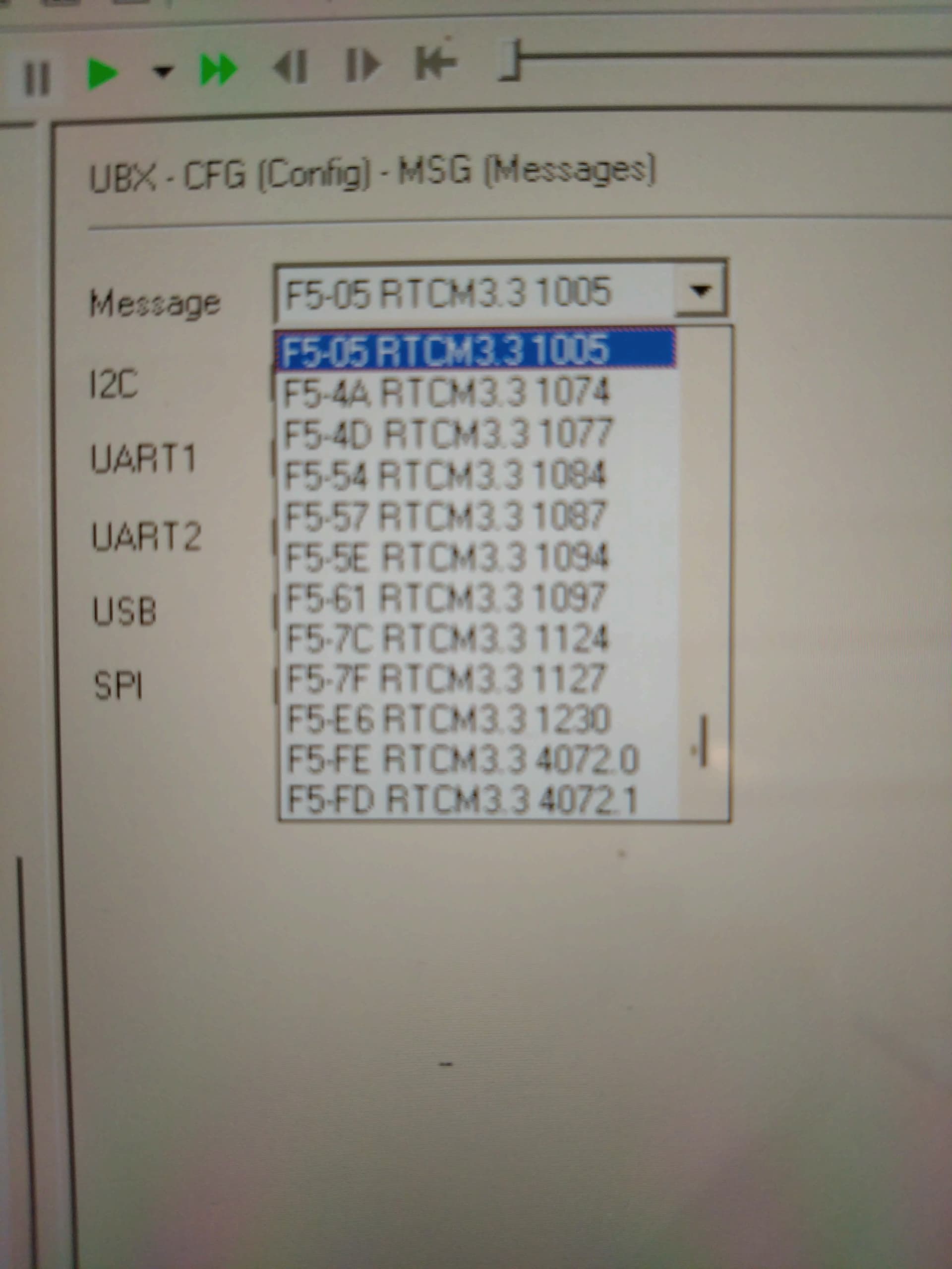

I’ve got a F9p, WiFi ntrip master base station and have been trying to update the messages it’s sending so a neighbour can connect his Topcon receiver.
As far as I know I need to include 1004,1008,1012 ,1033 alongside the messages I’m already using.
I can’t seem to find them in the ucentre message section.
Any help appreciated.

Okay just to update this,I had a reply from Ardusimple who said it’s not possible to output those messages with my setup.
