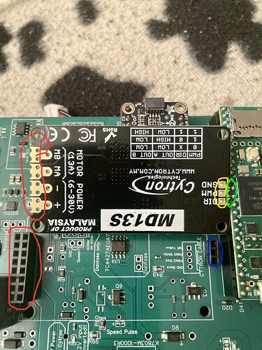

Building my first board & have a few questions
So the headers on the red side, do they fit as shown, if you look at it sideways it’s like a dog face, and using the eyes and ears for the pins?
Moving to the other side, does blue go to yellow or the green half hole ones?
Then the plug and cable, do you plug 1 end in & cut the other end off and solder to the 4 holes in the board marked with the corresponding colours?
Also when flashing teensy it needs removed from the board?
Plenty of questions and more to come….
Yes. I just plugged in the double row and the 3 pin single row , before placing cytron, and then soldering.

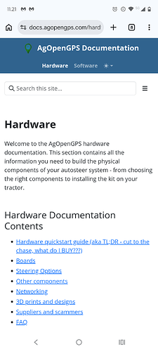

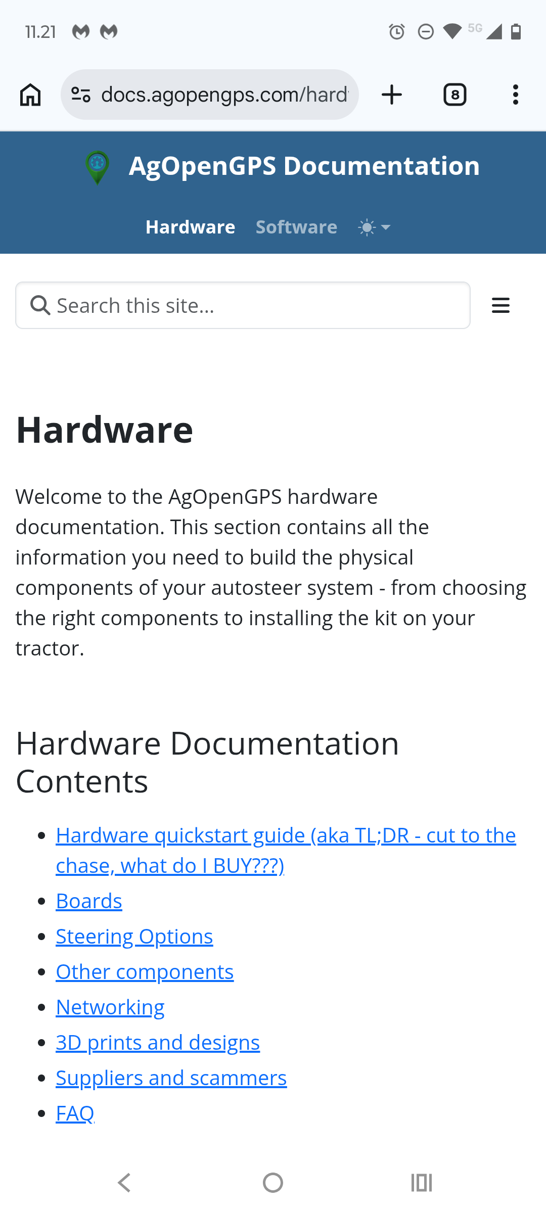

I haven’t found an overview for Al dokumentation, but this screenshot shows some
