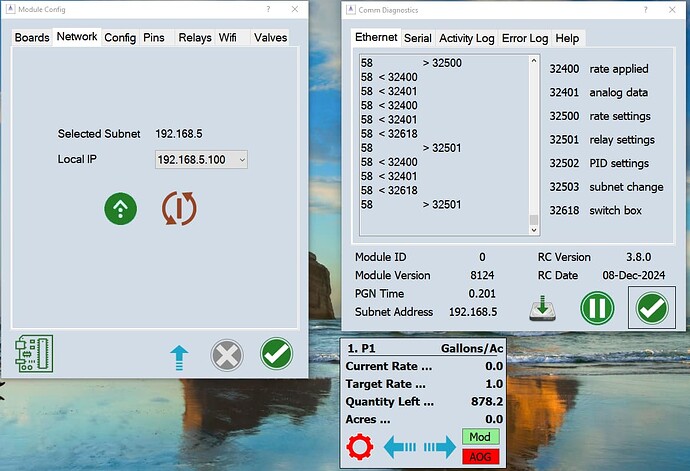

among the various attempts made I obtained a connection via lan after having loaded the firmware via arduino ide and inserting the correct ip address in the code (192.168.5.50) but as soon as I change some options and load them to the nano the lan connection is lost and I see “module id 6” and a red dot while before I had “module id 0” and a green dot. I tried to reset the network address via the app to see if it was recognized again but nothing changed. If I unplug the lan cable and go via usb everything is ok. I have an original nano, I’m thinking of trying other ethernet shields to see if anything changes.

On the diagnostics page it will show the version number.
3.8.1 15-dec-2024

Just tested release 3.8.0. The hex files in that release work with the rate app in that release. The app connects to AOG 6.4.4. Which version are you using?
Did you send the ip config and the relay pin config to the module?

Blue means the module is sending but not receiving. Try sending the ip config again.
