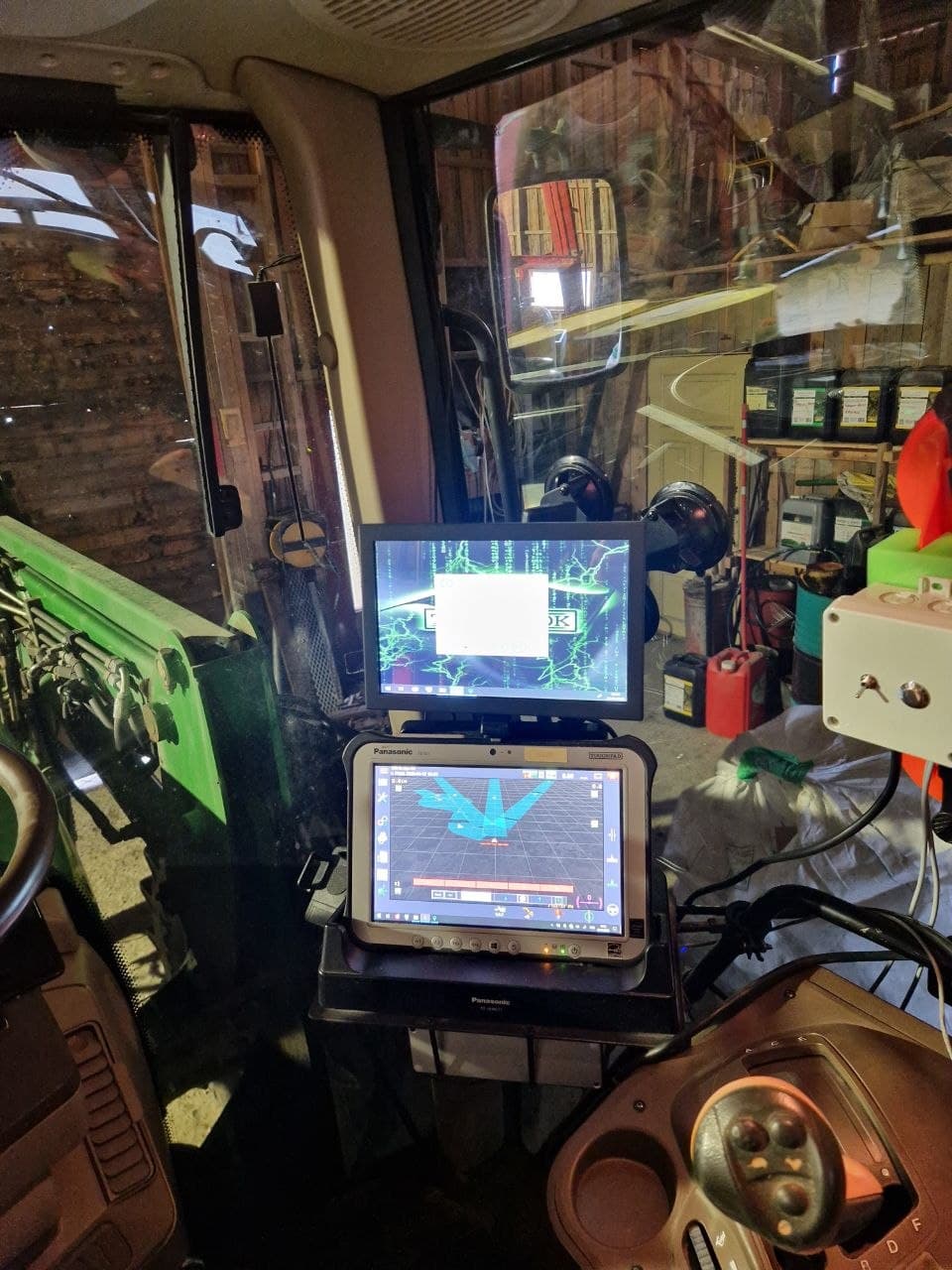

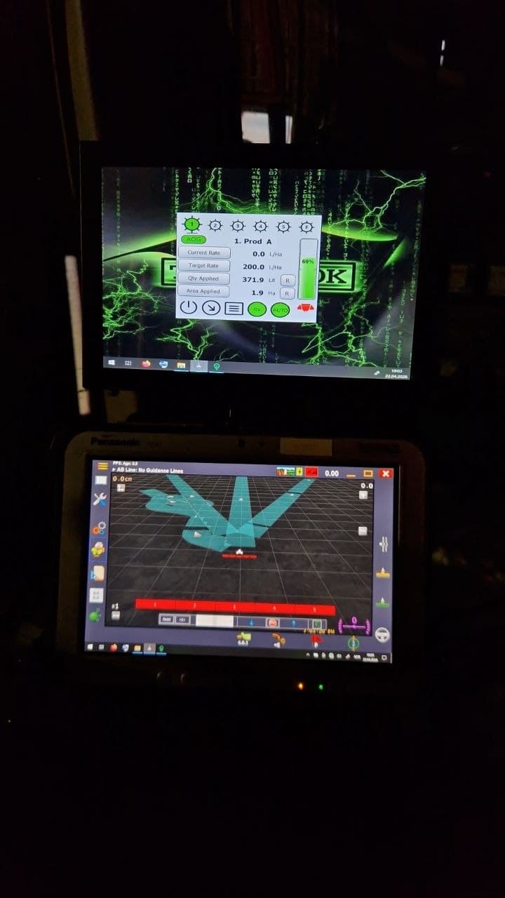

Own monitor for RC control. Think this will be great :slight_smile:
I think til will be great for isobus control. Both screen is touch so everything working.
Only thing i’am missing is fullscreen mode on RC application

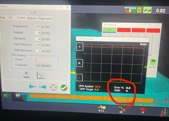

I am setting up a new tablet and either I’m forgetting a step or something isn’t working right. My sections start and stop.
My flow meter works.

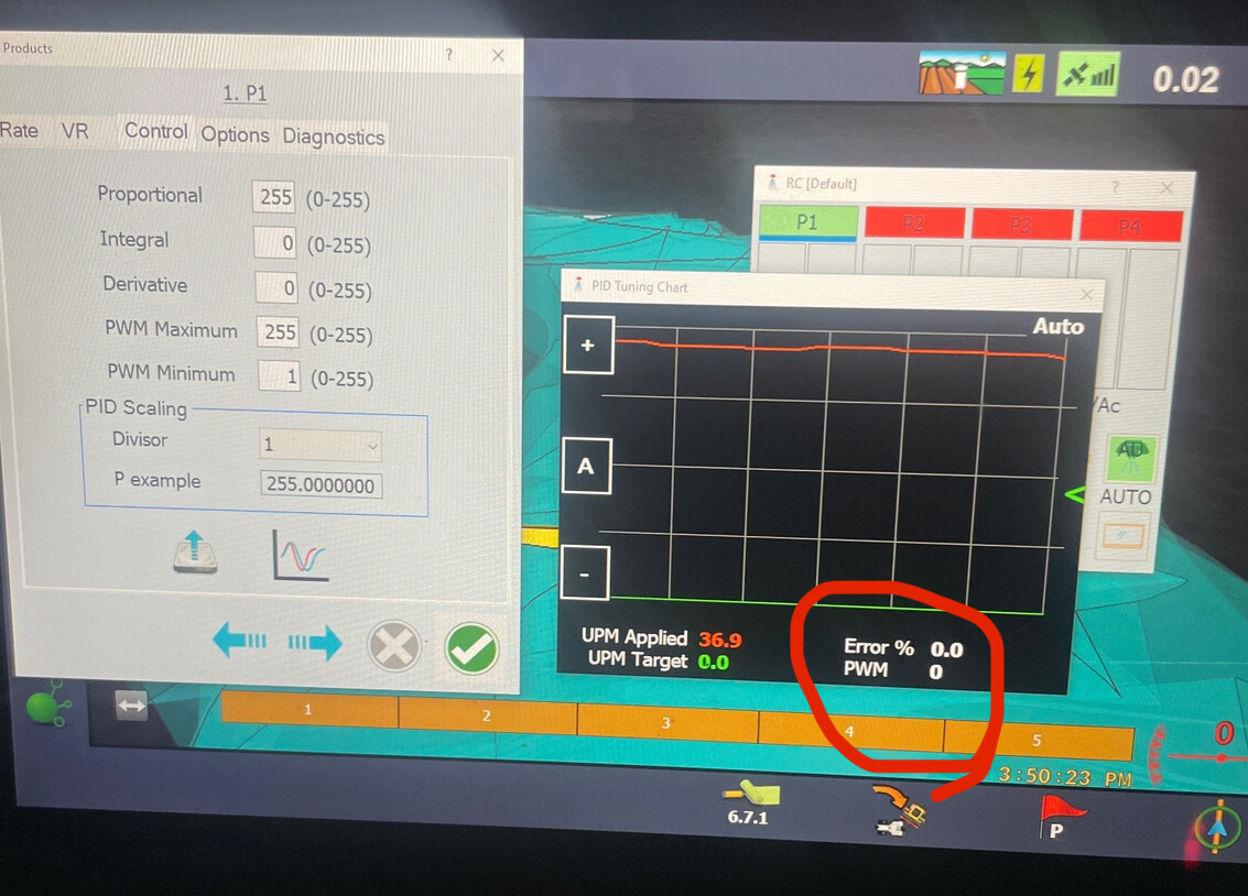

The rate doesn’t adjust. So to calibrate I open the error chart. This picture is stopped but even driving this PWM stayed at zero. I have a 2 wire valve and the board and valve worked all last year.
Should this PWM change?
Your upm target is 0. What does this page say for working width? Are the sections setup?

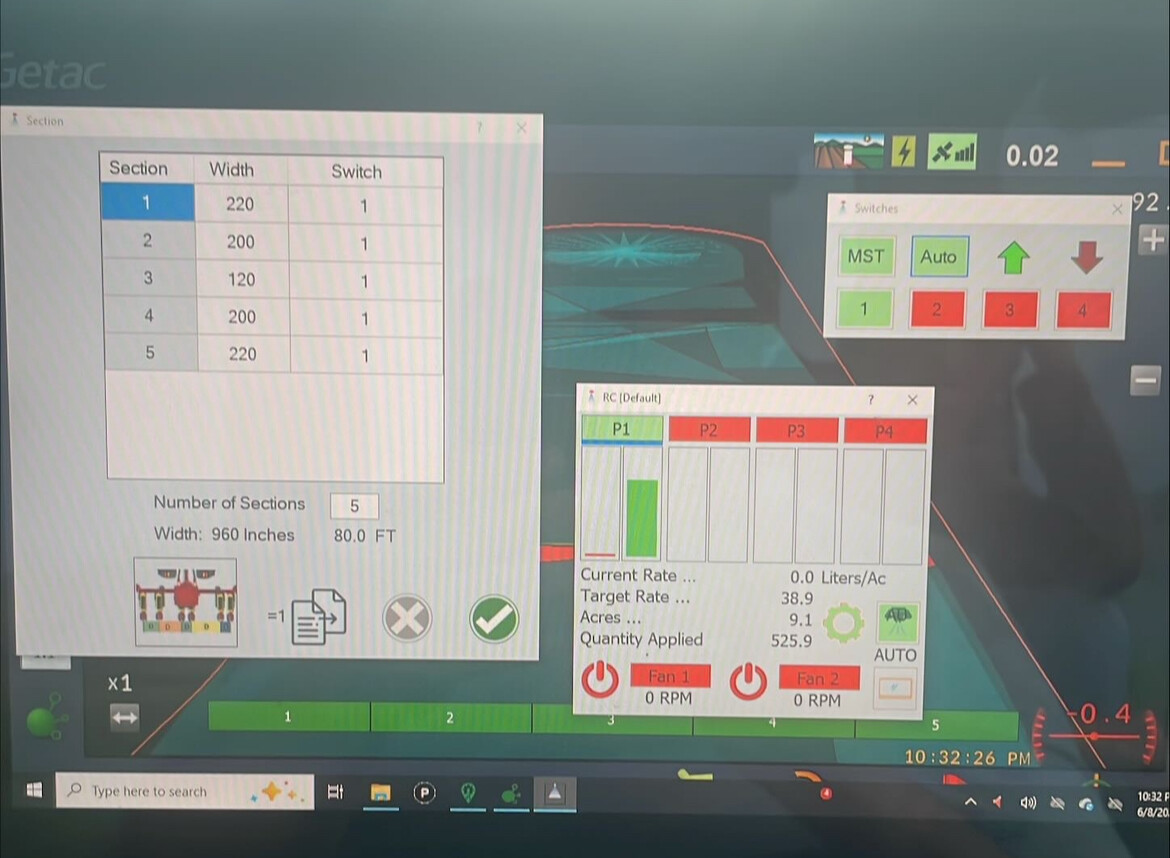

So I got the previous to work by setting all my sections to switch #1 and activating switch one, auto and master. See pic.

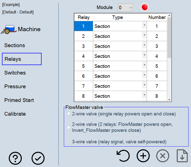

Ok you’re on the new version. I will try that version tomorrow. A quick question. The page that asks if valves are 2 or 3 wire is that sections or master. My master is 2 and my sections are 3. Does it work to mix like that?
In the old code it was all 2 or all 3. In the new code the master valve can be 2 or 3, independent of the section valves.

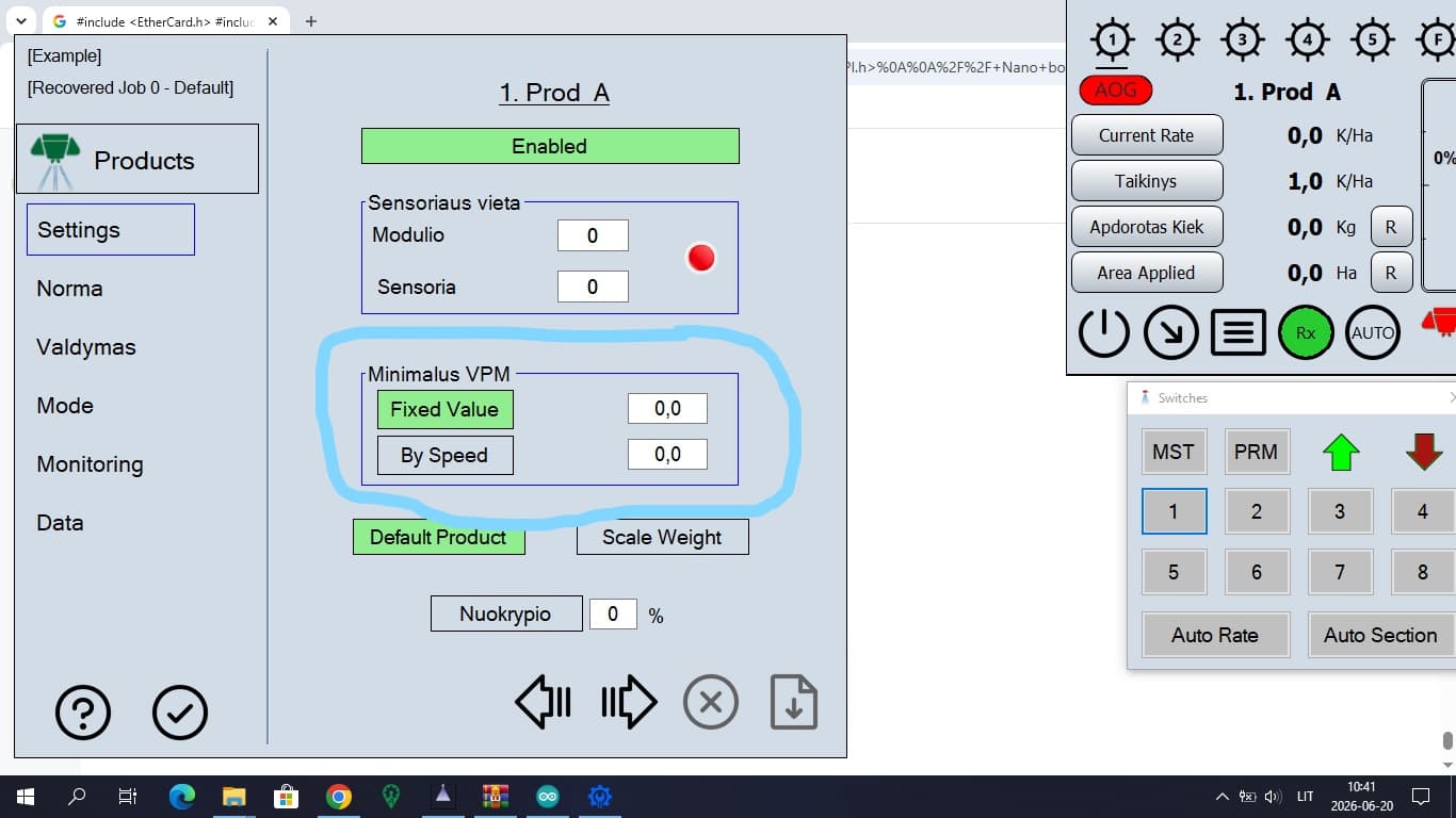

Hello. How to adjust this place correctly. When, for example, you approach an obstacle and the speed decreases, it stops spraying. When I enter some value, when I turn off the sections one by one, the pressure rises a lot. Thank you
These values can remain at 0, but they are used to set a minimum flow rate to provide a good spray pattern at low ground speeds.
