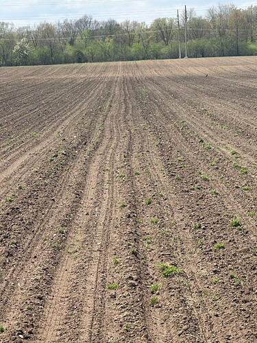

The field is pretty flat, but you can see that it wanders. He said that he saw the error creep up to 5 or 6 at times, which we’ve never seen in testing or in other fields. Steer response is at the default of 3.5 and he is planting around 5 MPH

Here’s about 2.5 acres of that field from above, you can kind of see what’s going on - https://spencerryan.com/agopengps/Miller-Road-5-2-2025-orthophoto.jpg
Here’s looking down a row

The better was 0 the straighter lines.
Also, in softer soil you should turn up the gain. It needs to be more agressive…
That makes sense. And likely the non-zero integral is what was saving it. Just wasn’t putting enough power into the motor.
We’re gonna tighten up that WAS and bump gain by 5 and see how it goes.
Watch the steer chart. If it’s too slow to react, increase P gain, if it overshoots too much reduce it.
id say up your gain to 30-40 and min to move to 30ish
sounds like your building up errors and the steering isnt reacting fast enough
