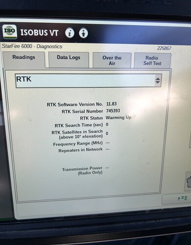

Jd have been using satellite rtk lately sf-rtk, am just wondering if thats what your current setup is unlocked to recieve as opposed to the ntrip version of rtk
You need the “mobile rtk” unlock which allows you to send RTCM in the serial port… However I am yet to be sucessfull in getting it to work…but im still told it should so i need to look into it again at some point…

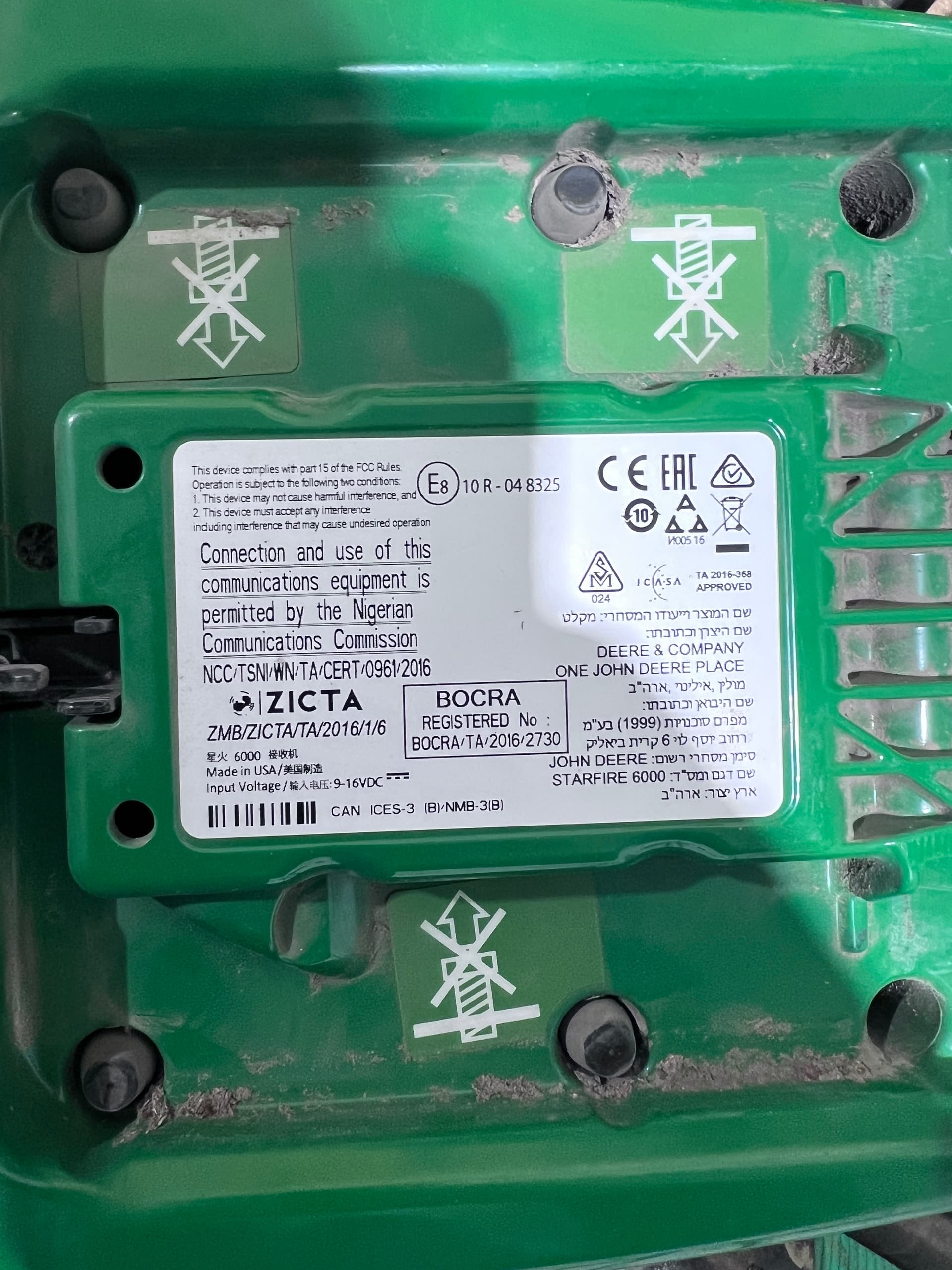

Yes, they are SF-RTK and wanted to get a modem like cloudbase modem that is plug and play for the 7000/7500’s
