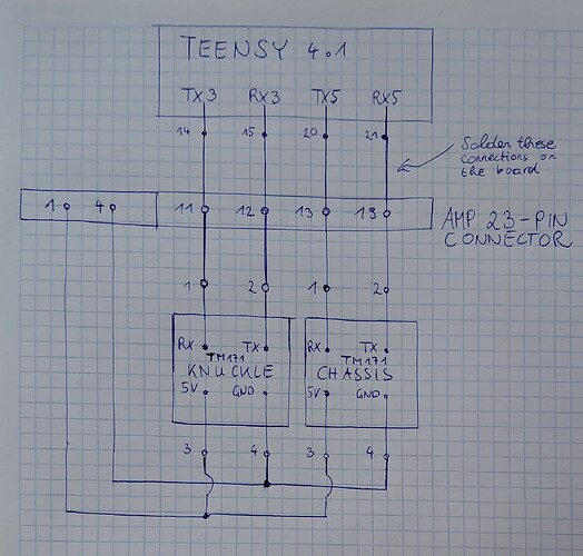

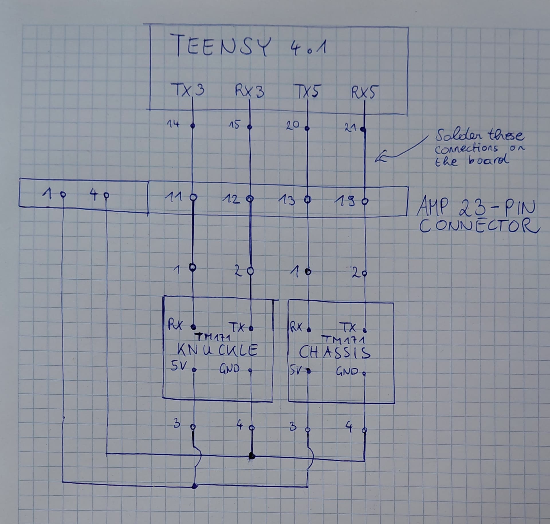

Here is a basic wiring diagram using two TM171.
The goal is to connect the serial pins of the Teensy to the serial pins of the TM171. We also connect 5V and GND from the board to the TM171.

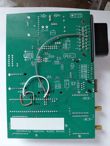

Therefore I soldered wires from the teensy solder pads to the 23 pin connector.
Here is a picture of my 4.5 Micro board:

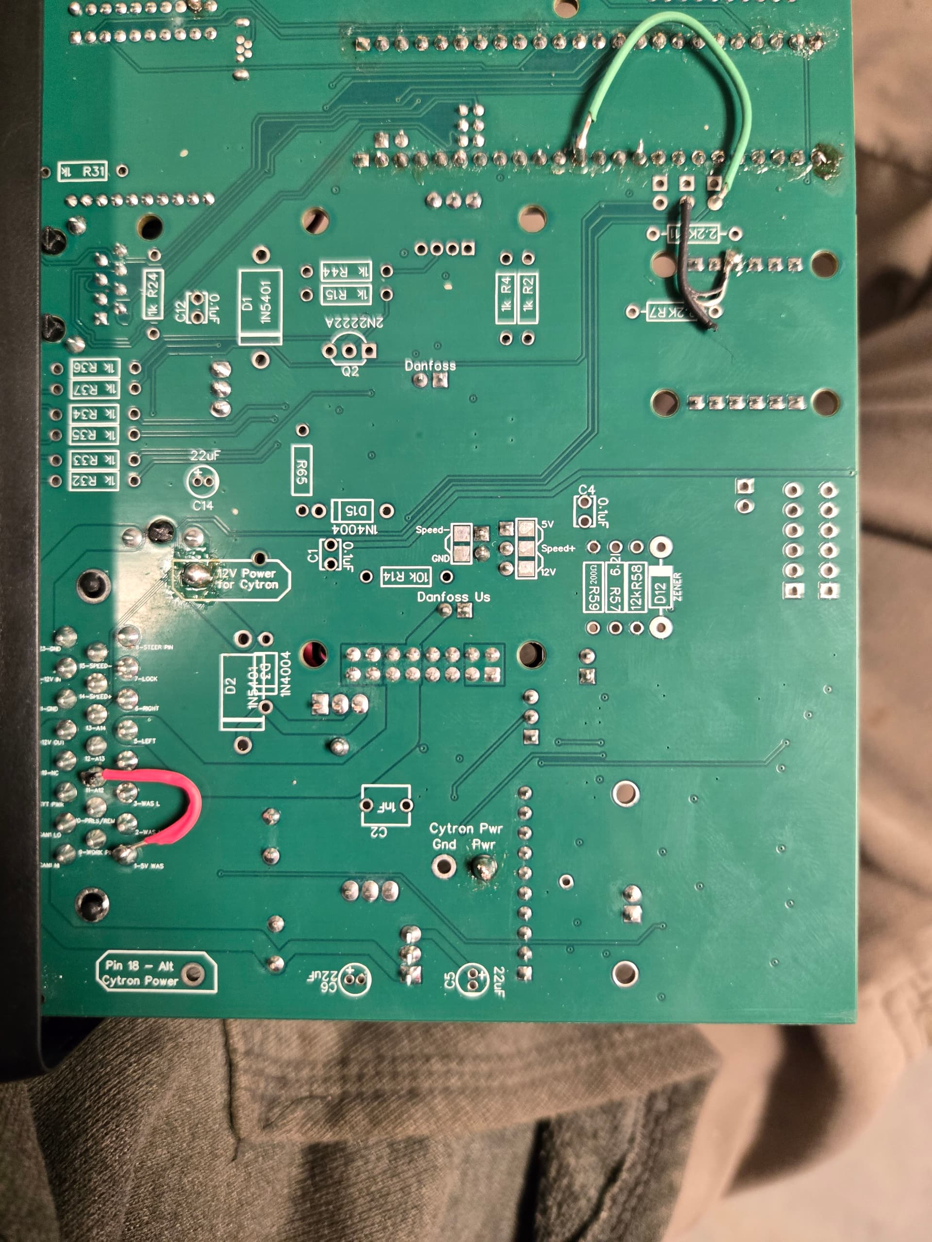

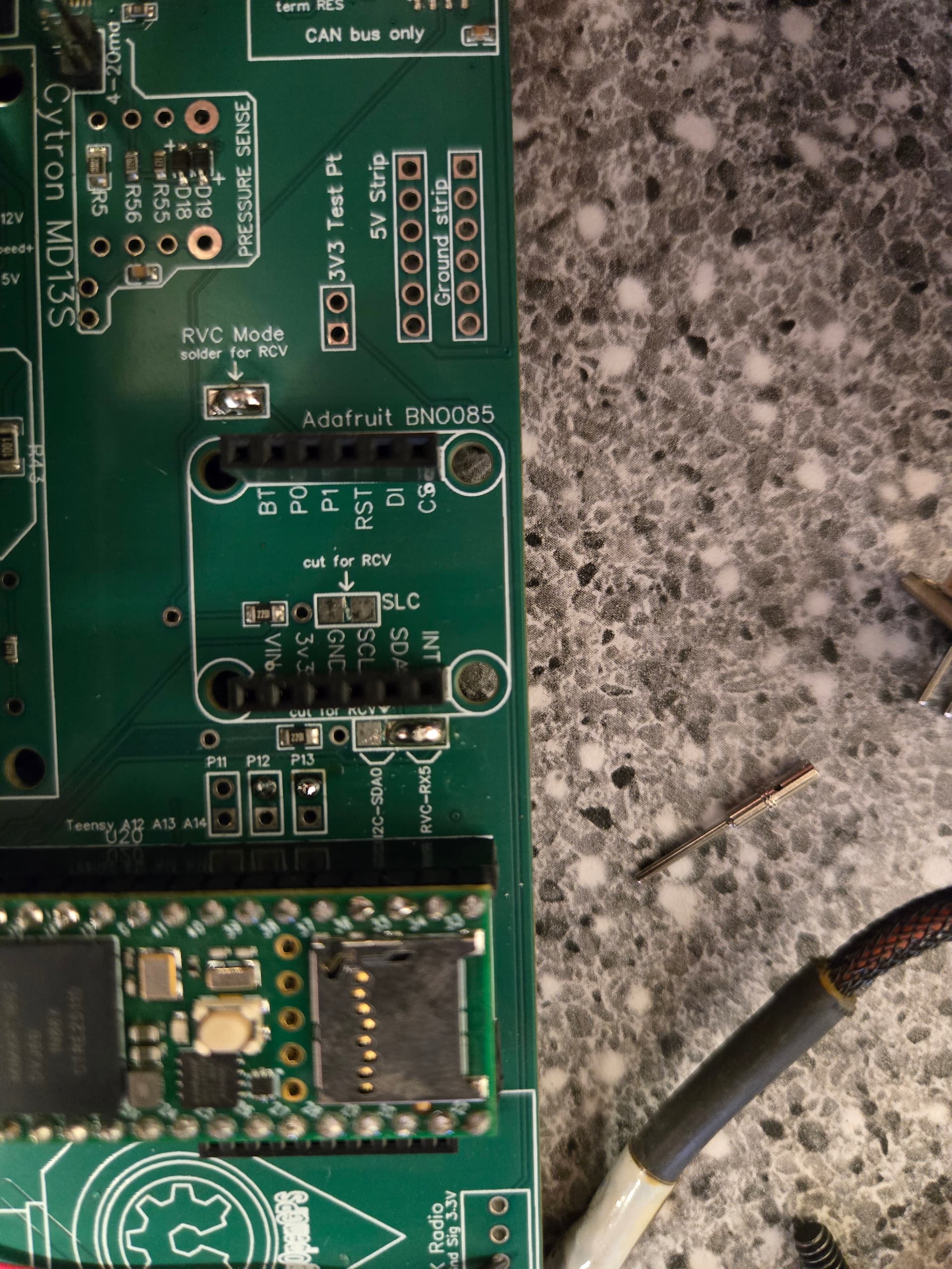

Do i have the correct spots soldered?
Does the bno085 on the board need a wire from 3.3v to p0?
I did power everything up and both bno’s light up with power. Nothing shows in agopen, neither roll or WAS. IMU doesn’t light up at all in AgIO, but gps and steer light up green.
