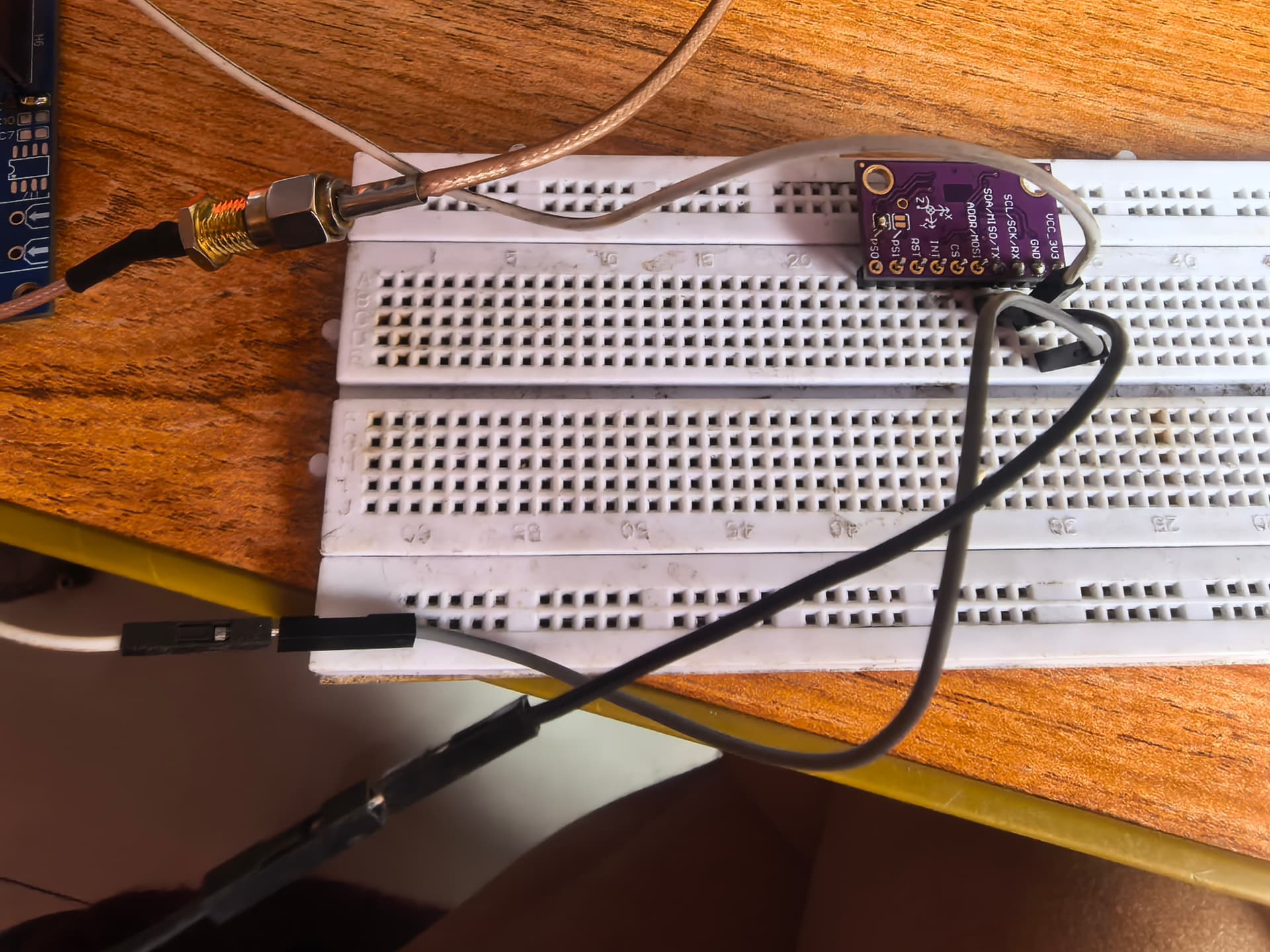

WAS is now very easy, use TM171 or BNO85 as WAS sensor
I did end up getting my bno setup working. I had loaded the wrong teensy firmware. Really cool!

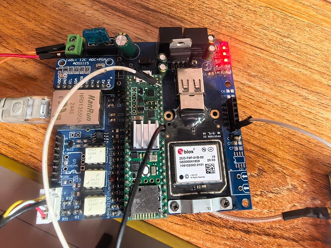

Which firmware should I install? I have the same issue with another one as well. Also, does the BNO085 on the board need to enter RVC mode? After flashing the firmware, the GPS stopped responding. I don’t know what went wrong.
If you have 2 BNO085 I used this firmwarehttps://raw.githubusercontent.com/MarekJarczewwski/AgOpenGPS-Teensy-4.1-Dual-IMU-WAS-BNO85-or-TM171-/refs/heads/main/AIO_v4_FirmwareWASBNOkorektaBNO.zip
On the board just do the RVC mods like I did in the pictures above and the wires on the bottom of the board. 2 traces to cut and 2 to solder. Nothing need done on the actual bno on the board. The bno on the axle needs a wire soldered from 3.3V to P0 I believe and that puts it in RVC mode.
I successfully flashed the firmware. The WAS is working fine, and the 085 rotates with data changing. However, the GPS and IMU have stopped working — no data at all. I’m using a board that includes a GPS module. Could that be related to the issue?"

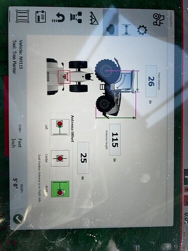

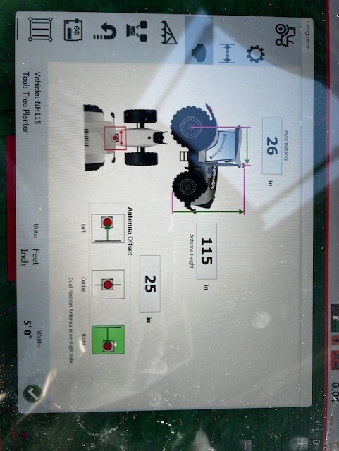

Have you tried this on a 4wd articulated tractor? I have an articulated tractor that had trimble and they used the IMU WAS which was mounted on the front of the rear part of the tractor. Where would be the best place to mount on an articulated tractor if using 2 bnos?

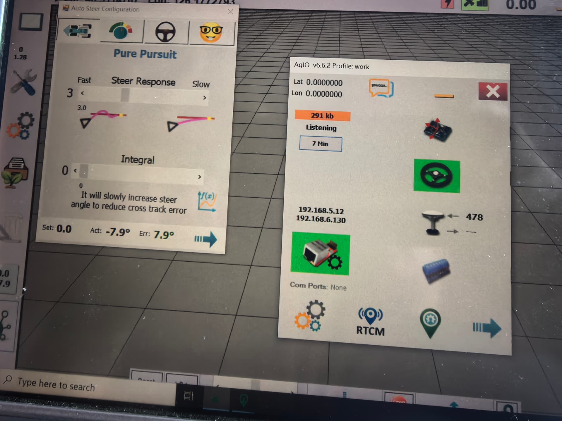

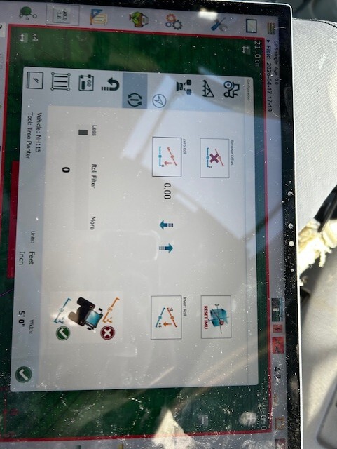

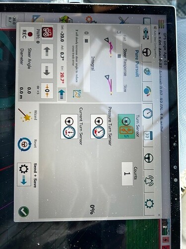

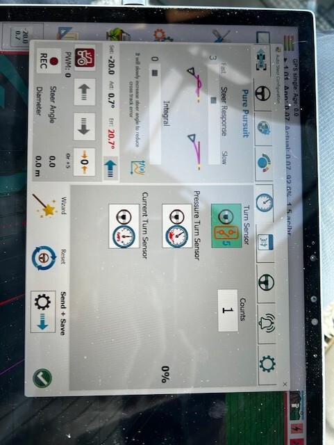

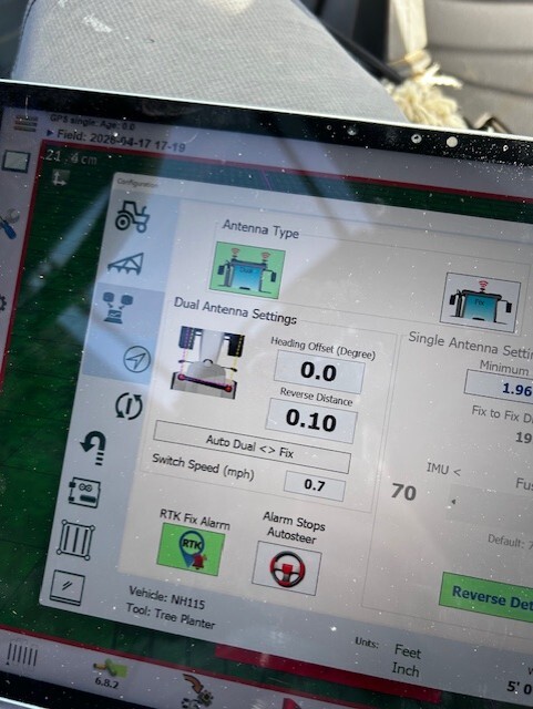

Looking for some assistance here. I have TM171 as WAS and BNO085 as the IMU in the cab. Currently using the testing software (TM171asWAS_Synchro_Test). I am getting no feed back from the IMU on the display, no angle is showing. I have tested another version of the code, with no luck. As I move around the field my tractor looks like I am travelling on a diagonal, orientation does not seems to change. This is a Dual antenna set up as well, I’ve attached some of the settings I have. Not sure If i missed something here… I have tried to go through the autosteer set up, and had no success. Sometimes the angles are too large for the calibration to be successful, and it never recognizes roll settings from the dual antenna set up. Would love some assistance in trying to get this back on track. Thank you.
I had the problem that i made a mistake in the wiring, then the Wheel angle didnt show.
Make sure you have wired TX from the teensy to RX from the TM171. And RX from the teensy to TX from the TM171.
I’m going to put both BNOs in a enclosure with the circuit board. The enclosure will be in the cab. My theory is that you want it forward of the hinge aligned with the nose of the tractor. I’ve got it put together on my workbench. If it works as well in the tractor it will be a real win.
