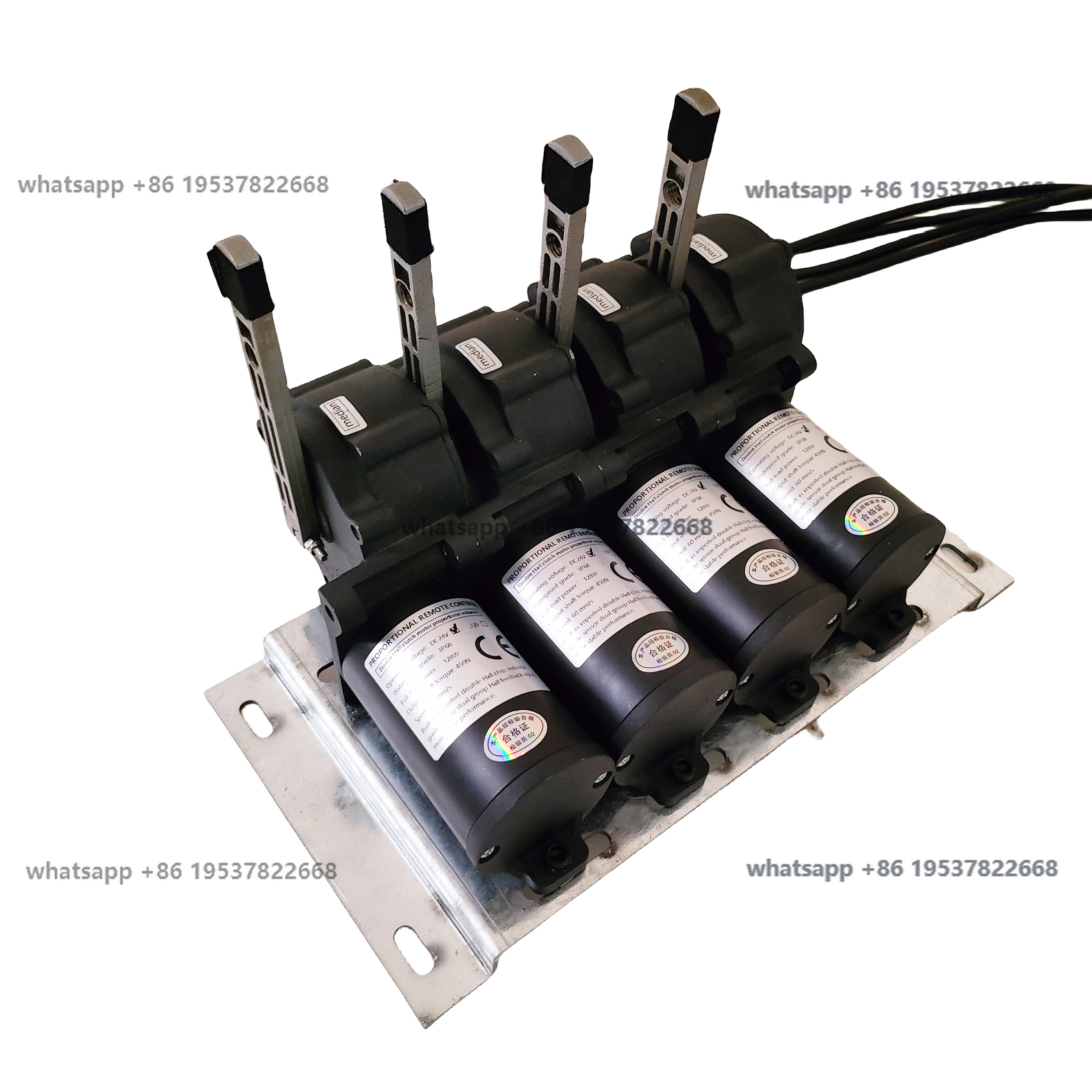

I have often wondered how Ag Open would work on my bale wrapper. It is very difficult to get a straight line. I am hoping to try one of these on the hydraulic control valves either in the cab or out side pulling and pushing the hydraulic spool. I hope to be able to automate certain very representative tasks like opening and closing the baler for 10hrs straight
