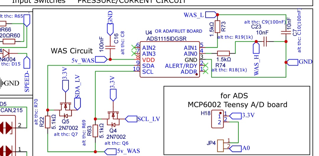

It can be a thermical issue, bad connection, bad solder joint. Some people wrote about soldering issues at pcb ampseal connector. The voltage regulator for the WAS on the pcb, does it provide stable 5V. You try can measure WAS-Signal direct on the pcb. (header, where the additional ADS will be placed.)

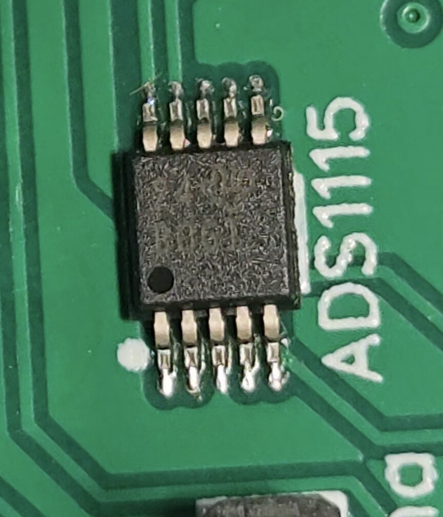

Opened box but cant see anything wierd. Maybe this solder joint?
You’re right, soldering appears really bad qualitiy. Above IC pins SCL, SDA, VDD!!!, … are looking absolut badly. The bad solder joint of VDD can be the reason of your problems.
Check with a magnifying glass at the joints as i had a bad soldier joint on the underside of the pcb by jlcpcb, the tiniest blod was shorting between 2 pins

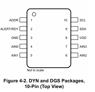

Ads1115 is bad for sure now sensor send 2.5v but reading WAS is 0 then -65 then +7. What i can do? Solder new one? Must be same or? Programing? Anyone have micro 4.1 for sell or 4.5 if its same

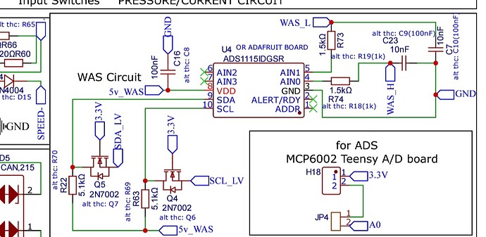

You can remove the SMD one and use the ADS1115 breakout board which can plug into the header nearby the SMD chip.
When ordering this ADS1115 breakout board be informed that there are two different pin variants availiable.

Before you remove the ads1115, then just try to solder the missing connections, no harm can be done, if it doesn’t work then remove the smd ads1115.
