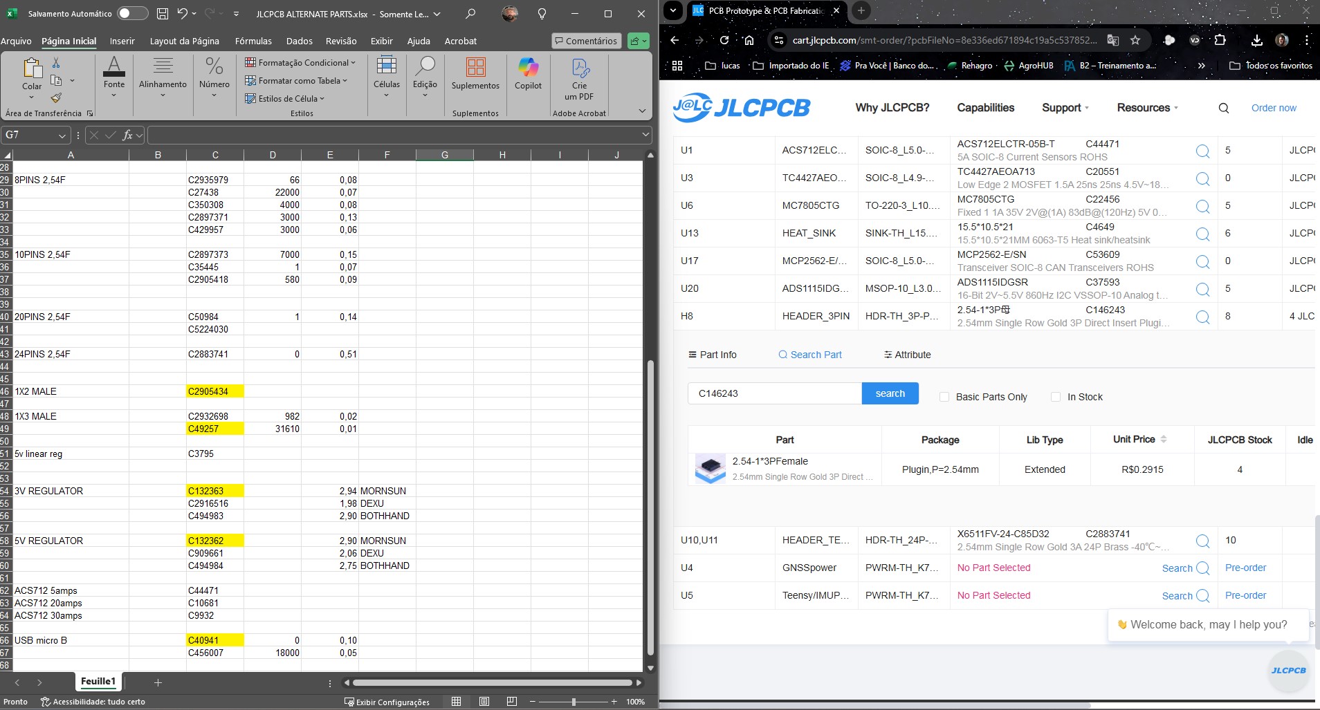

I went to order the PCB All In One, and what happened? Some components are missing, as you can see in the screenshot. But I checked the list of alternatives, and there are none. So now what? What should I do?
I guess, mounting holes are designed for cytron, but pcbv2 works also fine with ibt2. You can connect your bno with jumper wires to pcbv2 as I did.
