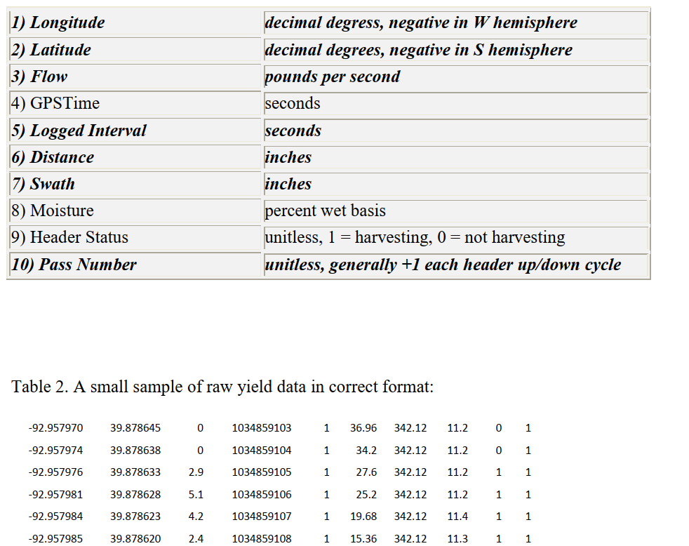

depending what you want to do with the data. I use the free yield editor software from USDA to clean the data.
I still don’t know which software I will use to visualize the maps once my free trial of SMS software from Ag leader will expire.
Here is the format I use, agleader advanced from what I know:
The manual: yield_editor_manual v2.pdf (799,7 Ko)
An exemple: m1m2_2025_v1_agleader_advanced.txt (605,3 Ko)
