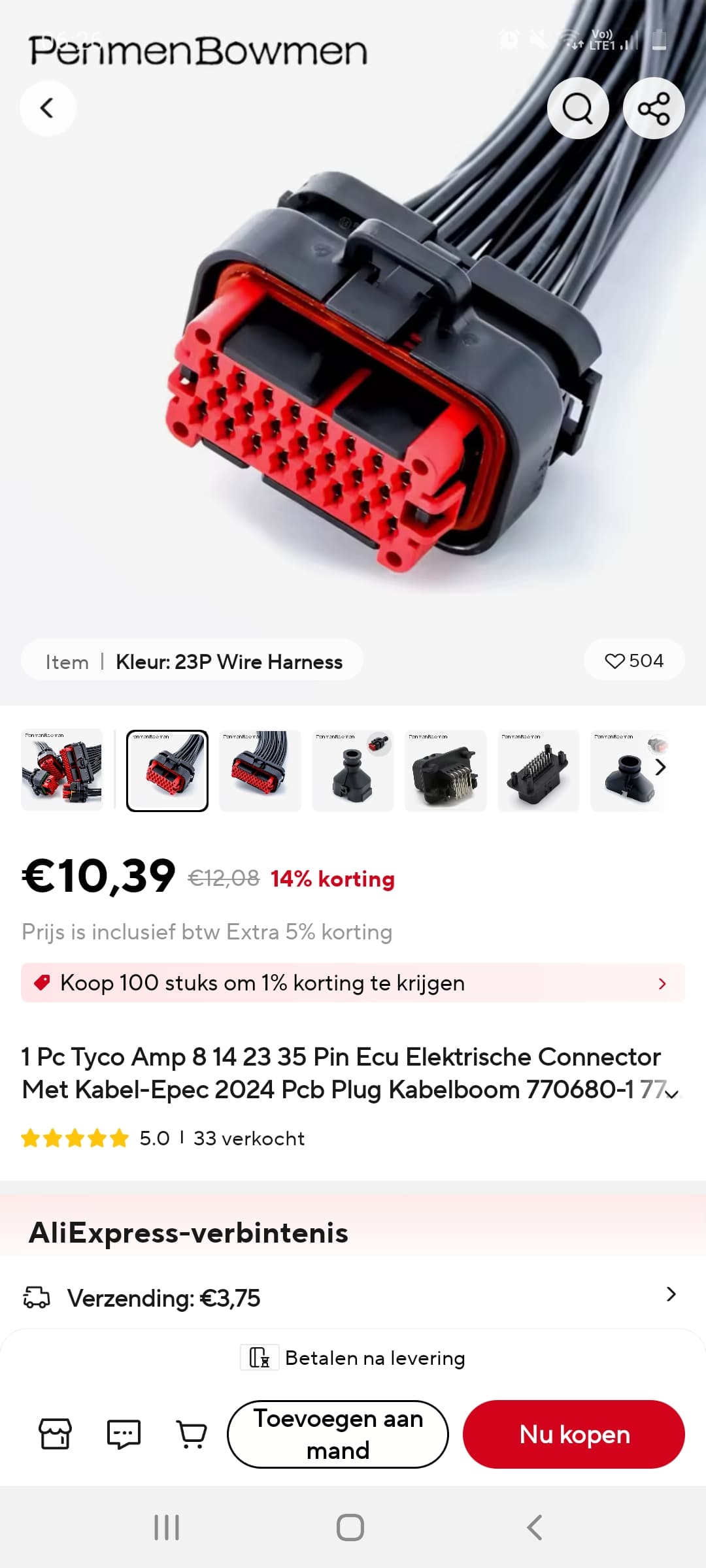

You mean this?
These are the links from the wiki. Can confirm these definitely fit as I’ve brought them myself
The pins to order are: 770520-1
You can get upto 1,5mm cable into these (16awg in American).
You need an amp pin not a deutsch pin!
Thanks, I’ll get them ordered up. Exactly what I needed, just the pins.
I think that’s definitely went wrong, I wasn’t even looking for the correct style pins.
