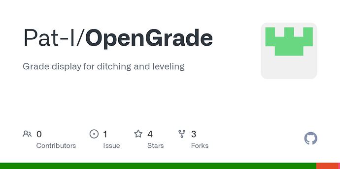

You can try OpenGrade
A video from an older version from @BrianTee_Admin
I have added a lot of feature here:
To begin you just plug the F9P via USB.
You later can build a module to control a valve.
If you want to re-use your surveys then do only ONE survey per field. (Do multiple fields)
It build files to export, like .kml for google earth.
