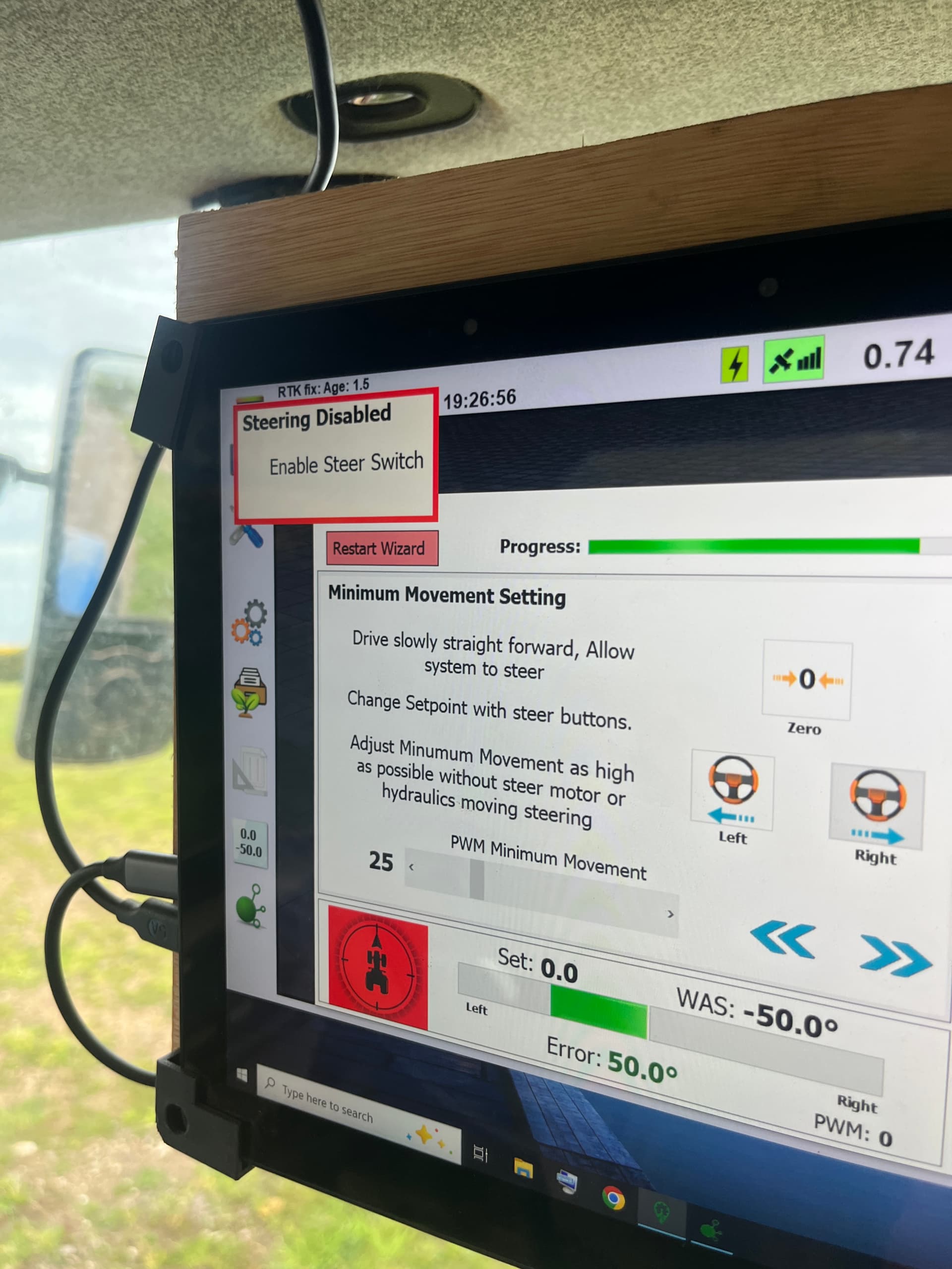

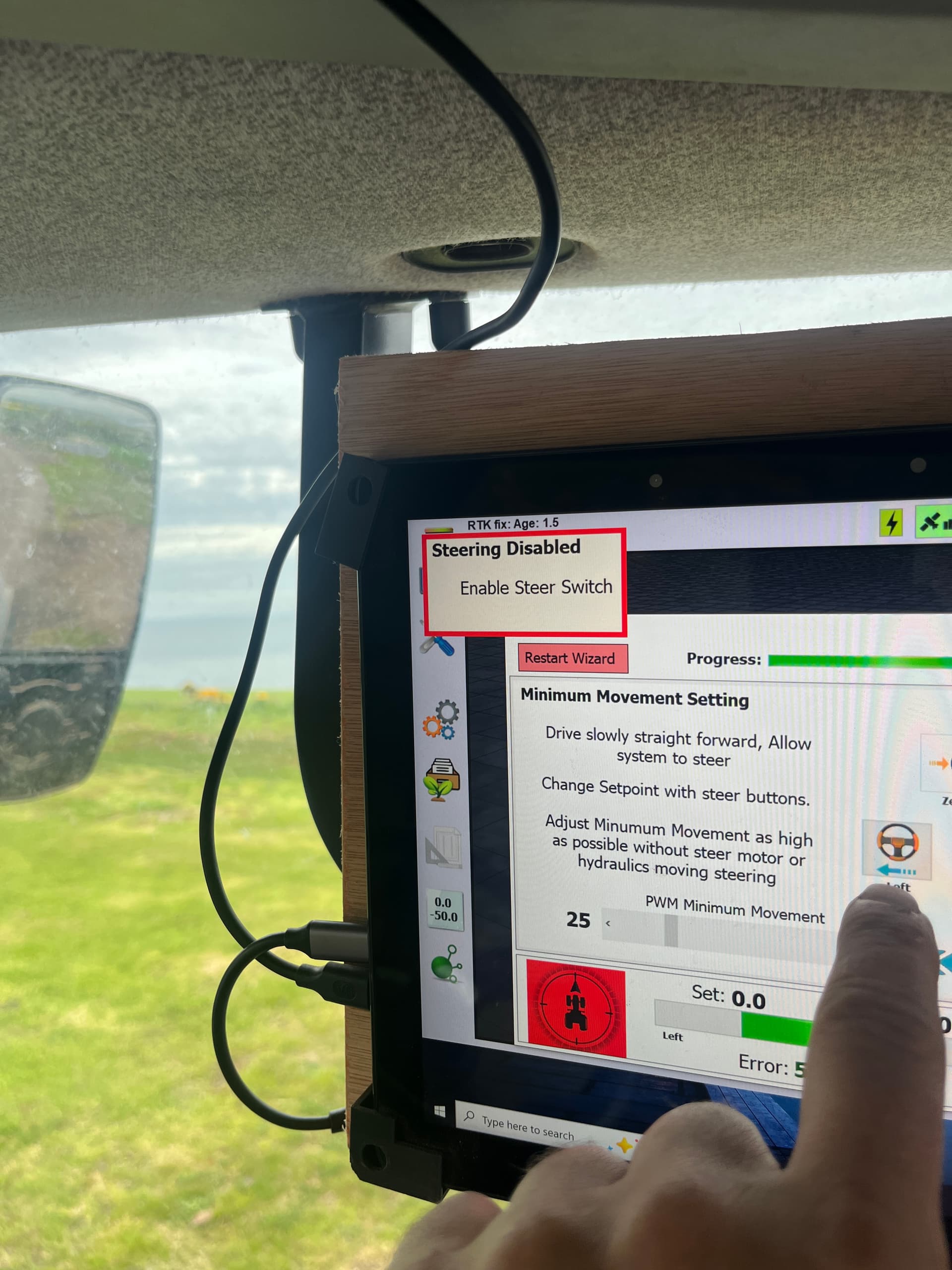

Hoping someone can give some guidance as to where i am going wrong with my dilemma of getting Autosteer to work.

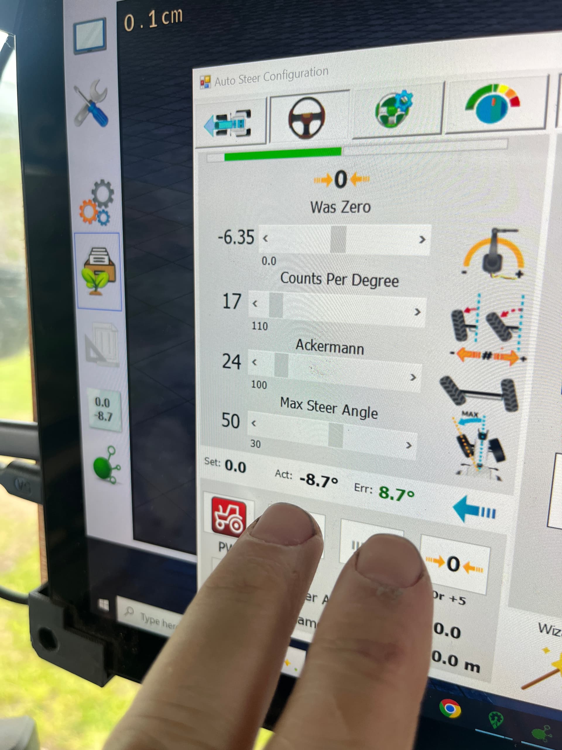

All in 1 4.5 board running through Canbus on autocommand T7 NH that has previously had autosteer fitted. GPS working, Green Autosteer icon showing on Intelliview screen. WAS indicates movement correctly however ACT and Error values seem to change at the same rate. Using steering wizard and set up to the Minimium Movement Setting and engaging Autosteer the response is that i have not Enabled Autosteer (Which i have with Green Icon showing). Also cannot seem to change Counts Per Degree (CPD) to get Act to 30 (Stays around 2-7)
UPDATE: problem solved. CAN L wire had worked loose causing multiple issues. Had fitted with temp pins to the Ampseal colour coding with shrink wrap and could not tell it had worked off the pin
