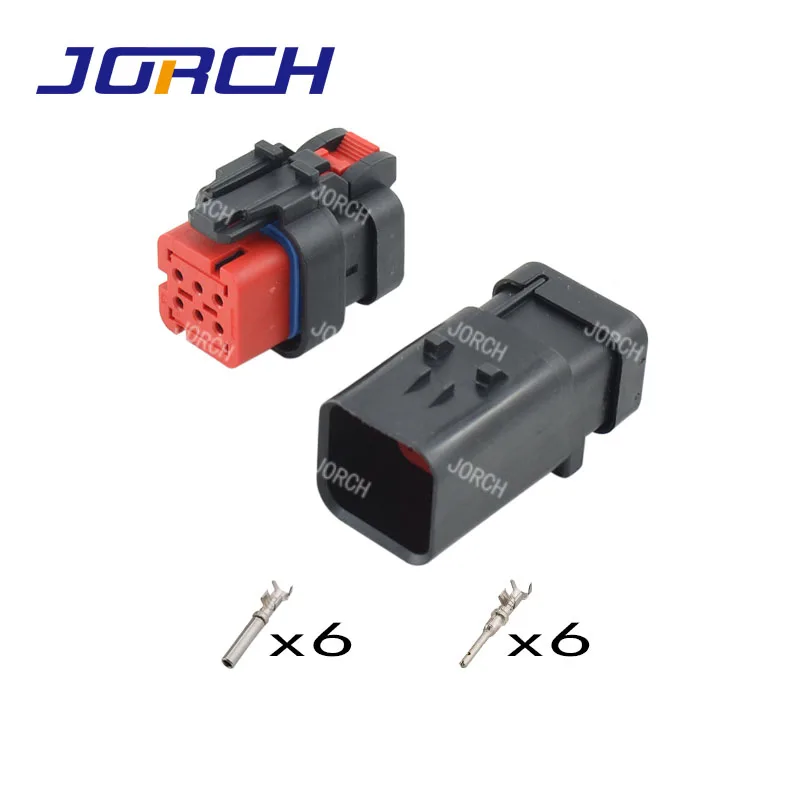

Is that 6 pin connector for the steering valve? It appears to me that 4 pin connectors are needed for the WAS (X637) & encoder (X837)
