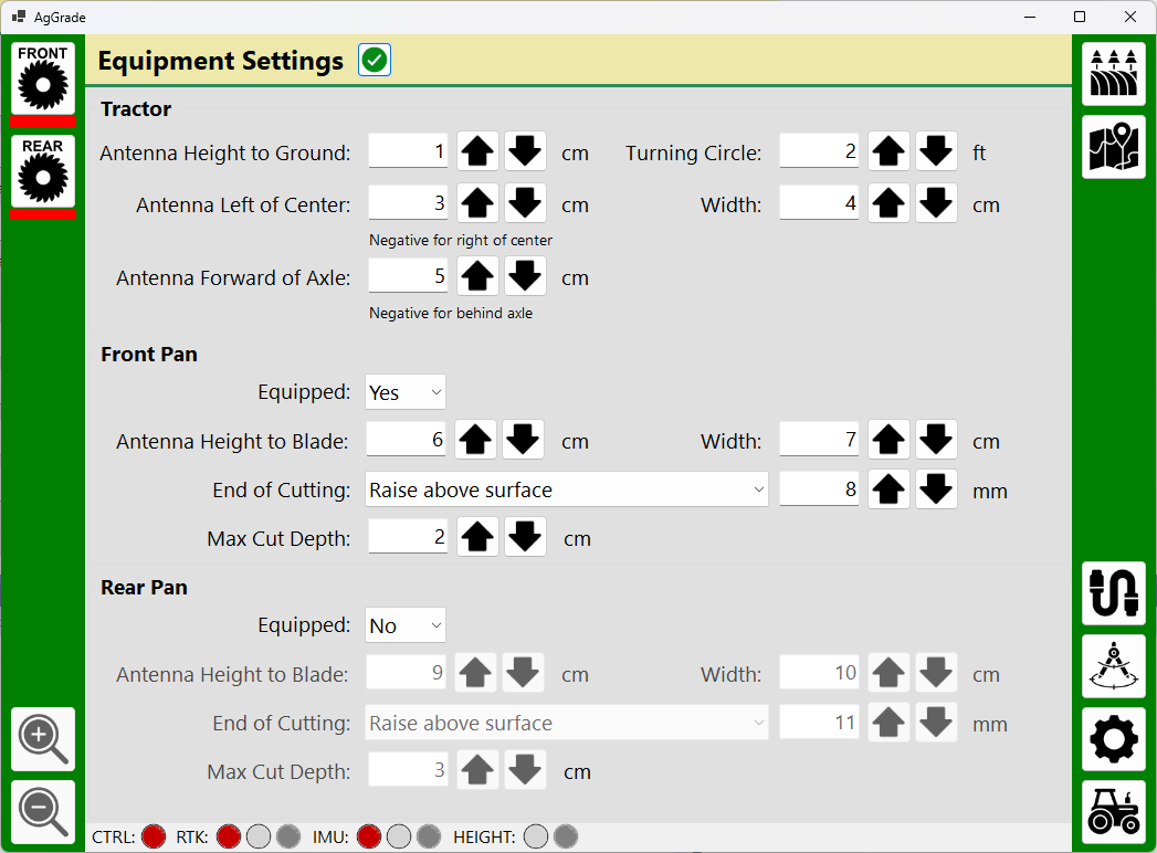

Equipment settings so far. Andy
I think it would be better to use mm for all metric dimensions?
AGO use cm but most systems use mm? 95% of time cm would be enough, especially for grading but if you have something special like 30 inches row, that’s 76.2cm
Split the settings into multiple pages and changed to mm. Andy

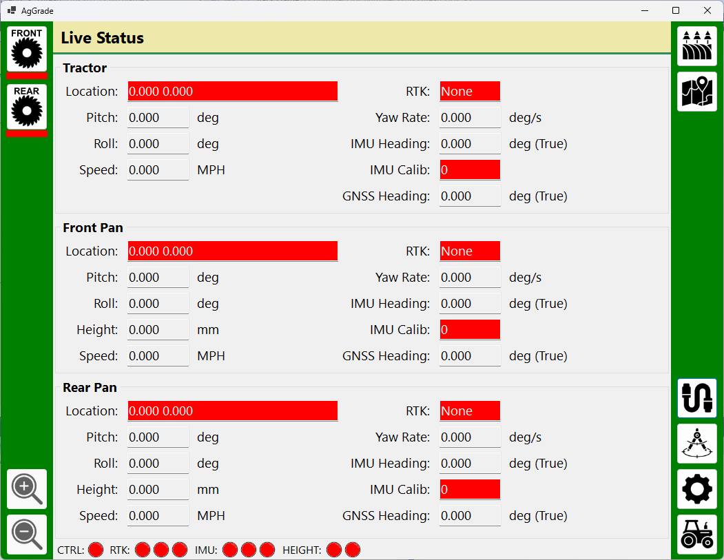

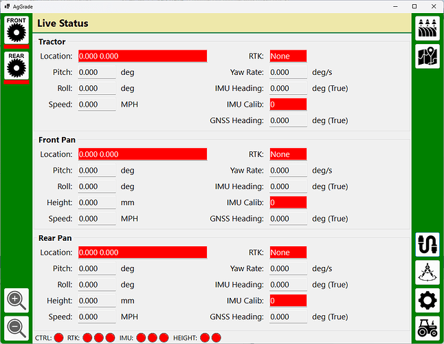

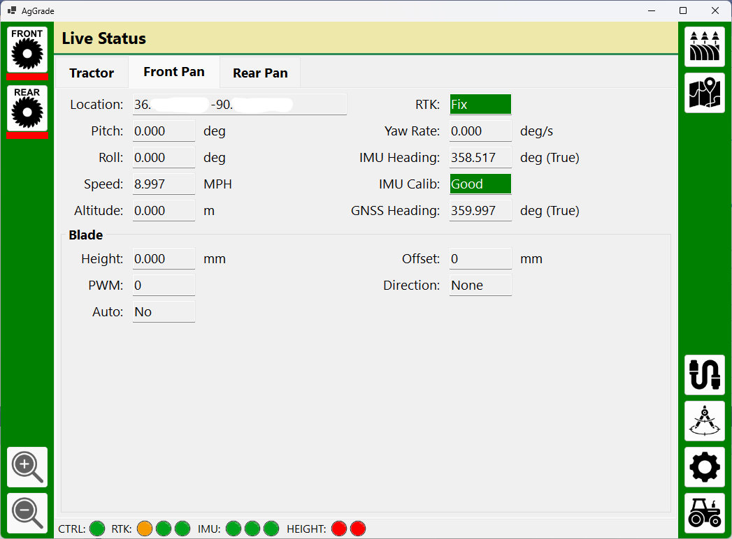

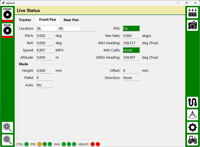

Live status screen. Andy
Status display got a bit out of hand so I split it up into pages. Andy

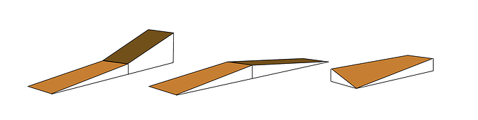

Sometimes it’s convenient to enter your grade plane as two slopes, North-South and East-West. For example, 0.1% North & 0.1% East instead of 0.14% at 45deg.
Yes dual slope would be very useful. Sort of simple 3D in a way.
Ah! OK. Yes, then don’t need expensive software like Optisurface. Got it. Should be easy to do. Yes I will include that. Andy
I presume when entering a slope like that the earthworks will be calculated so they are balanced. Optisurface uses a ratio of 1.2. Does that always work or need to be customizable?

If you can code it. Would not be so easy as the user would have to enter the area where he want that slope and if he want to import/export dirt from the zone.
Just the slope and being height adjustable quickly and easily is a nice beginning.
Three points and choose the slope between each point (% or cm) for two slope feature
