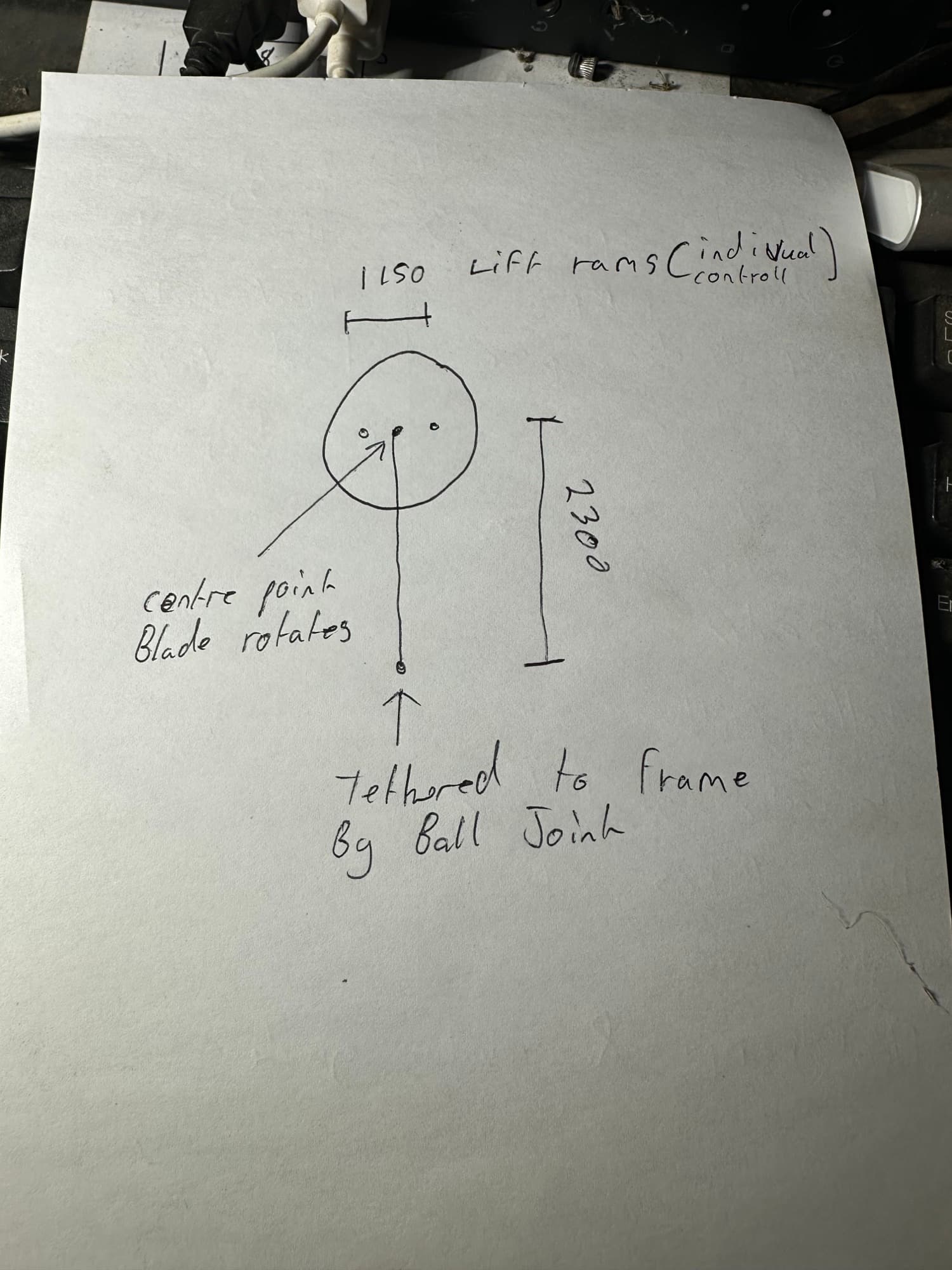

I am wondering if I can create a mock-up of a grader blade using wood and DC motors. I need to research the linkages used because I have never seen a grader up close. Let me know when you are able to help with this aspect of AgGrade.

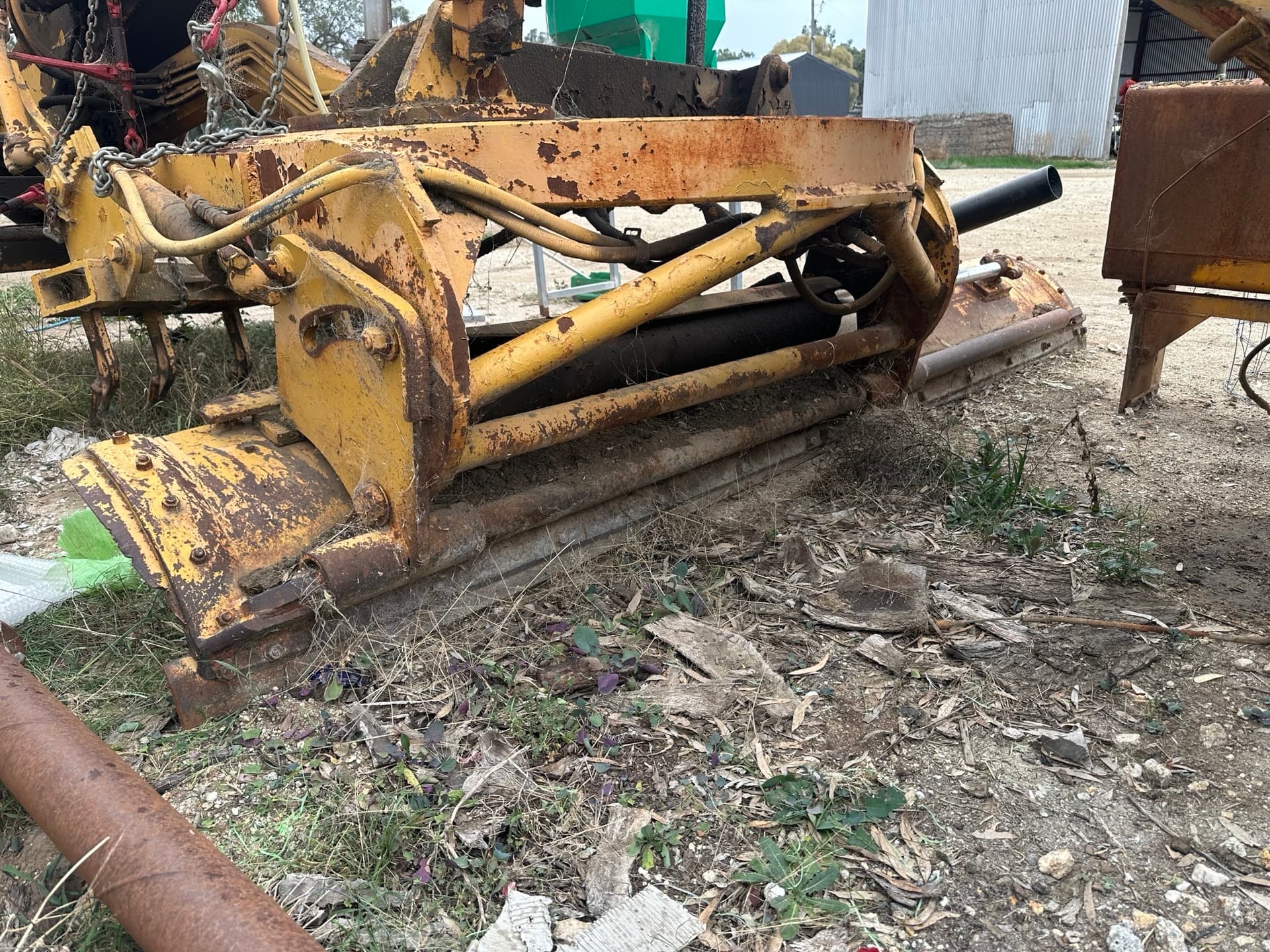

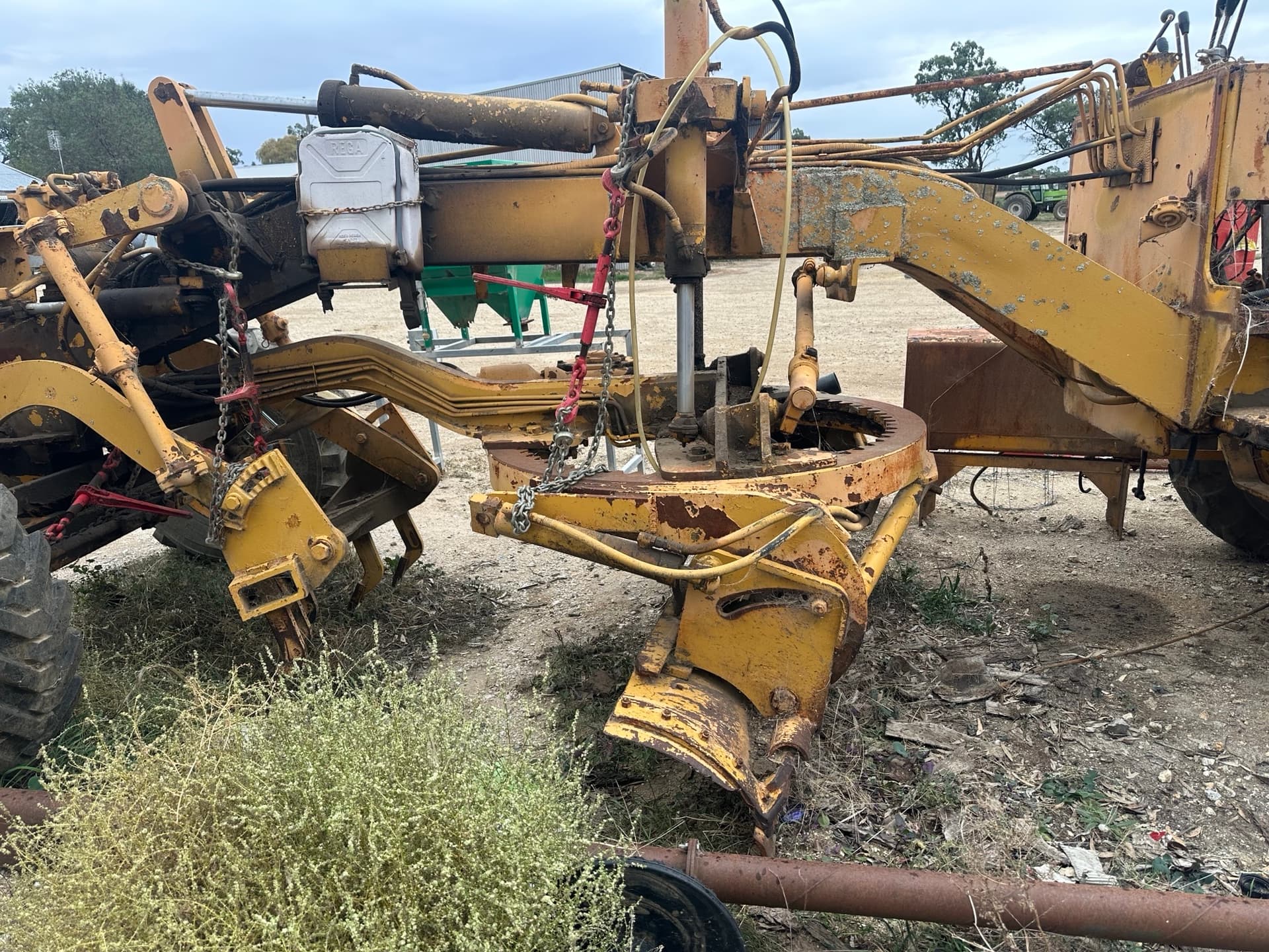

The blade width is 3650mm
The blade can side shift (slide from side to side along its length)
At the moment, I can’t make a video of it moving (See photo below), but if you want a video of me explaining the movements, I can. I am currently busy preparing and fixing equipment for the sowing season. So the hydrostatic upgrade has to wait.

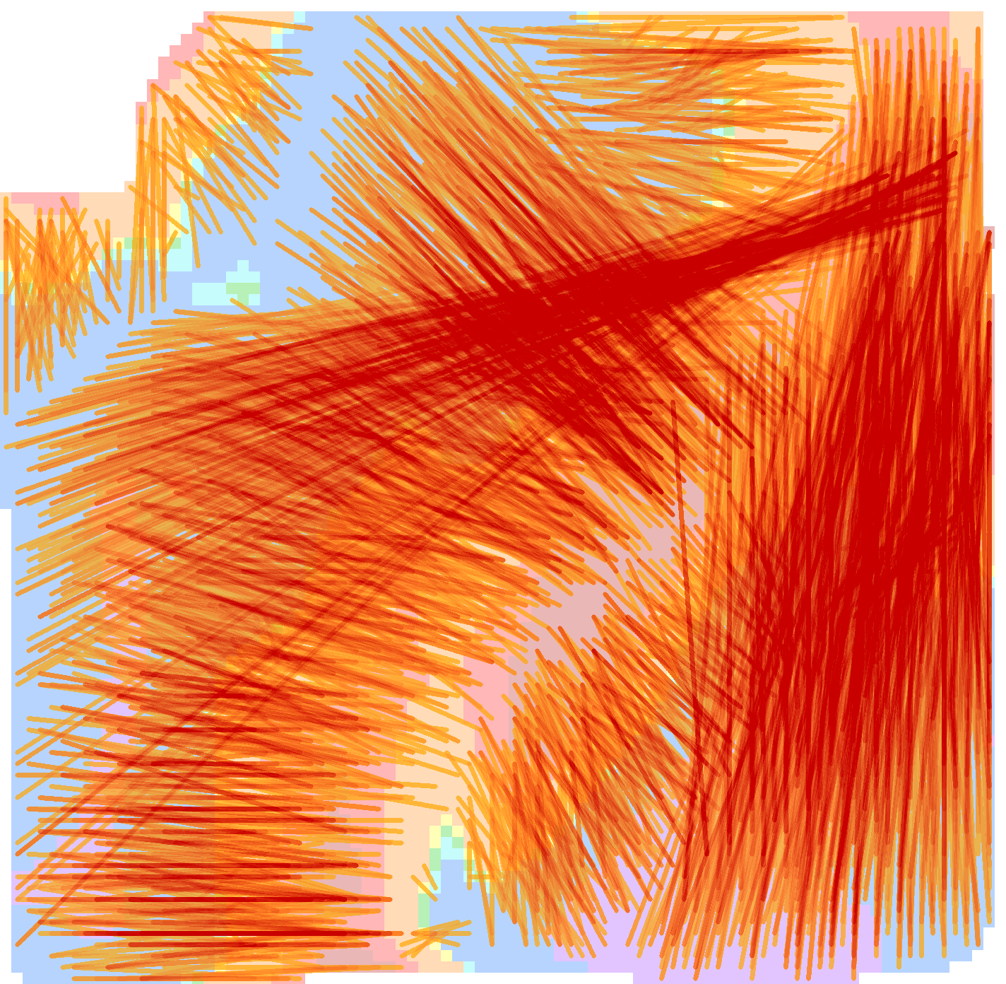

For my test field with 46,000 cu yds:
OptiSurface = 199.5h (suspect no turns or compaction)
Mine = 205.0h (with turns and compaction)
I am now toying with the idea of creating am open source Windows/macOS application called “AgGrade Designer” that allows a user to load in survey data, create a planar design, then visualize and evaluate various haul options, with ponding analysis and a complete GPS guidance export.
Any thoughts on this would be welcome!
Image of a calculated cut and fill pair with GPS guidance (yellow dots):
I’m not too sure how hard it would be, but an idea I had was to have a height-basted layer map with the hall paths numbered, and when you do a cut that matches a cut path, it counts as done and disappears off the GPS screen
