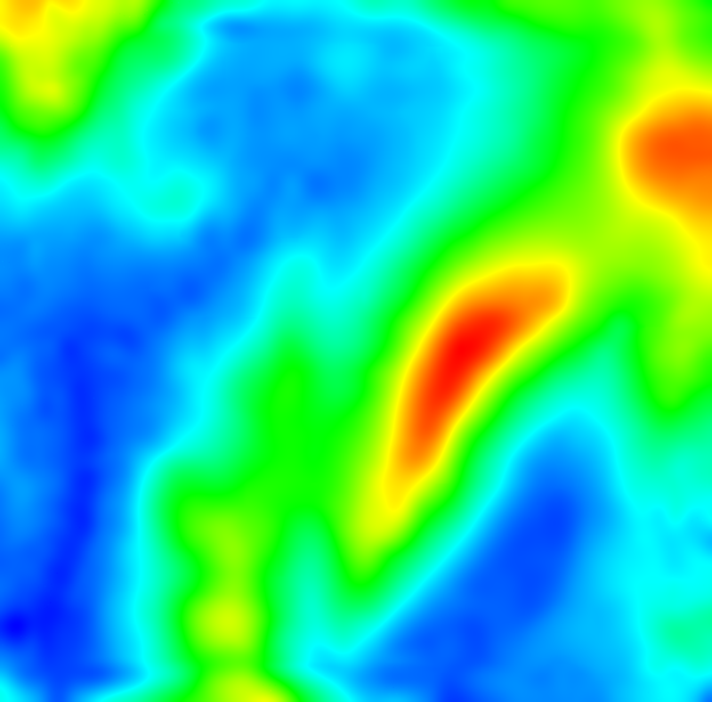

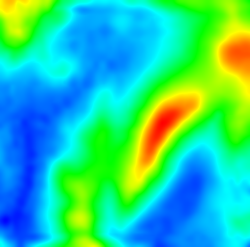

I am looking to eliminate completely the dependence on OptiSurface ($1000 software) by working out a hauling algorithm. For that I need lots of datasets. If anyone is willing to help with this by sending me their raw survey data then I would greatly appreciate it! The more data I can get the better the chance I have of solving this part of the puzzle!
I have five fields of my own. If I can get another 15 fields then I think that would really get me started on this.
Thanks!
Just to clarify my last post - I will add surveying and plane generation to AgGrade, so OptiSurface won’t be needed to use it. But what I currently can’t add is the haul path calculations. These are not required to move soil but take out a lot of the guesswork of which direction to move it in.
Even if you have OptiSurface, getting the haul arrows out of the software is a massive pain because it requires zooming in, exporting a georeferenced image, zoom out, move over, zoom in, again and again, then manually removing the legend in an image editing program. I don’t think they ever intended for them to be exported, which is weird.

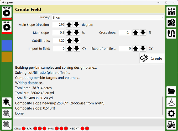

Field creation from a survey implemented. I copied the options from Optisurface so I presume this covers all common use cases? Andy

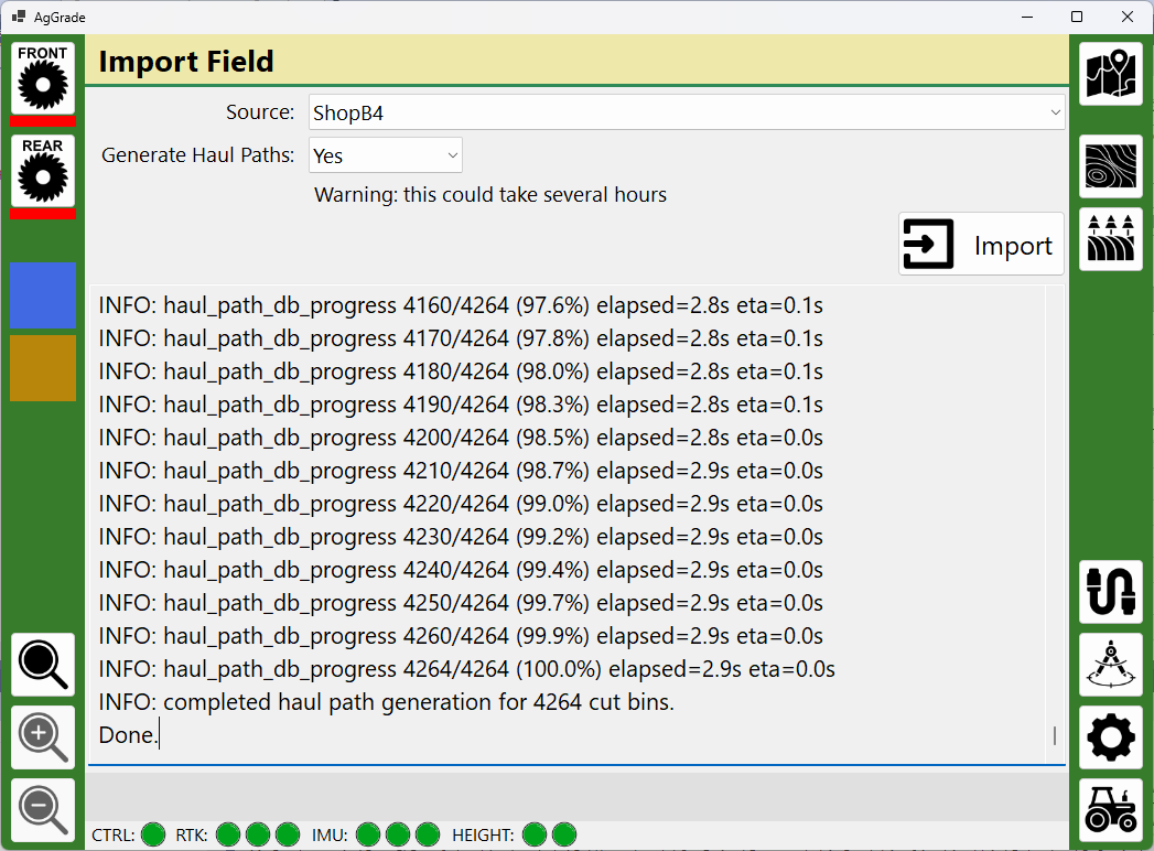

Added import of AGD files (i.e. from Optisurface). This takes the AGD file and any optional geo-referenced haul arrow images and generates the AgGrade field. Andy

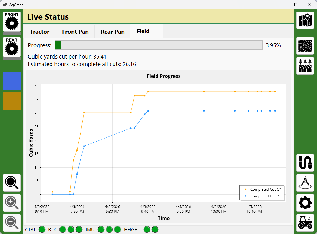

Added field progress page. Andy

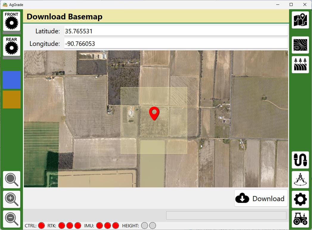

Added downloading of satellite basemap for offline use when surveying. Andy

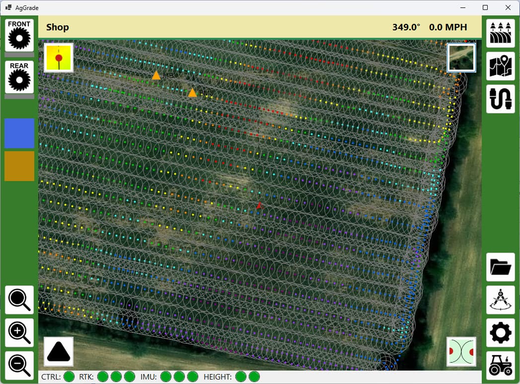

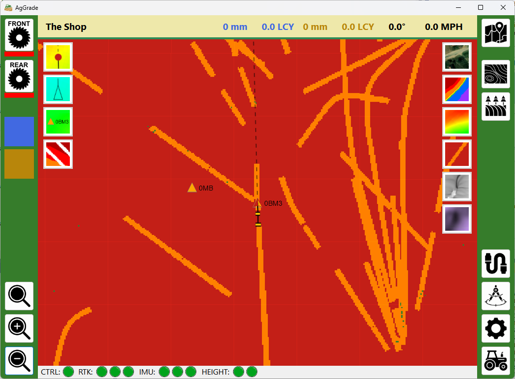

Added a new map style - “completion”. This screenshot isn’t a good example but you can see some specks of green. Red = location at original height, orange = location between original and target heights, green = location at target height.
Andy

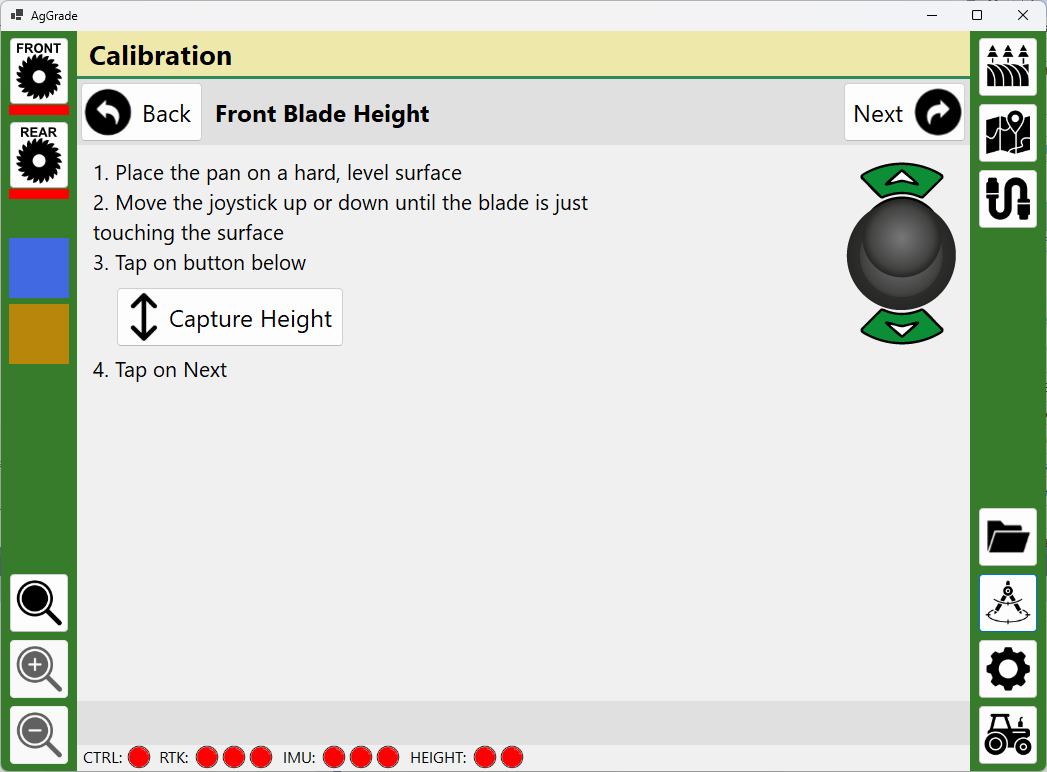

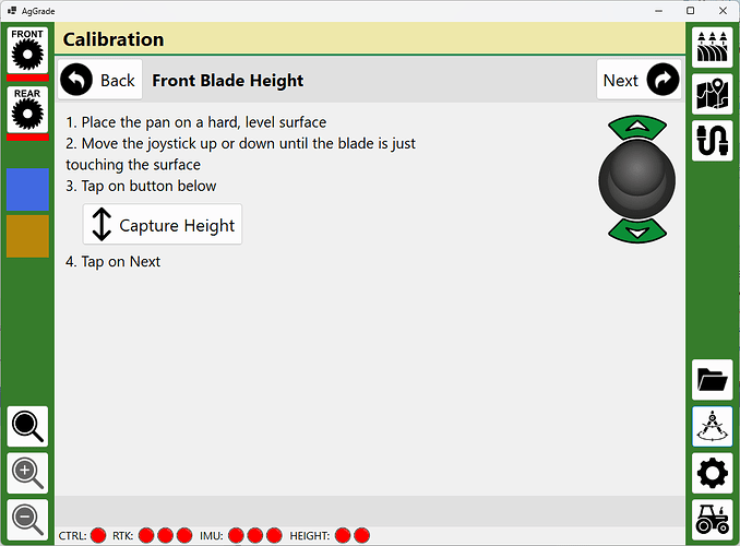

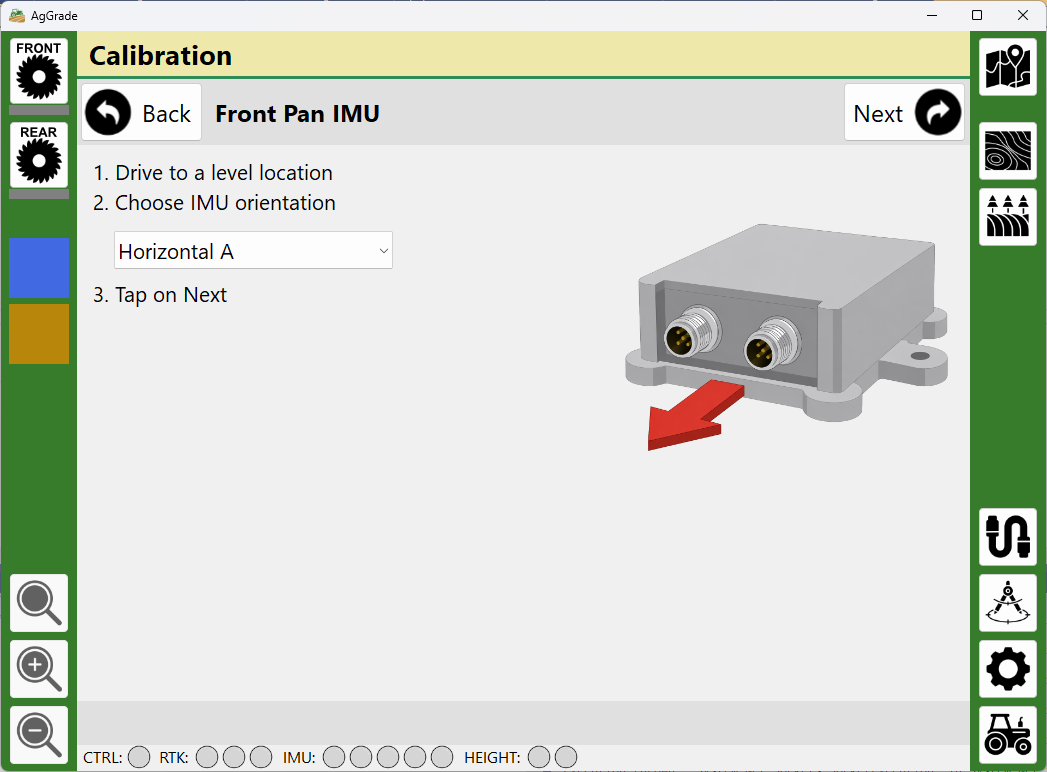

IMU orientation and level calibration added. Andy

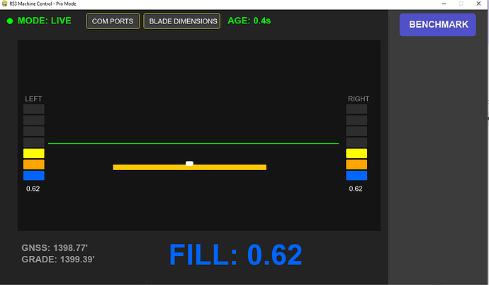

I was thinking about this as I have a road grader and would like to put something on it for grading drains.
My thoughts were to potentially put a IMU or angle sensor on the blade and calculate the angle from that?
Use single GPS antenna for main height and IMU or angle sensor for blade angle

The graders I have seen on construction sites have a GPS/GNSS receiver on arms attached to each end of the blade. I presume there is a good reason for the commercial systems to do that. The two-receiver approach fits better with the current design and intention of AgGrade for two dirt pans.
I could theoretically add support for graders but I don’t have any equipment to test with, so I am not sure how I would do it. I welcome any suggestions.
