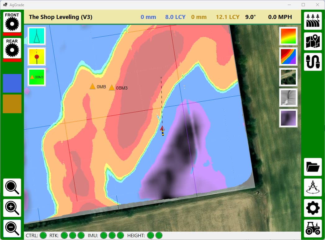

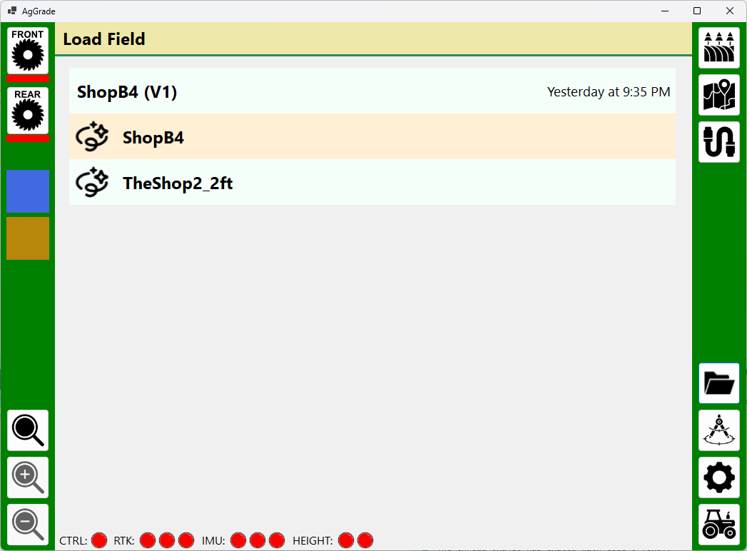

Added UI to manage loading fields. If a field has been loaded for the first time then V1 is created. That can then be subsequently loaded. If the field is loaded as new for a second time then V2 is created and so on. This way no data is ever deleted/overwritten unless the user goes into Windows Explorer. Andy

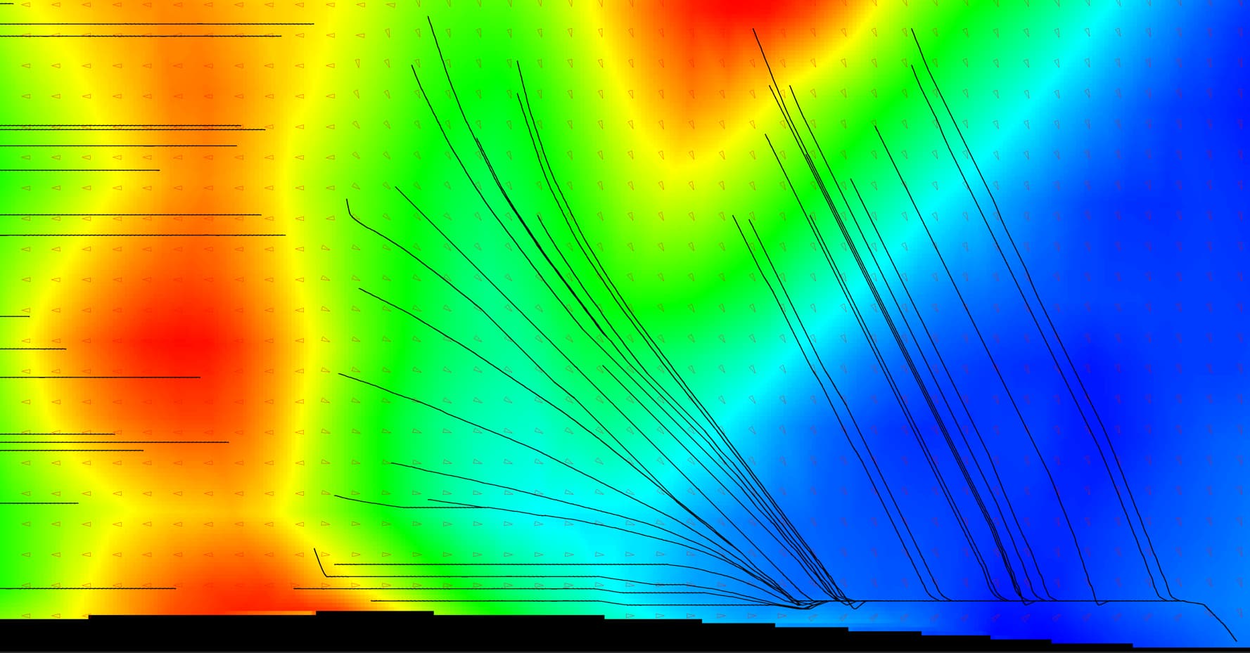

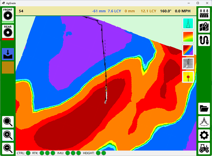

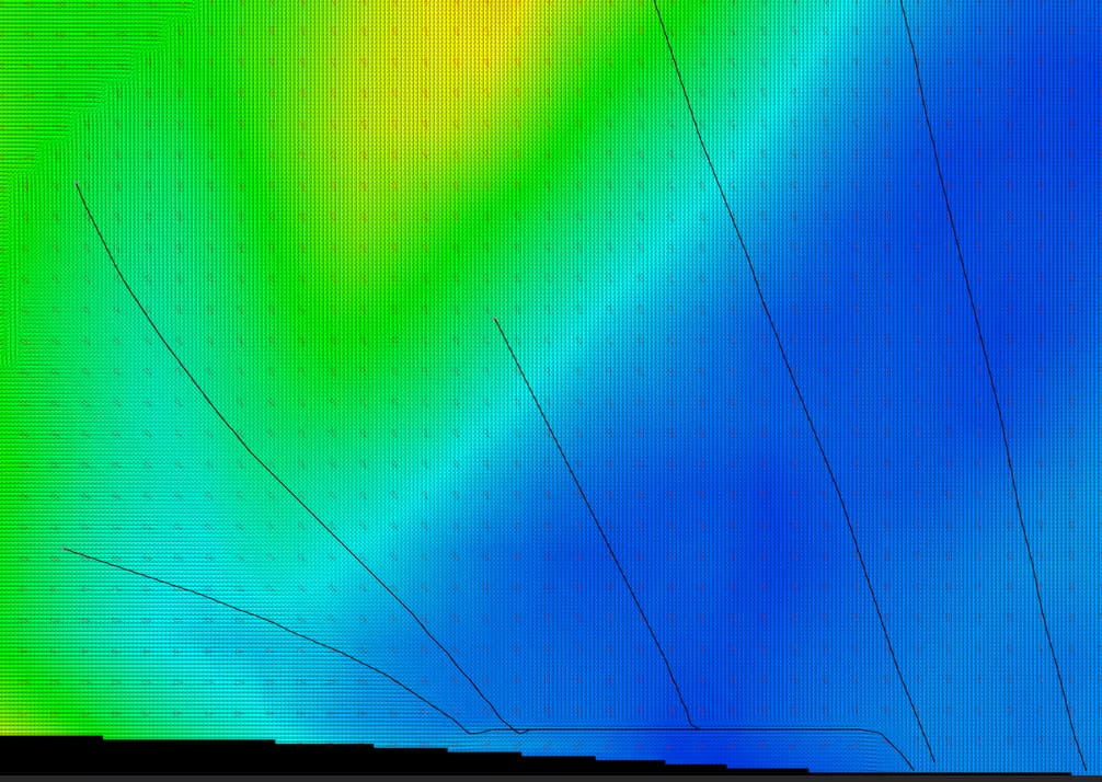

Did some more processing of the haul paths from Optisurface and I can now calculate routes from any cutting spot. Some example routes shown here. Starting to think I could add autosteer now… Andy

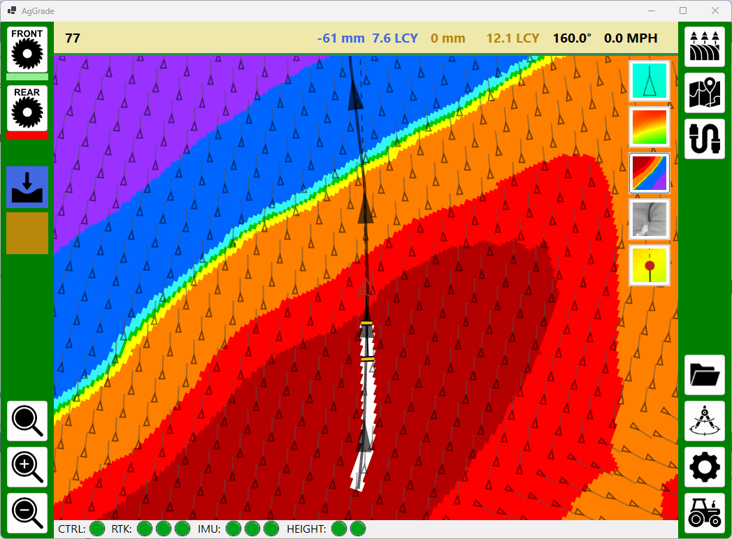

Another example with the OptiSurface haul route arrows and 50 random haul paths. Andy
I now have a python script that can take the AGD file and georeferenced images of the haul arrows from OptiSurface and convert them into a database file. The database file contains all of the height information for a field along with all of the haul routes from every point that needs to be cut. Everything that AgGrade needs so it doesn’t have to do any calculations on the fly.
My test 40ac field creates a 5Gb file and took three hours to generate.
By pre-calculating the haul paths this could now be used for simulation runs of the leveling, if I write some simulation software (likely).
Andy

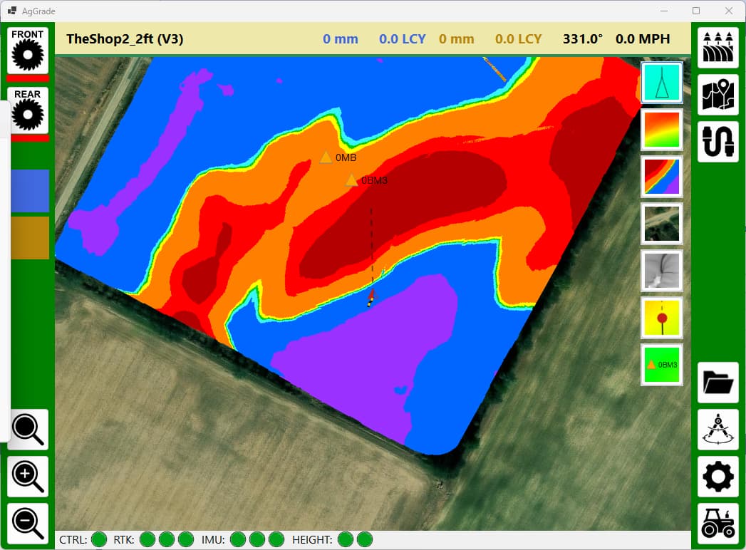

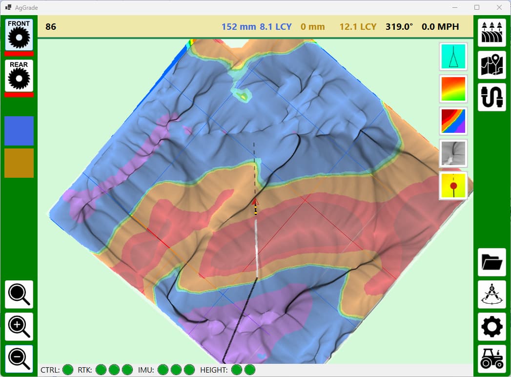

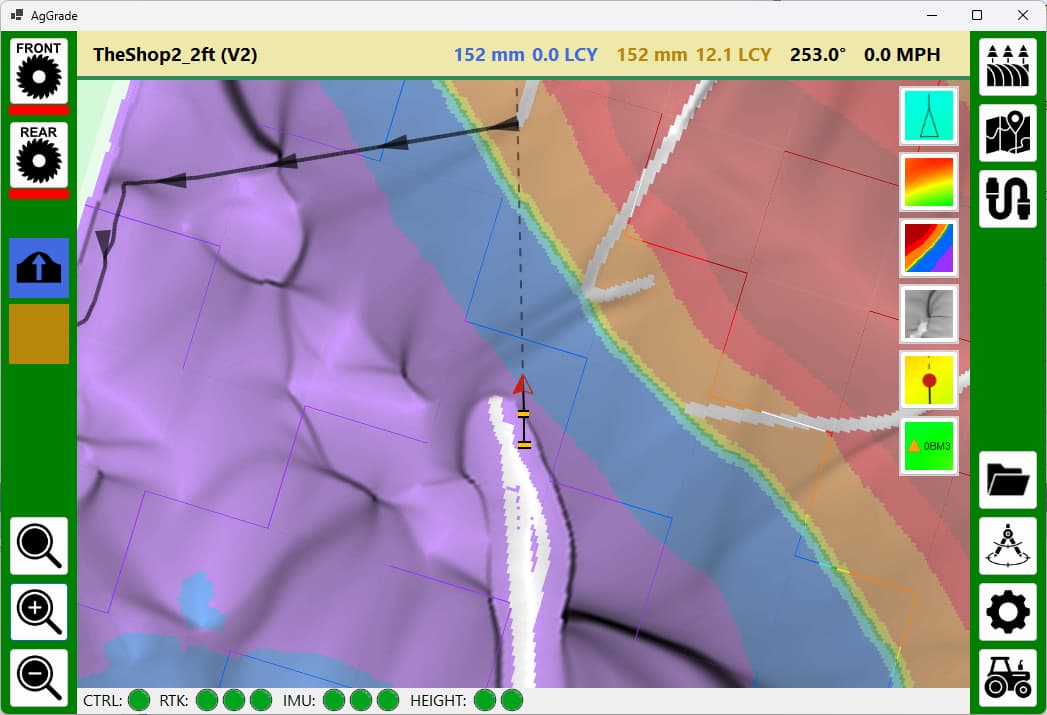

Added on-the-fly calculation and rendering of surface water flow. As the topology changes from cuts and fill this will change to match. Andy

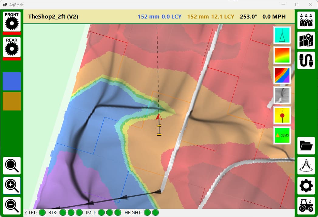

When starting cutting the application now draws the haul path from the current location, extrapolated from the OptiSurface data. Andy
Here are a couple of examples where cuts and fills (in white) have changed the direction of the flow of water (in black). Andy
Added satellite imagery basemap. Andy
Added calculation and rendering of ponding depth. The curve number and the rainfall amount can be configured. Andy

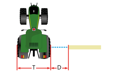

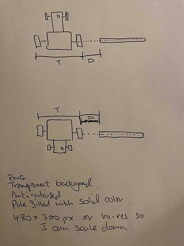

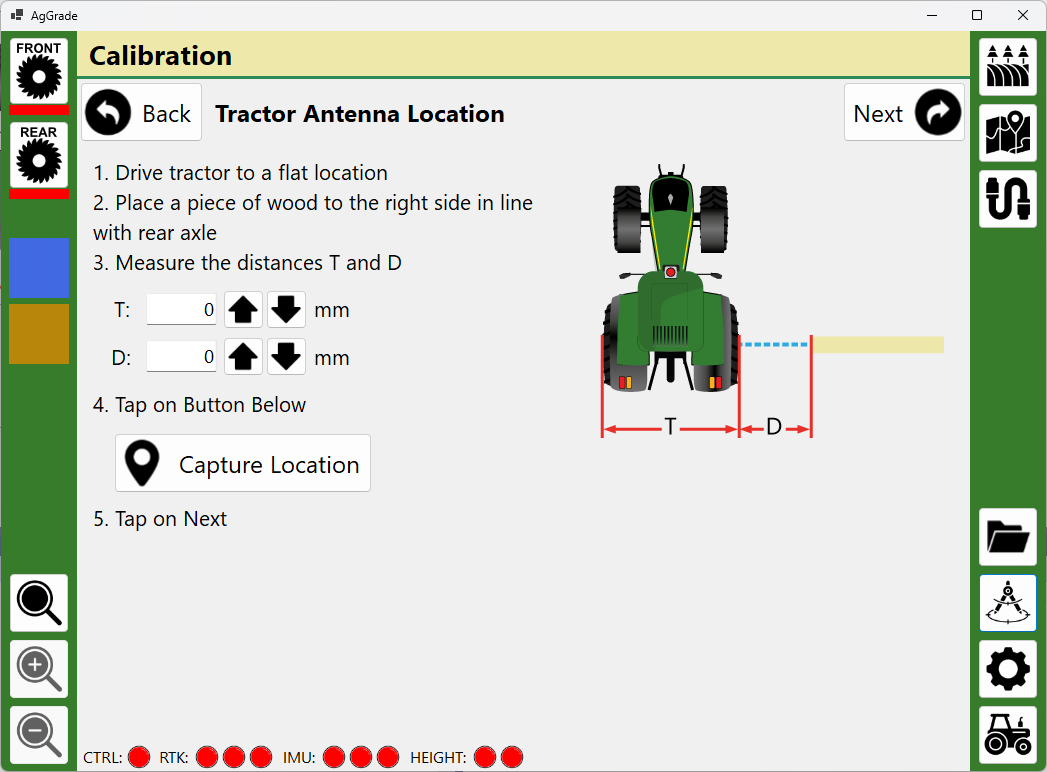

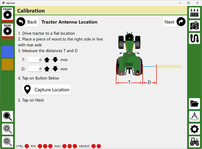

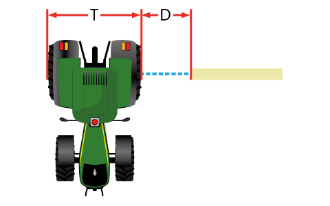

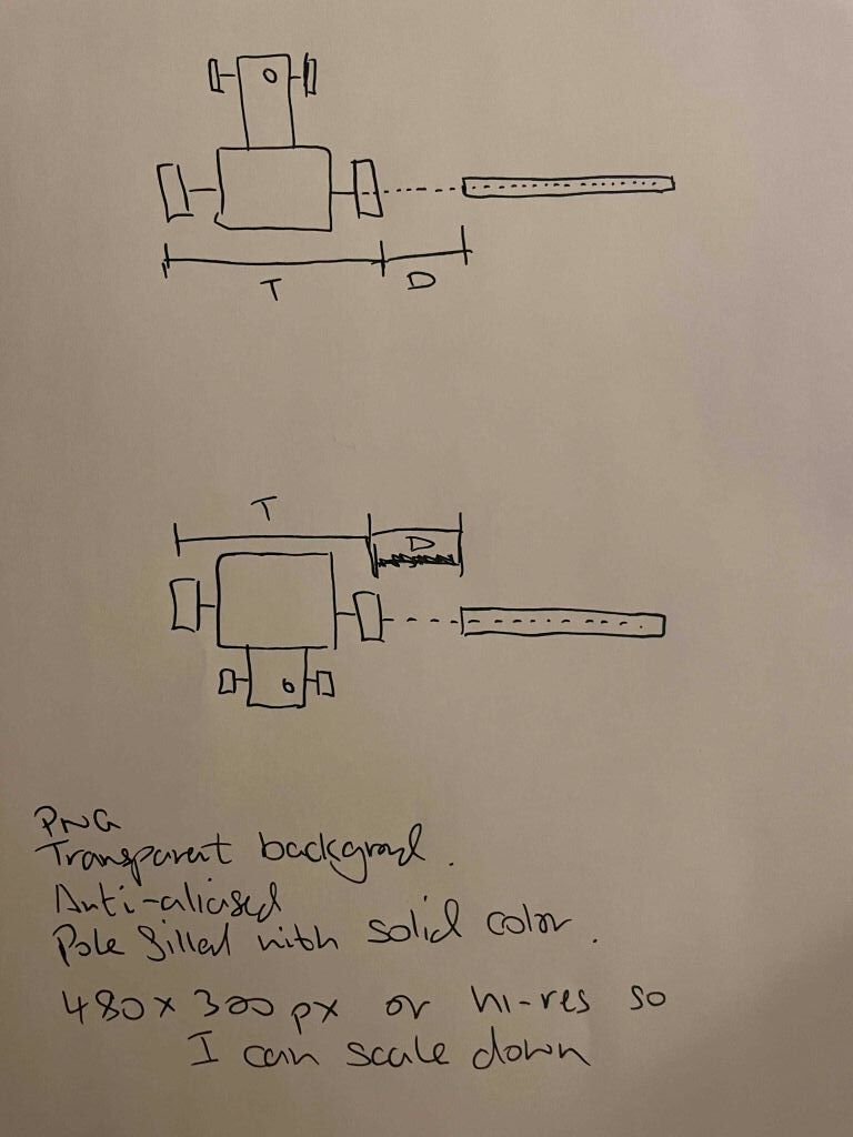

Hi @Vili ! I would like to take you up on your kind offer for some custom graphics. If you are too busy then that is fine, you are not obligated, just let me know one way or the other.
The attached image shows very roughly what I need. Two stylized images of a top down view of a tractor lining up with the same pole but from opposite directions. The tractor has to line up with the same end of the pole, so can’t just be an image rotation. I hope that makes sense. It needs to be clear that the pole lines up with the rear axle. There are two measurements the operator will need to make. I’m sure you can make something much nicer than my crude sketch.
I guess the tractor needs to be Deere green to appeal to the masses :sweat_smile: Please use #367C2B so it matches what I already use for Deere green in the application.
Font for ‘T’ and ‘D’ to match Segoe UI as close as ppssible.
No need for any annotations - I will explain the images using text in the application.
Please color the pole using #EEE8AA to match the application color scheme.
Thank you so much!!
Andy
Roger that!
That looks fing amazing!!! Thank you!! Andy
