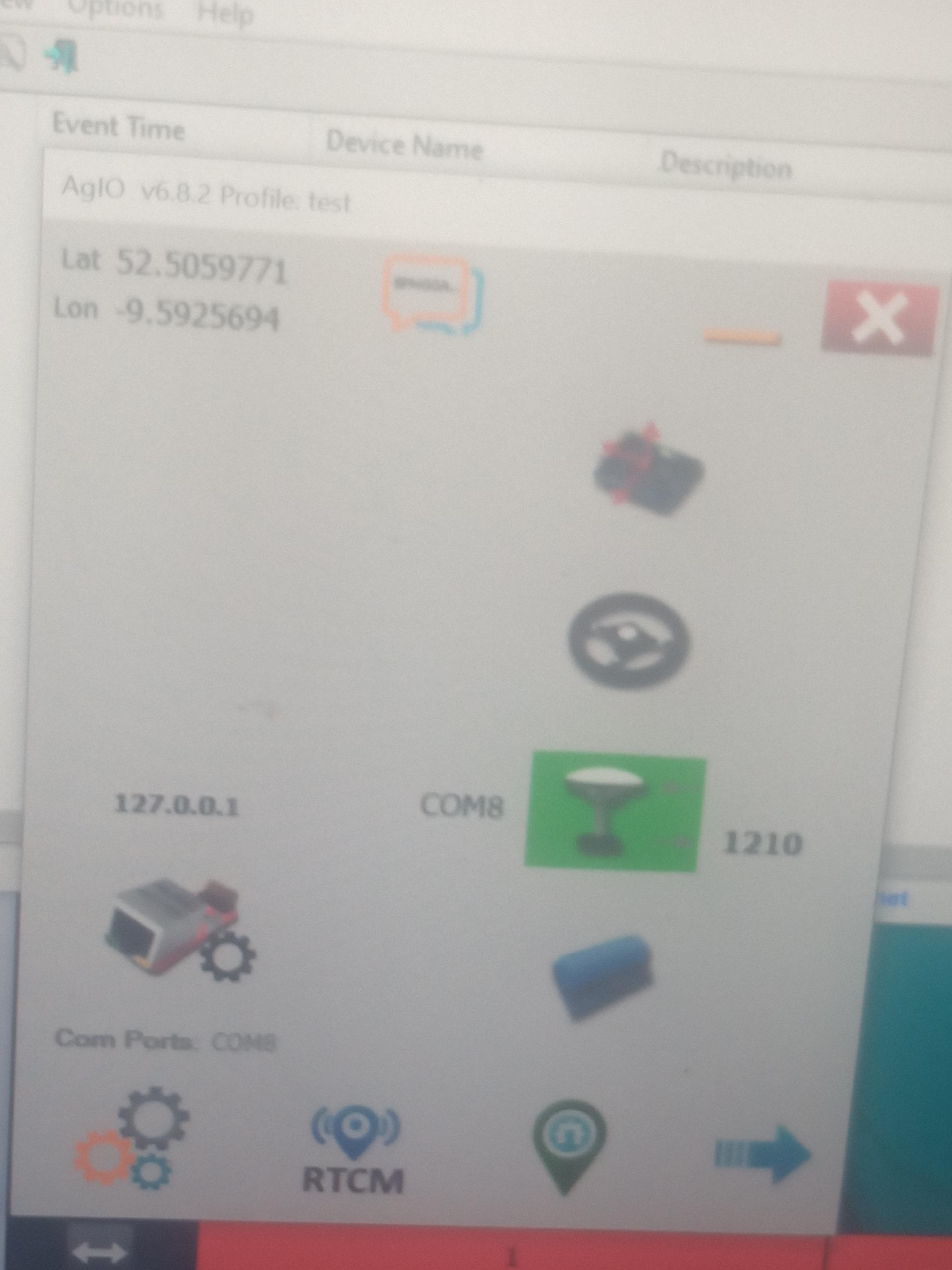

I have issues with USB dropoff with agopengps.
To investigate this I installed this USB port monitor tool.
https://www.nirsoft.net/utils/usb_log_view.html?fbclid=IwY2xjawRSsOZleHRuA2FlbQIxMABicmlkE…
When you plug and unplug a USB port it records it.
I did some testing yesterday.
Observations - When AgOpengps drops its NOT disconnecting in the log tool. When I unplug the cable physically yes the log tool picks it up. Thus I guess I should conclude its not the USB ports are the problem.

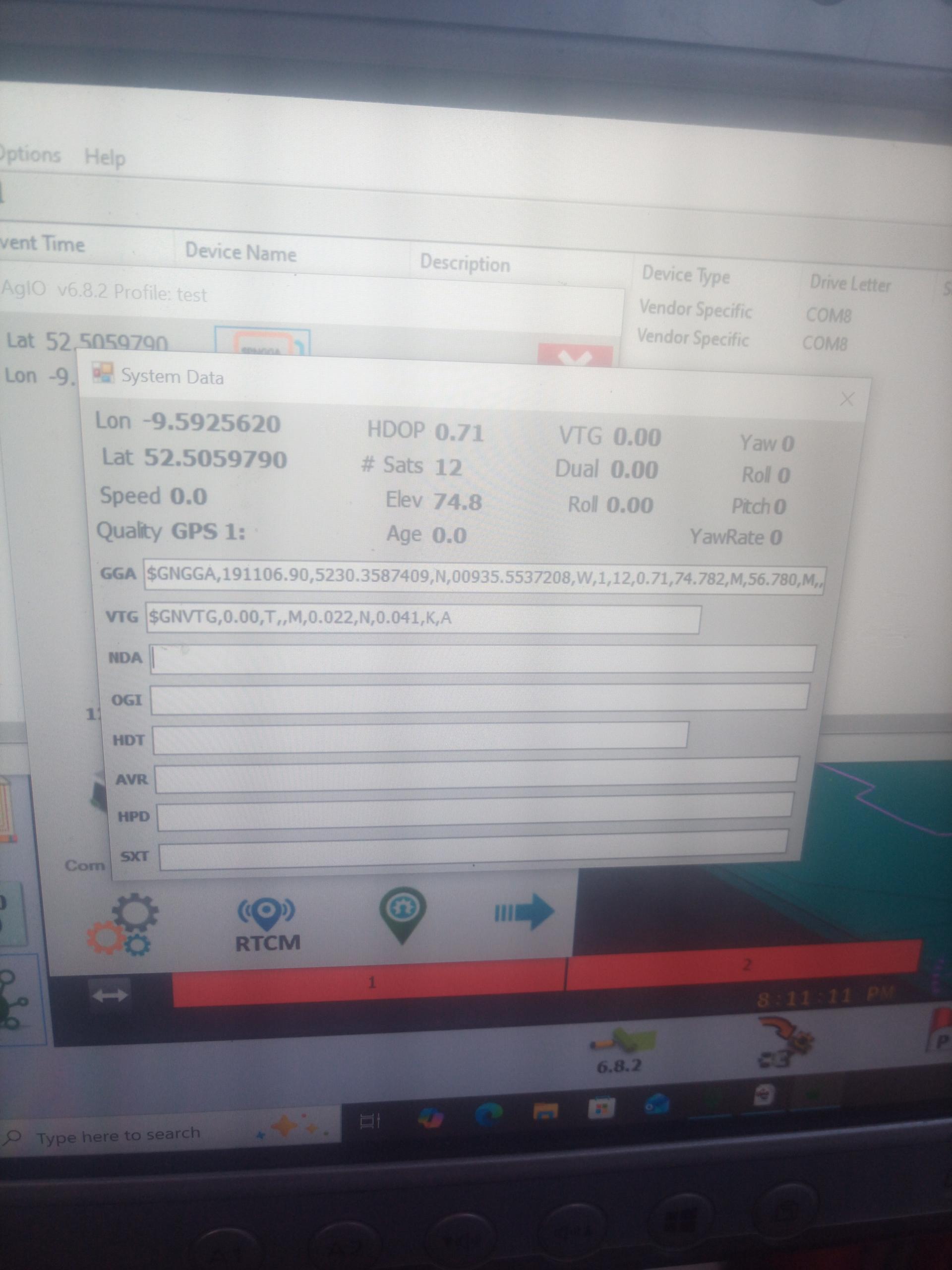

Receiver Data
The data coming from the receiver, which has been setup using the recommended file transmitting at 115200, when setup on a bench runs at either 1230 or 1845. When driving around in tractor it reduces going down to 500 and 600 and the screen gets v slow to update, it’s like it freezes. Sometime after this happening it can jump up to 60 000approx for 1 seconds and drop down again to 12-1800.
