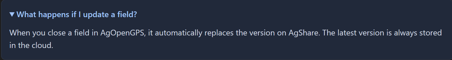

  • Auto upload is already in AgOpenGPs when you close the field or close the application if a field is open
  • create new field from existing is not on the roadmap at the moment
  1. How does it do this with no internet?
  2. What happens if 2 or more users have it open or edited?
  3. Can there be a ‘Master Copy’?
Quite a few operations have people that should/can run the techy equipment, and those who are best where the field they happen to be in automatically opens and picks their correct AB Line.
