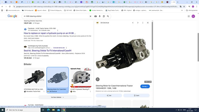

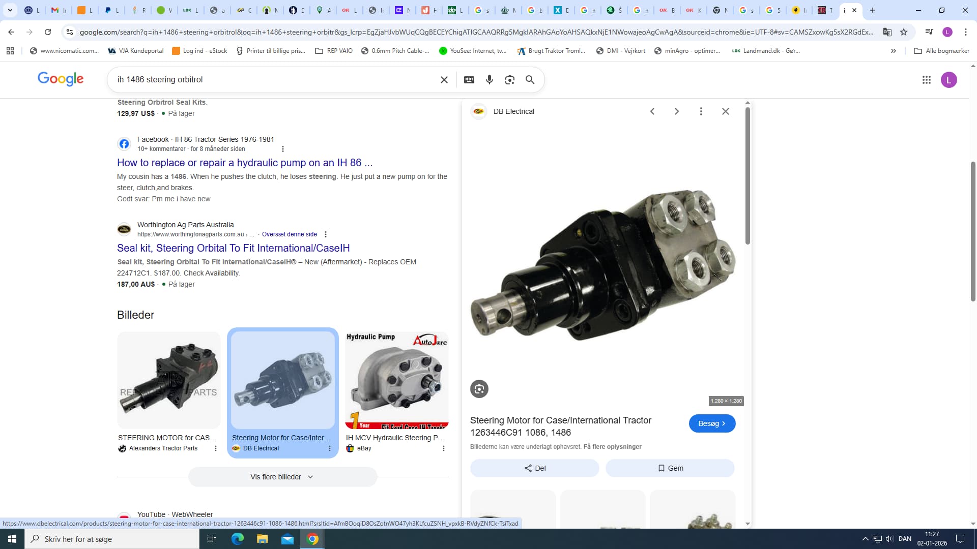

I believe you need to check the orbital motor, Does it have 4 or 5 hoses attached?
4 hoses would suggest it is Open Center Like the one shown in my link.
Steering can still be OC , while the rest is CC

It does have four connections, so open center for steering
it is open center steering
