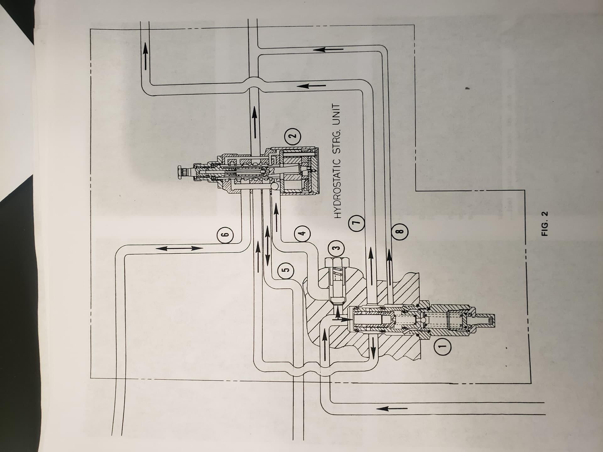

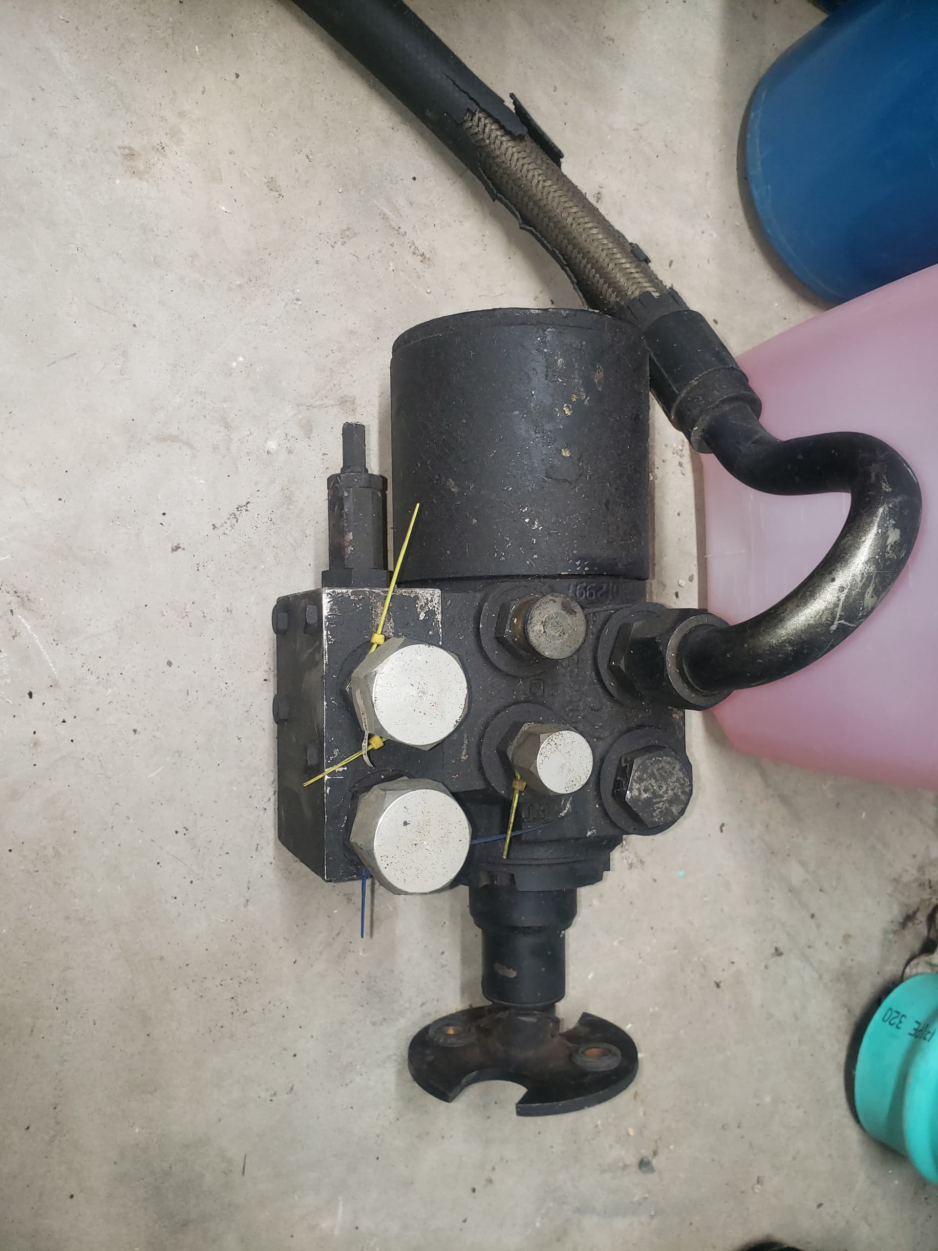

Im wanting to add a Baraki valve to a MF 4840 Tractor. It has a ROSS hydraguide HGB orbitrol with a flanged Priorty Valve. From what I understand this is not a regular Priority Valve that works with a LS line. Its called a powerbeyond version from what i get from the manual.
First I thought I could maybe make a plate between Oribtrol and priorityvalve and run the LS line out but it dosent seem to have a LS line.
Easyest would be to use a Baraki OC valve straith from the pump but I dont think he makes them that big, 110liter gearpump flow.
Other option is to ditch the orginal orbitrol and add a more common ccls orbitrol with external Priortyvalve and LS port. Think I could get those parts fairly cheap used. I need to do new hoses and lines anyways.
Has anybody some toughts what the best option would be or if Im overlooking something?
I believe the explanation say there is always the desired flow through the orbitrol/hand pump to oil cooler. So an OC baraki valve just after the orbitrol should work. And assuming your orbitrol is good for pressure at T line, without leaking. Many orbitrols are but not all.
