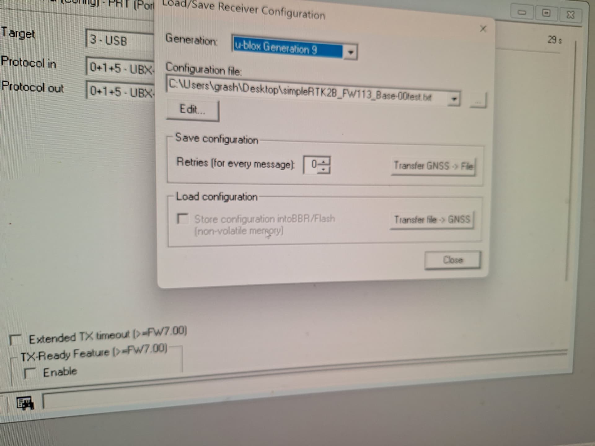

A question regarding setting up zed-f9p for base station.
I’m not able to save my config file to bbr/flash on the zed-f9p.
The select box is greyed out and cannot be selected. Does anyone have any tips.
Changes saved under CFG-CFG are not saved either…
You need to transfer to gnss not save. So bottom button
