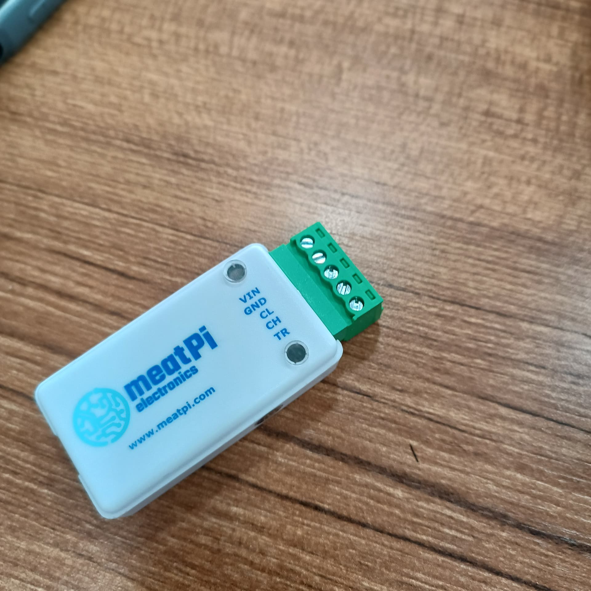

Hello ,I have this meatpi device ,on SavvyCan I can not see coming CAN-Bus messages.I have add end resistor 120ohm but still nothing.
What do I miss ? which firmware I need to upload to meatpi ?

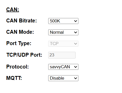

The firmware should be fine as it is, don’t change it. Via the web interface, change the output type to SavvyCAN at set baud rate (typically) to 250k. You don’t need a terminator for this, usually.

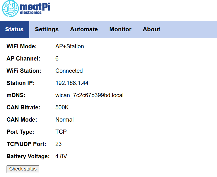

Also, if you don’t see messages, explain exactly what you’ve done and show the meatpi web interface settings. I presume you also joined your PC to the meatpi wifi AP?
The bus speed that I am going to listen is 500K. I plug the meatpi device to PC and configurate it via web interface.Set savvycan protocol as you said .then I connect my pc to my router network .

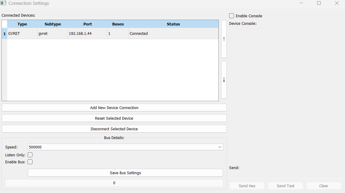

and then I open savvycan .choose Network Connection (GVRET) ,İt find the IP automatically.Although all of this ,no data coming .What do I miss? I am sending you configuration photos.

What version of SavvyCan are you using? I have been having lots of issues with recent versions. In the connect window there is a tick box “Console Window”. Tick it and see if you get packets in the console window. If you do, it is a Savvycan bug. If you don’t, your dongle is not connecting.

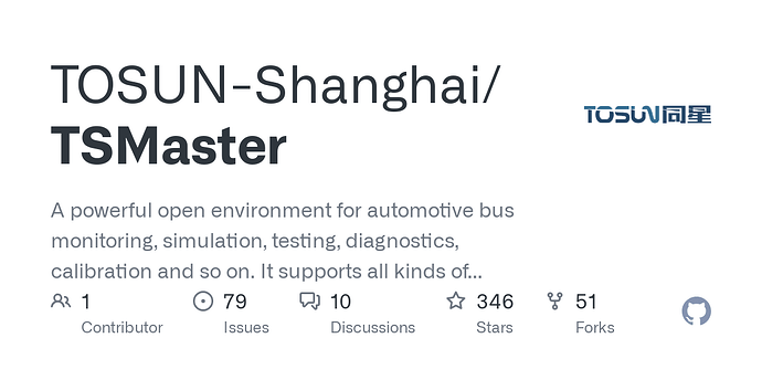

Found another CAN software package TSMaster. Definitely a learning curve but feature packed.

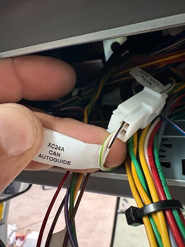

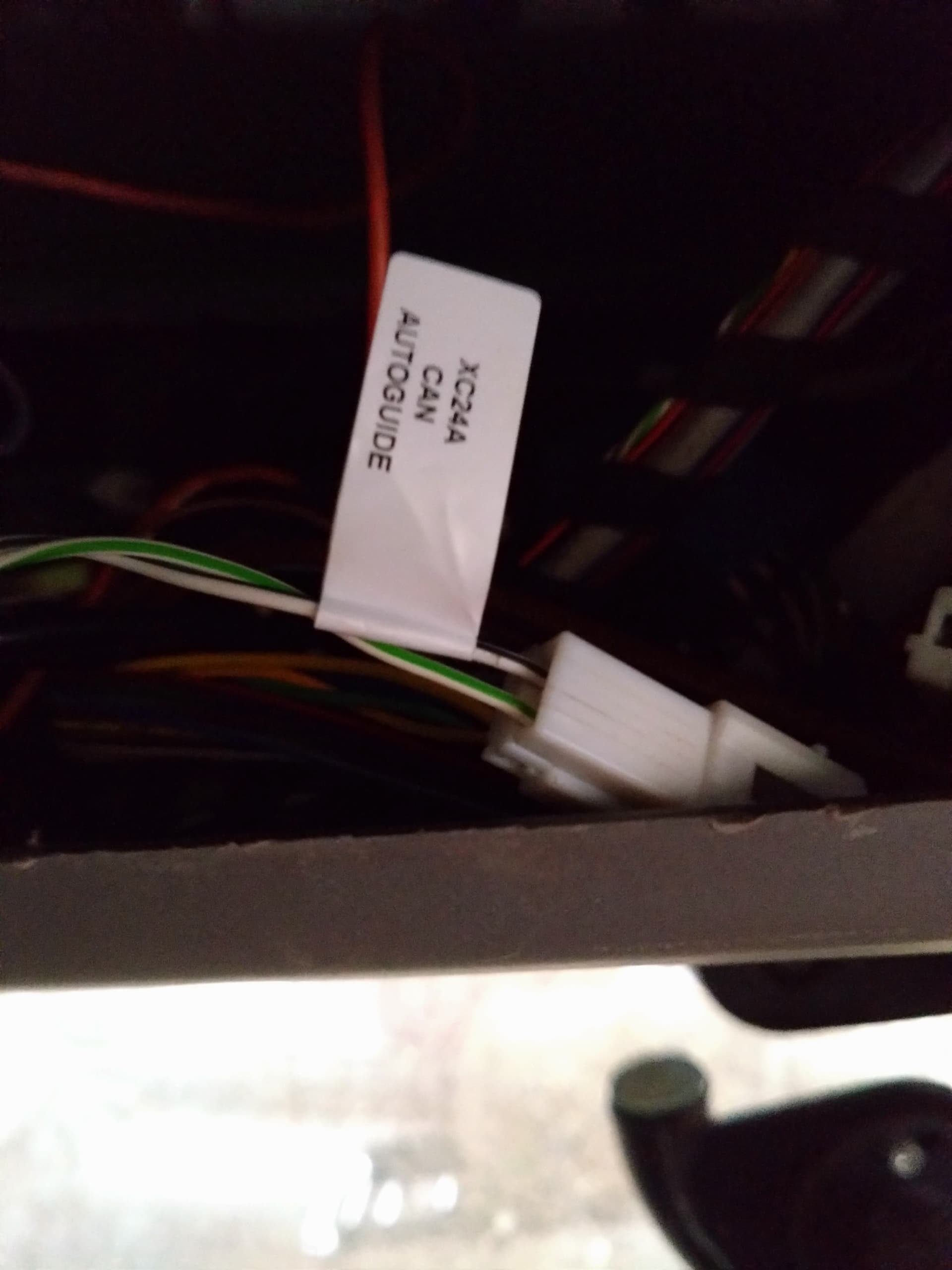

I haven’t checked the socket Andy is highlighting above but otherwise check behind the AC control panel and should be a connector and pair of wires labelled auto guide.

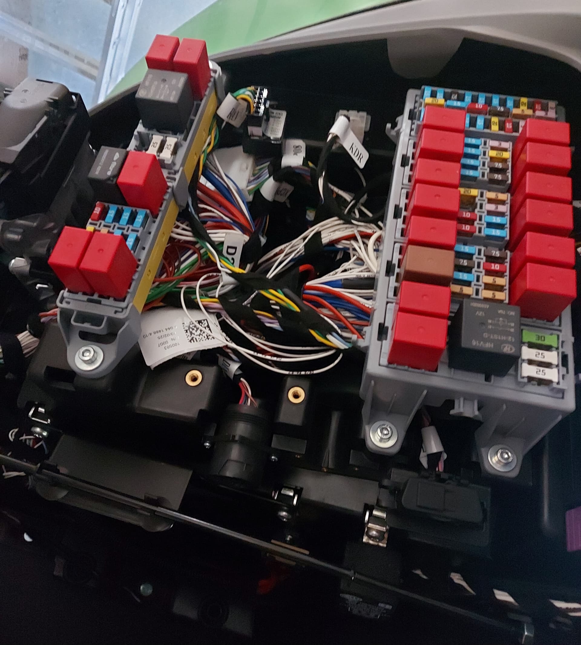

I just followed the 2 wires down to the fuse box and Teed into them there.

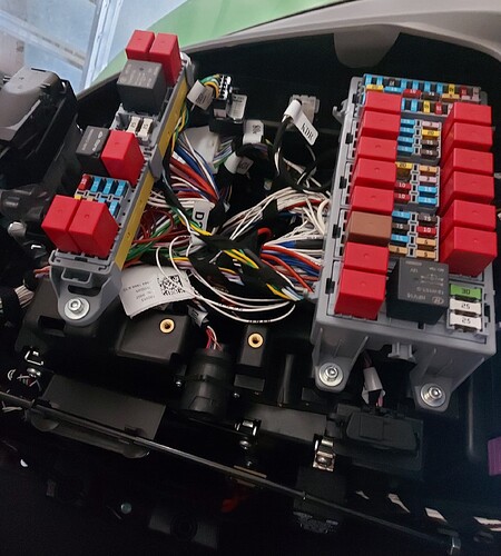

I’m looking to make a 6160 Warrior 2025, the fuse box is behind the seat. There is no circular connector as in the other models.

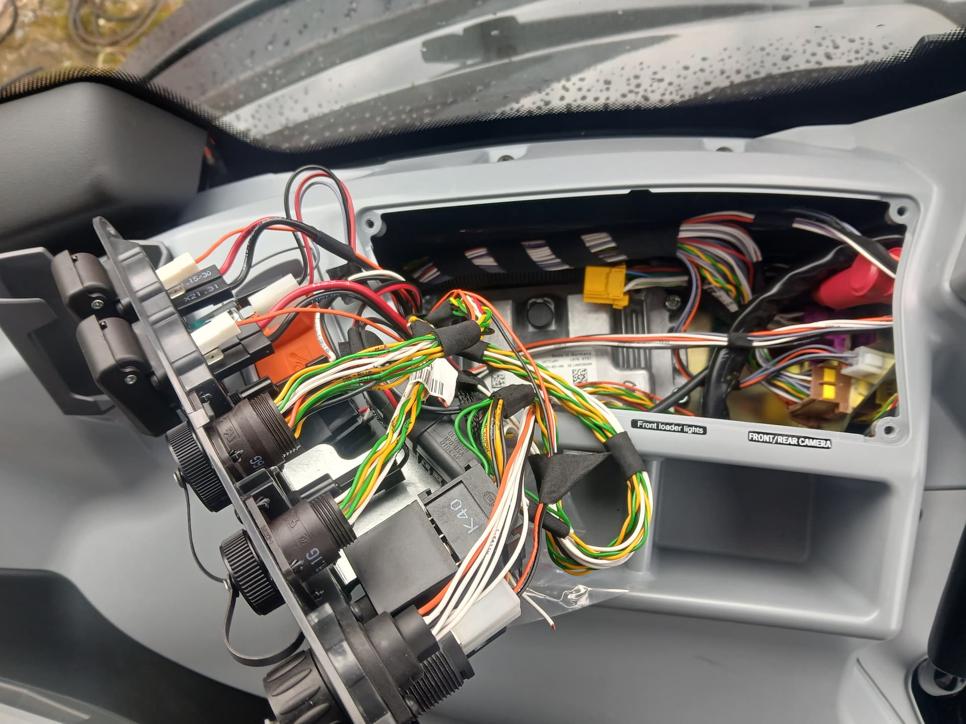

Have you checked behind the A/C control panel for that connector?
I’ll check in the morning which is can H and L.
Ok I found the connector, for now I have the WAS but no guidance. I’m on can3 PCB Tony Brand Massey/Valtra
