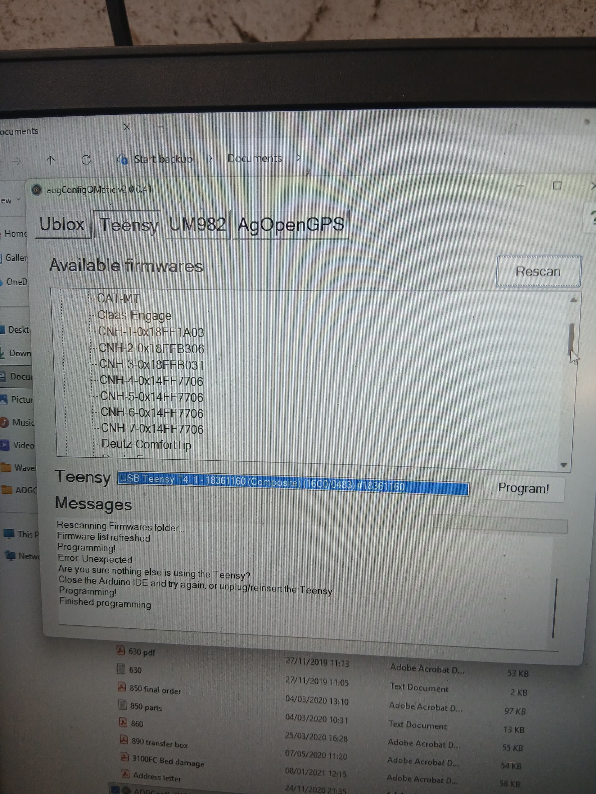

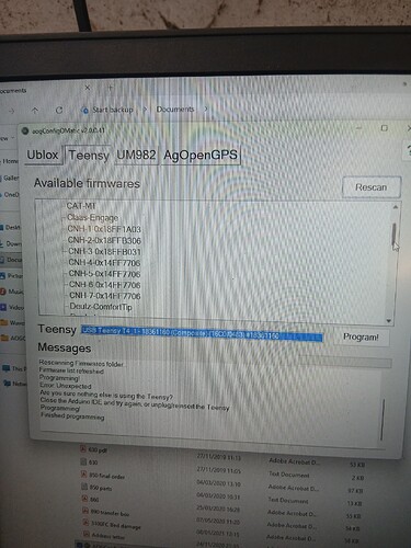

You can use this is you use the CANBUSEnable firmware and set it to new holland. Works well
Which firmware for the teensy do i select for dual 4.5v aio std board using can enable?
Try CNH1 first, then the others in order.
