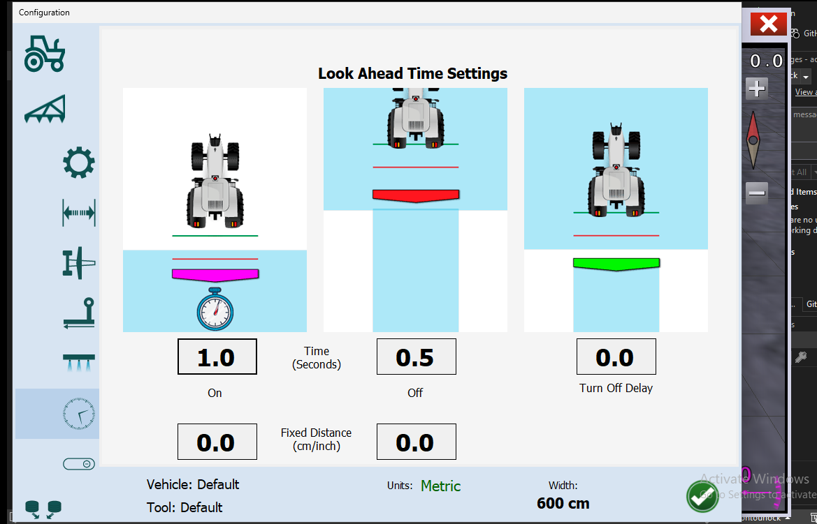

Hello everyone,
I am currently working with a system where the “Look Ahead Time Settings” (On Time, Off Time, and Turn Off Delay) are configured in seconds.
Since the machine’s driving speed often changes, it would be much more practical to define these values in meters to ensure consistent field coverage regardless of speed.
My question:
Is it possible to reprogram the settings so that distances (in meters) are used instead of time (in seconds)?
Ideally, the system should allow:
  • On Distance,
  • Off Distance,
  • and optionally Turn-Off Distance
to be entered and processed directly in meters.
If anyone has experience with this or can point me toward a firmware or software modification to achieve this, I would greatly appreciate it!

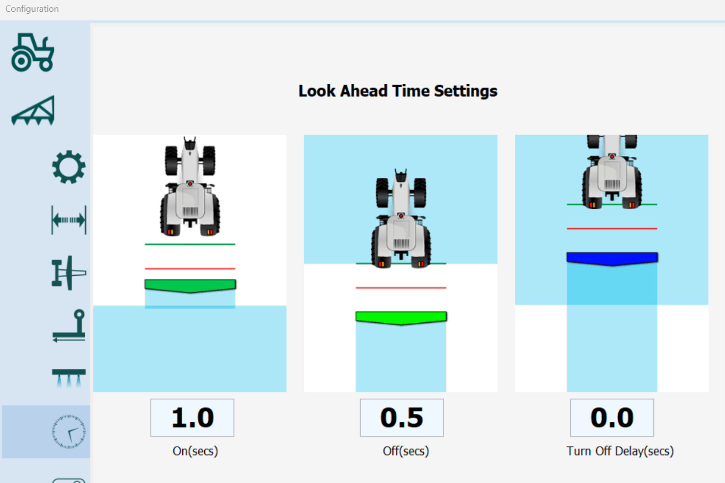

Like this?

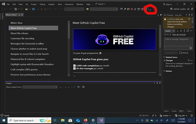

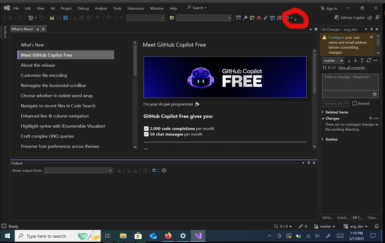

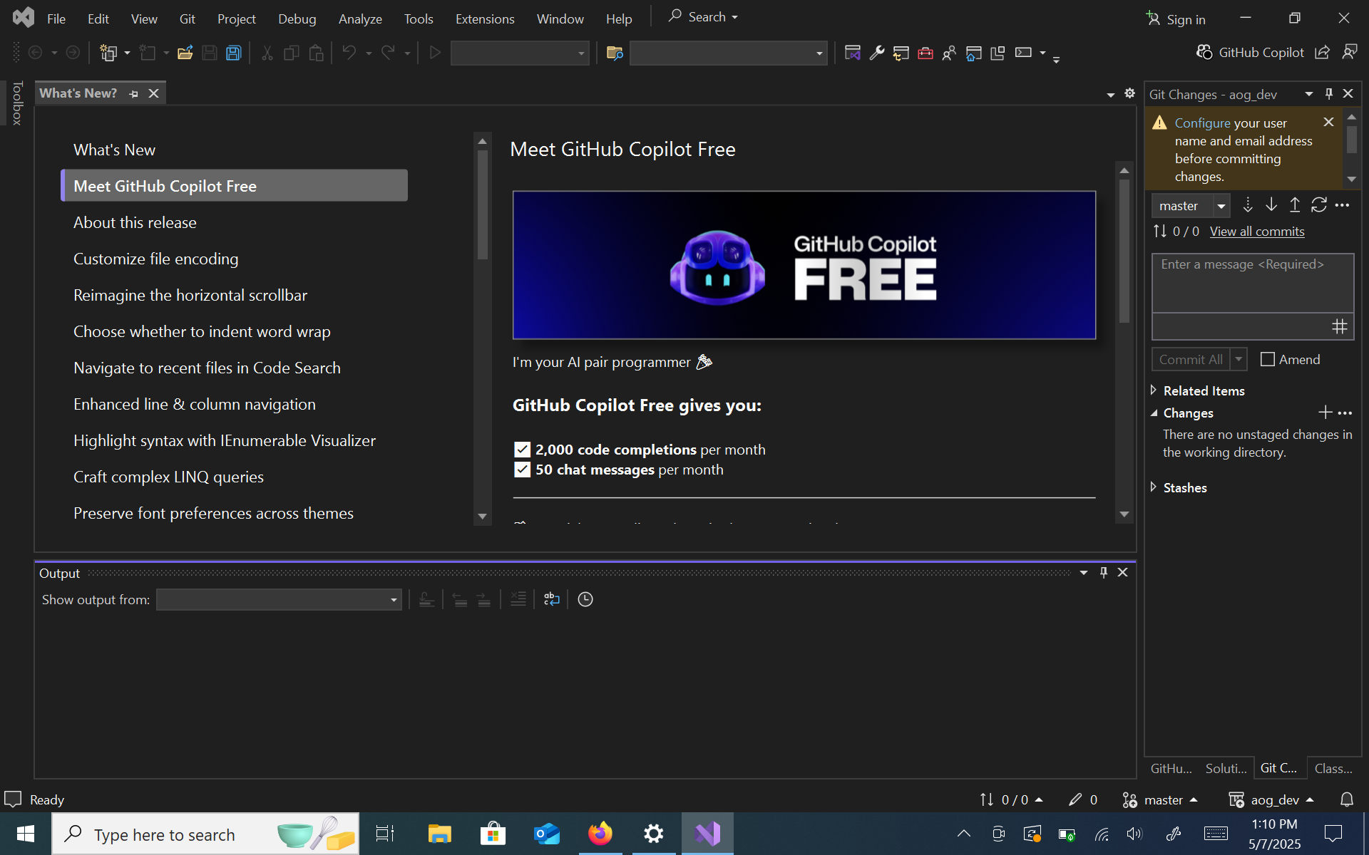

I am trying to get the Development version, I followed your article on compiling from source, it worked good. now when i tried to substitute the “web:address/aog_dev.git” file, it downloads the files but i never get the green triangles you talked about in your article. I am guessing i need to open or load a file in visual studio. can you tell me what? thanks!
~IH
It could be that your window isn’t sized big enough maybe.
Try clicking the arrow circled in the image.
If that doesn’t work, go File->Open->Project/Solution-> Navigate to the AOG.sln and open it.
I think i got it!!
your file path and opening the AOG.sln file was the key. i tried it earlier and i must need internet for it to work right. we will see if i can install AOG next. really glad to get this, i’m maybe going to play with this tomorrow.
