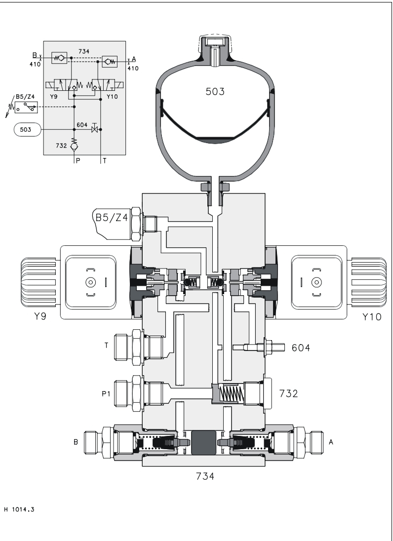

Anyone had success with integrating an AIO into a Claas Lexion to control the factory claas valve block?
Is that the autosteer hydraulic valve or the laser autosteer on the header?
Think the laser uses a bang bang valve and some users have managed to get it to steer with agopen i dont think its all that successful
It is this style valve, it doesnt have any laser pilot on the header so I’m unsure whether it is or not
Someone more educated will be able to advise you on that valve
What age is the combine
Its a 2003 Lexion 480, I have a suspicion that laser pilot was the main method back then. Appreciate your help
Id say then its probably a bang bang valve.
Dont give up but they can be used but take alot of setting up i think. Theyre also not very good at finding the line so autosteer needs to be engage when its on line i think.

I got a lexion 760 working on BB valve, but you’ll need the hold set way out in front. It’s not too bad at keeping a line, as Del says tho, you need to pretty much get it online yourself
