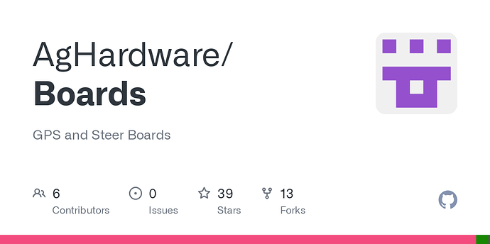

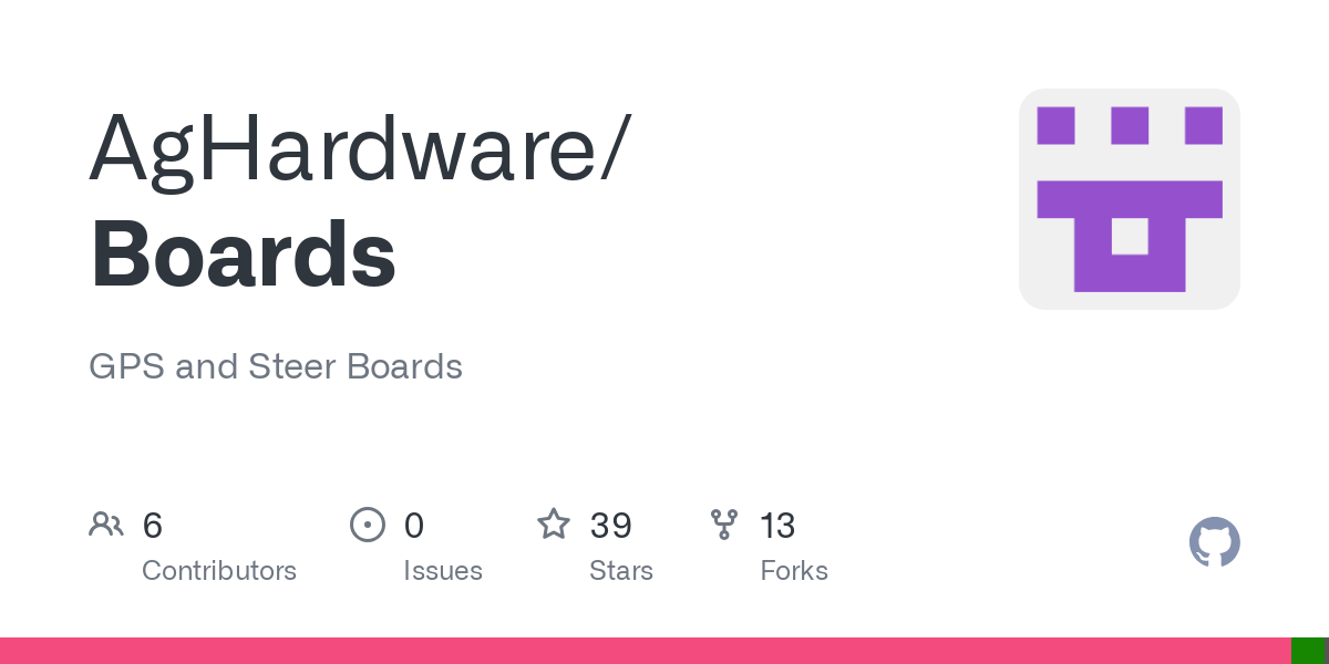

You can check out the Boards repo for the Teensy firmware. Autosteer.ino and zHandlers.ino have the code for the communications in them. The data is broadcast over UDP.
