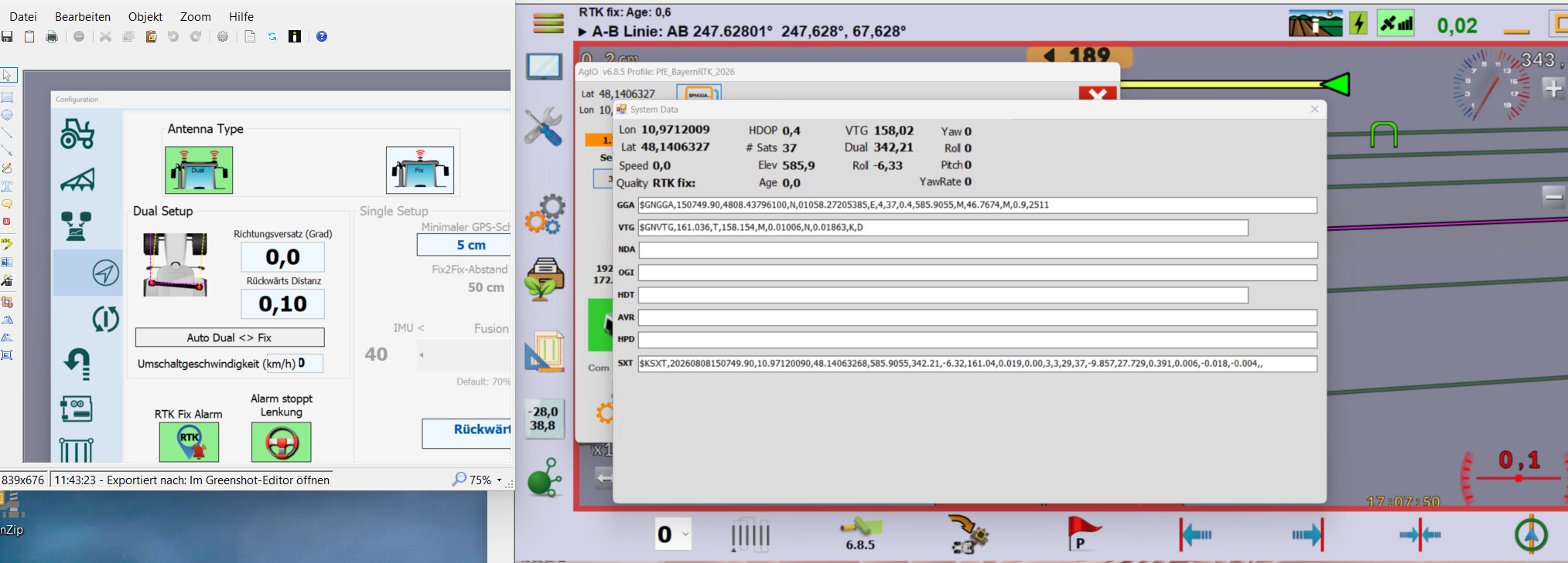

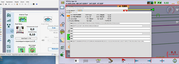

Hello, the data from the antenna is being received correctly, but it isn’t being processed in AgopenGPS even though I’ve selected “Dual.” What other settings do I need to adjust so that the heading and roll are taken into account?
Youve got a mis match on your um982 configuration
You have vtg and ksxt messages coming in.
What is your steering setup and teensy firmware?
Usually either use ksxt by itself
Or gga hpr to make paogi messages

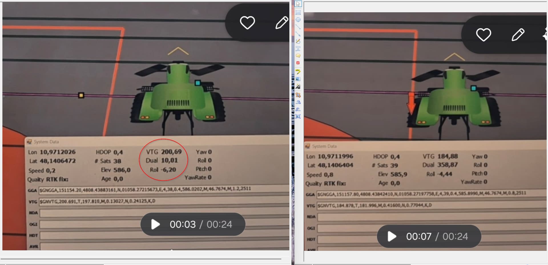

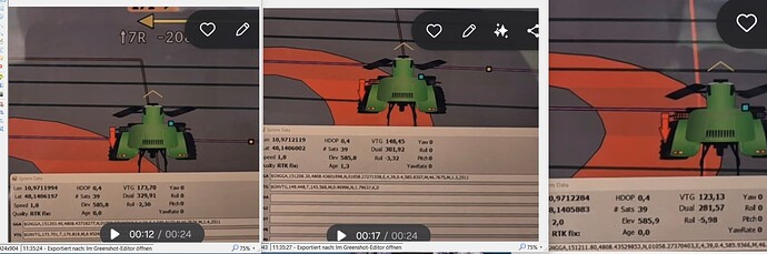

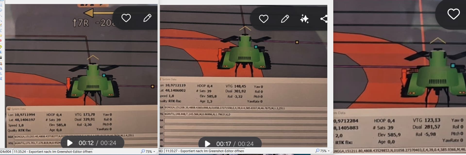

I am using Mechanic Tony’s CAN bus board and the firmware Autosteer_AOGv5_Teensy4.1UDP_SteerReadyCAN_04.05.2024.ino.hex. I have tried everything; AgOpenGPS steers correctly when driving straight, regardless of whether GNGGA & GPVTG or PAOGI is active. However, when stationary or moving slowly during a turn, the tractor’s orientation in AOG always jumps to a heading that deviates by about 45 degrees from the actual direction. There is a fundamental error in the system. Thanks for your help.Last time, the UM982 only output GPGGA, GPVTG, and KSXT. Which data and default settings work best with AgOpenGPS? I think I have an issue with the antenna configuration (Dual/Fix); the heading isn’t being picked up—it shows “no signal.”
