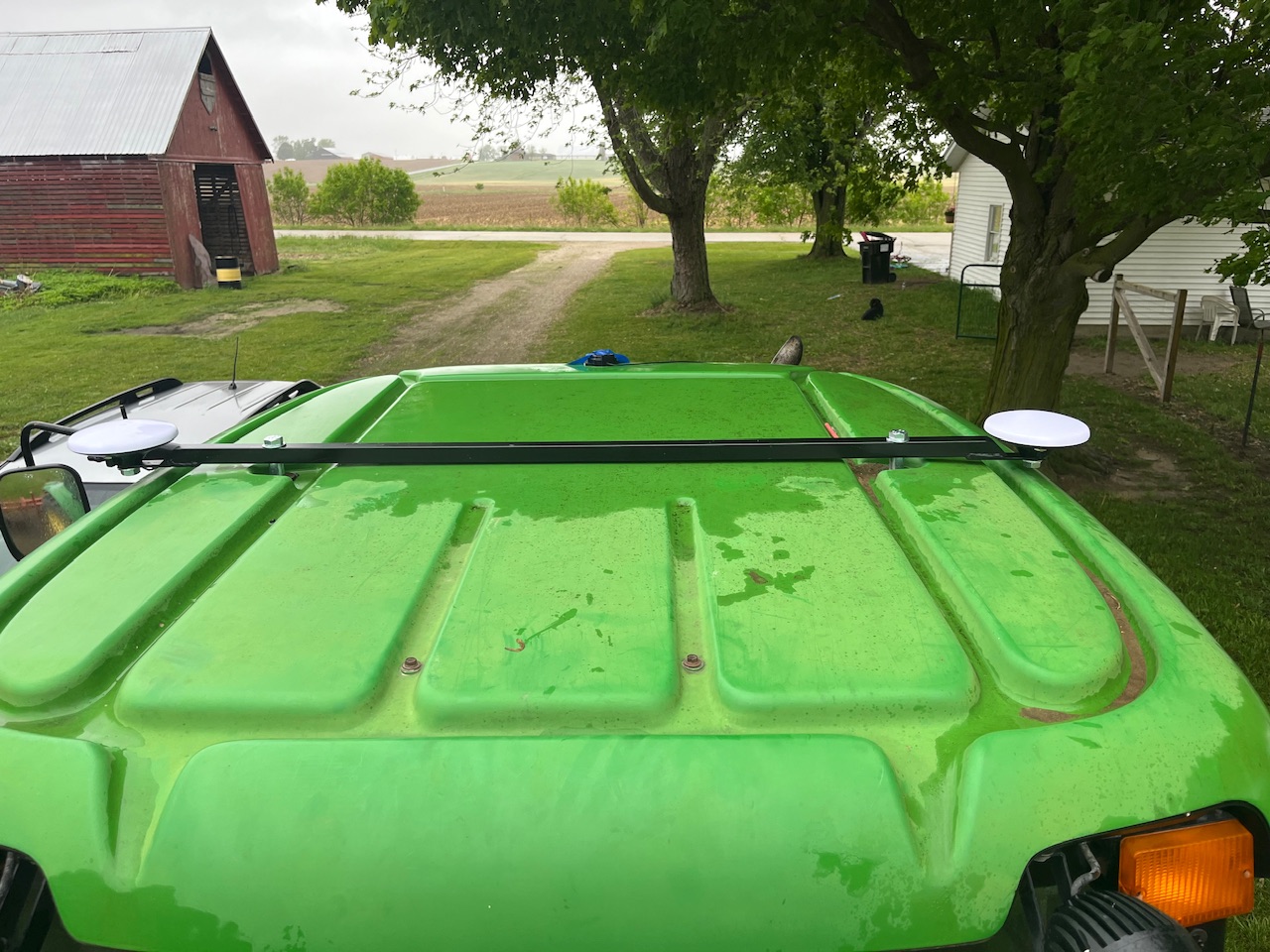

I fabricated a bar to mount the antennas on my cab mounts. The antennas have a spacing of 54" or 1.37 M.

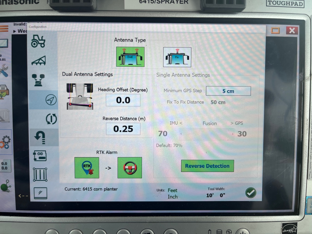

I then went into the settings menu of AgopenGPS (V6.3.3) and selected the antenna type dual button

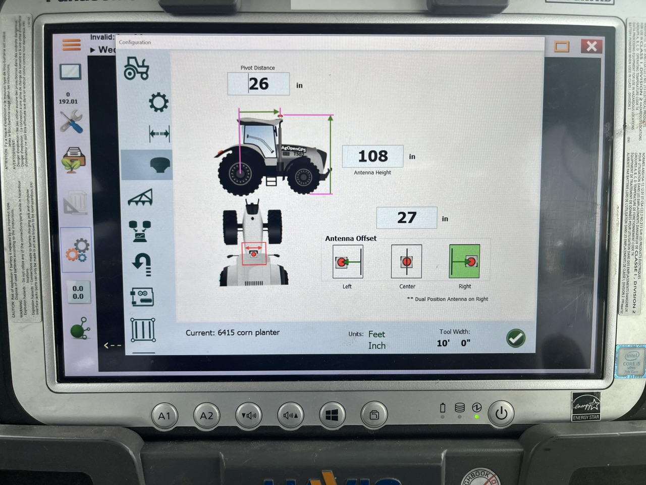

After that I entered my new antenna dimensions

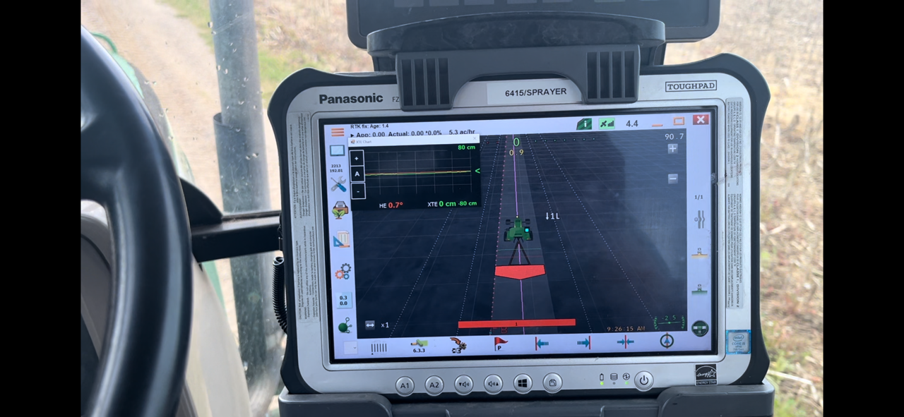

The first day I took it out and did some testing. On a paved road I could get very low XTE values, but to achieve that I had to set min to move and proportional gain values quite high and the front wheels were rapidly snapping their adjustments, they were not smooth subtle adjustments like I was used to previously. In the field I really struggled. I planted 12 acres yesterday, I kept playing with settings, but never really got it to the performance I know it’s capable of.

I am not familiar with the “auto dual fix” setting. I don’t know where to find that
When I went out to the tractor to take pictures of the settings in the menu. I just figured out what the problem was. I had forgotten to unselect “Invert roll” as I needed it, inverted for my IMU. I just took it for a quick test run down a bumpy gravel lane. It works great thank you for responding to my question.

You need the latest version of AOG to have the auto dualfix function.
Thank you, what is the function of the dual fix setting?
Thanks for the explanation
