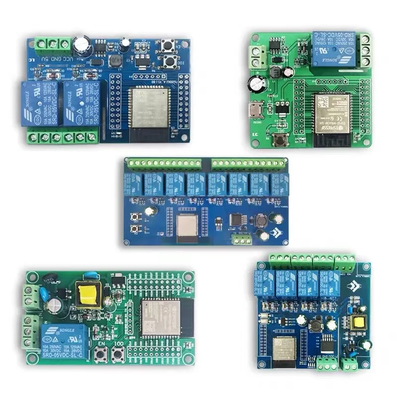

It works with these boards:
ESP32_relay_board.ino (35.8 KB)
This ESP32 board code can handle 16 relays in total.
