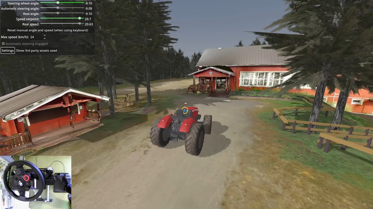

Made a lot of improvements to this and added support for force feedback steering wheels. Video:
Made a new version of this with a 3D-scanned environment. Video:
This version can be downloaded from github: GitHub - GNSS-Stylist/Virtual_Nahjus_AgOpenGPSSimPoC: External simulator for AgOpenGPS with a 3D-scanned world
