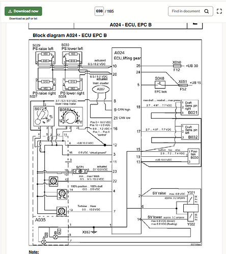

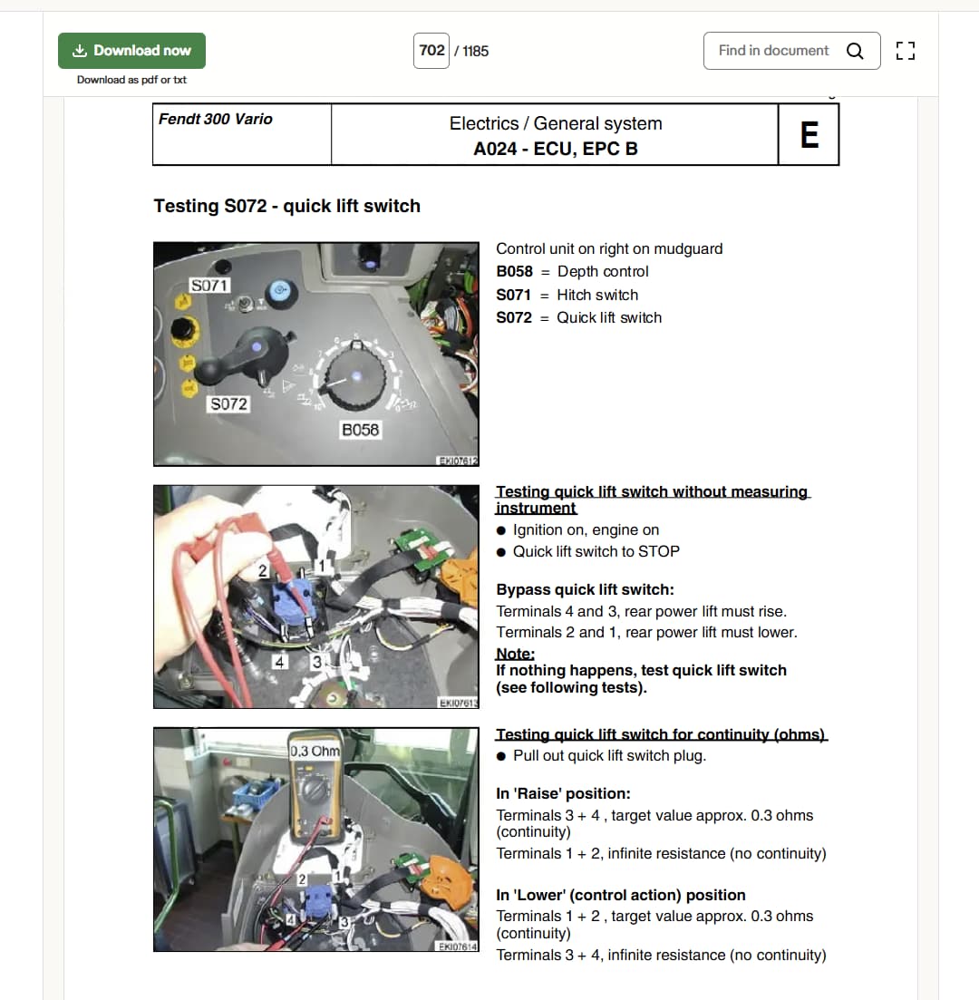

I would like to control the 3 point lift through the agopen.
I’m going to use an arduino with a relay board for this, only problem is that I don’t know how I can connect to the arms lever.
Would anyone be able to help me with this?
