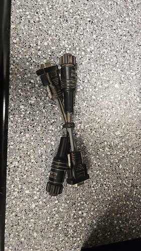

I’m sure there is a simpler way to do it, but we have a usb to 9 pin rs232 serial cable on the tablet, and then this adaptor on the precision harness.
Thanks. Seeing if I can find a used cable – be simpler than making one. I already have the USB to DB9 adapter cable.
