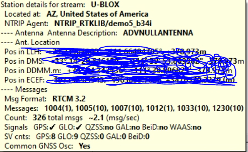

Yes for my first STRSVR test i did have all the msgs at the same rate, I sent that to snip and i think snips PFAT parse feature automatically configure what rate it should send out. When i tried to copy topnets msgs i did add the rates to STRSVR (picture below) and i got the same rates in snip but that still did not work for rtk
I did not include -TADJ=1 in the options because i am not even sure thats where it goes. i have no idea what is and what to do with -TADJ=1. how do you implement -TADJ=1? do i even have to? I also did notice i didn’t send a 1007 but a 1008 instead. i will try with the 1007msg and i will also try to enable just gps on my rover
Edit1: here is what i got in snip from my f9p STRSVR
Edit2: Failed results no rtk. i even did try gps only on my rover. maybe ill try 1007 and 1008 together?

huh i just noticed that the long lat height/altitude (LLH) of snip (right) is a little different from u-center (left). I can use snips pfat feature to correct this and see if that was the problem
these are the coordinates i got for my f9p antenna with my topcon hiper v with rtk. also note that u-center rounds up or down the last 3 digits even if i type all digits in timemode3. and if you notice the height/altitude is about 6 inches off from what u-center reports is because the f9p antenna is about 6inches up from where i surveyed.

edit1: okay i was successful in getting a fix using the snips stream(picture above, right side) with nothing changed, snip wasn’t as fast at getting a fix as just streaming ntrip data through u-center, it was a little unstable at first to but after a minute it was locked on a fix. i connect my f9p rover via usb to my Microsoft surface (tablet pc) and connect to u-center and entered the ntrip credentials

Probably makes no difference here but I’m puzzled about the base coordinates being different as reported by SNIP. I run SNIP too, my RTKBase feeding a stream to snip and in my case SNIP reports exactly the same coordinates as I’ve entered on RTKBase. Are you sure you are using TIME MODE “2-FIXED”?
Your Topcon tool reports coordinates at extreme resolution. By default F9P uses 6 decimal digits (hope I got this right from memory) and 8 digits in high precision mode. Seems you are configured with HP which is essential but no further resolution is needed. This should be in some mm range, a fraction of practical accuracy anyway.
