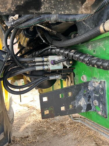

I installed the baraki 30L LS valve on my 6830 which is same system as 6920

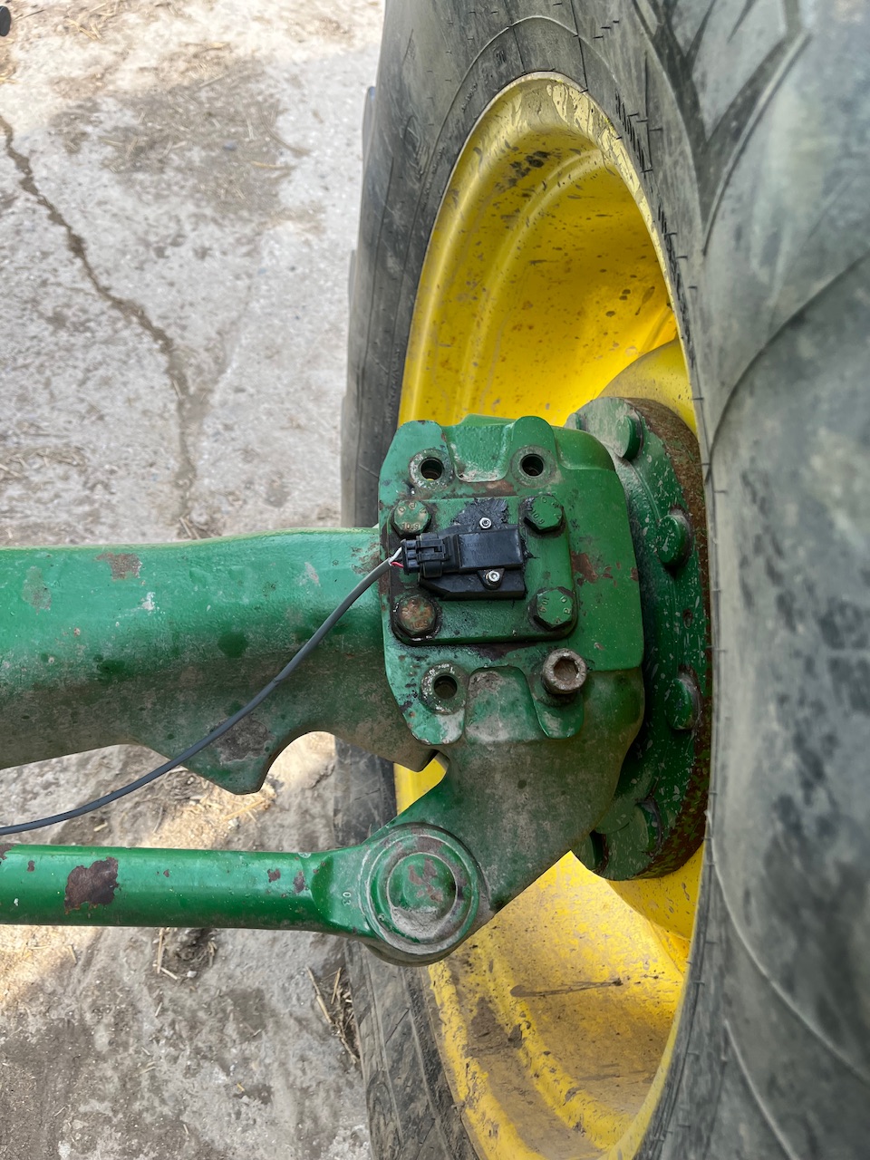

And a Honeywell RTP hall sensor for the angle sensor.
