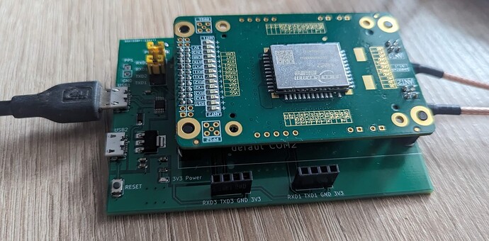

Where is the UM982 adapter board available from?

So is the UM982 breakout board slot compatible with the v4.5 AIO mainboard? i.e. I’d buy this board (that @chri5k linked in the first post) and it would slot in the AIO mainboard and with the correct Teensy4.1 firmware (I think @chri5k’s repo has the latest sketch) should just work?
Hello i bought this UniCore UM982 Dual-Antenne RTK GNSS Hoge nauwkeurigheid voor landmeetkunde/kaarting/bouw met GNSS-antenne direct versus um980 - AliExpress 34
in aliexpress it´s easy to conect to AIO V4.5
I think I would have to put a USB to UART adapter to get the TX1 and RX1
