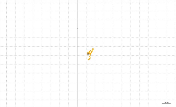

Did a few plots using RTKLIB to compare the F9P with the UM982. Both used the same antenna setup which is what I would term somewhat obstructed. The antenna’s have about 1/3 of the southern sky obstructed making it very difficult to get an RTK Fix. Both receivers were able to get an RTK Float fix.
F9P was using the “main” antenna AOG configuration. The UM 982 was using the attached configuration. The biggest improvement to the UM982 data was seen by enabling Multi-path Mitigation (MMP). Changing the mode to Rover Survey Mow made an improvement but not as much as MPP.

F9P Ground Track
UM982 Ground Track
F9P Positioning
UM982 Positioning
Being as I’m not educated enough to make sense of the charts… do you feel one is significantly better than the other?
