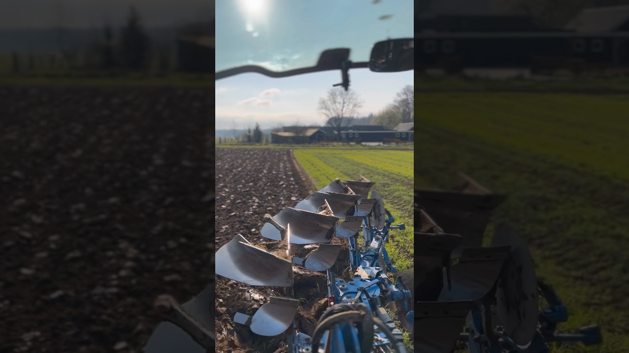

I have a isobus plough control wich im running via windows and AgOpen but i would like the same setup as you, one screen for AOG and a extra one to run isobus. it works so far but you cant open them both at the same time on one screen so you need to swicht often to check if everything is running right.

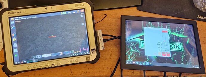

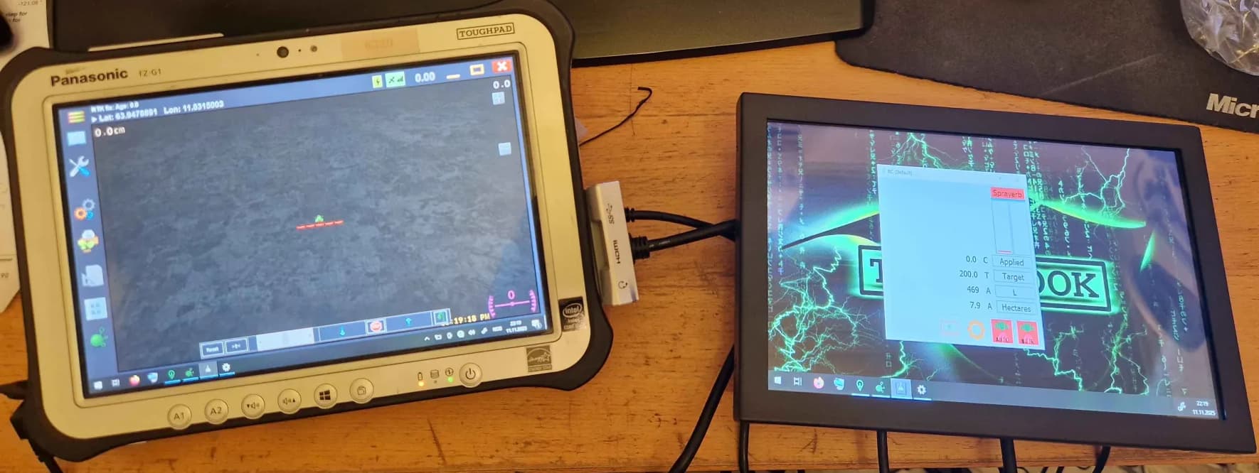

I have a plan to order one of this with touch and use as a dual monitor system on my tractor for the RC app. Guess this can be an option for isobus controll as well?
Panasonic FZ-G1 support dual screen setup :slight_smile:
If the touch-screen element works, I guess it could. Let us know how you get on :slight_smile:
How did you get a AOG XTE output without enableling autosteering?
Got it today, Just plug and play :smiley:
Touch work on both screens
