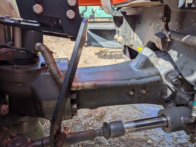

I’m just experimenting with an M6. I’ve tapped into a wire on the built in WAS and it seems to work perfectly.
Great! I ended up installing a separate was
Whereabouts did you manage to tap into the wheel angle sensor?
