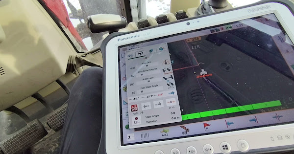

Massey Ferguson 7700 autosteer ready

Hi, i try to install AgOpenGps on MF 8670 steer ready. I connect CAN x184 and i saw wheel angle. I enage by button(connected to board) but after enage it not steer and wheel angle change to ±0,8 left/right to “SET” value. When i turn wheel is disable. I use Tony’s board. I set MF in command line. What can be a problem?
