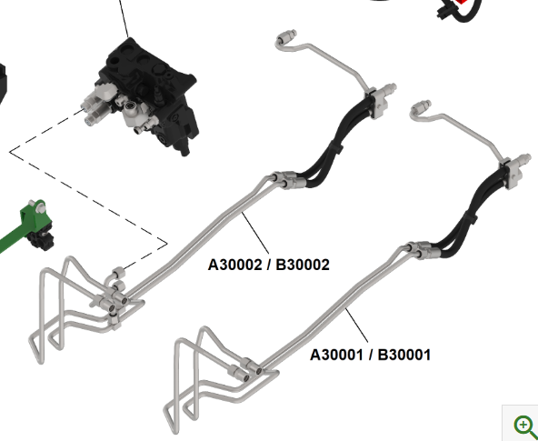

I would say no. I think steer capable means here you have to use the ATU300 at the steering wheel. But you could check it very easy. When your hydraulic pipe looks like the pair in the front you have no valve. When it looks like the other pair you should find a valve under the exhaust mount.
The valve is “analog” not can. Take a look here: Build report/documentation John Deere 6170M That is my build report for my 6170M. The valve and the WAS are the same.
