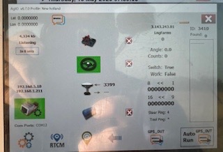

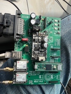

I would guess you have something set wrong in agio. You should post a picture of your board and what you see in agio with the blue arrow expanded

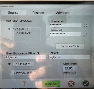

on the rover type in rtk2go then click verify

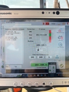

Picture of Ethernet setup window would be helpful

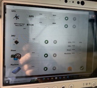

First as you probably know you need to get the antenna and the imu connected. You get to the Ethernet settings for that by clicking on the green picture of the Ethernet plug and gear in the third picture. Follow the instructions on how to connect that here:
Once the antenna and the imu light up green you can go to working on rtk. When you are getting messages from the caster you will see them show up in the box in the third picture where there is just dots now. that part might be working as you have it set up now and nothing is showing up because you took the picture before it had time to get any. If it wasn’t connecting at all you would get a dialogue box saying not connected to caster.
Then click on the position tab in the second picture and make sure udp is selected. (Ie is green). That will let agio know where to send the correction signals.
The last picture shows the screen for connecting to the board using USB. You don’t need to do anything there.

Try switching to a different subnet in both windows network settings and agio. Like a different number other than 5. I have had that work before. Also, what lights do you have on the board? Is the teensy orange light flashing?

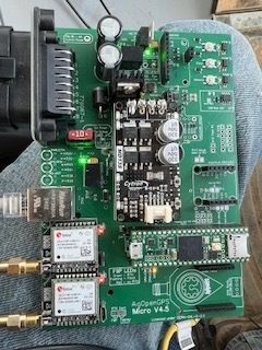

Both antenna are red. 3 green voltage lights no light on teensy
You need to have a orange light flashing on the teensy. If you don’t it is not getting signals from the f9p to the teensy
When it was connected before was agopengps working or did agio just say you were connected? Could you post a higher resolution picture of your board? I’m not as familiar with the micro as with the standard but it looks like you might be missing some pieces

Teensy orange light will not blink, if antenna signals are too weak.
I am outside not near anything. Skys are clear. Here is a picture of the light on the board.
