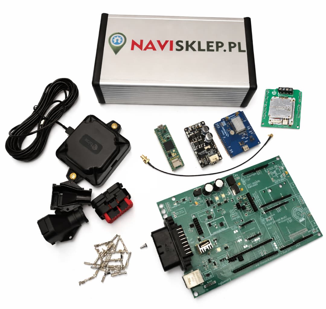

As mentioned above, we invite you to visit our online store.
https://navisklep.pl/en/?v=9b7d173b068d
We have all the components you need, from goldpins to complete kits, and if you don’t see something in the store, you’ll probably find that we have it in stock after sending us an email :stuck_out_tongue:
Even if you don’t want to buy the entire starter kit from us, check the description, because it lists all the elements that make up the ready-made AIO V4.5 controller.
https://navisklep.pl/en/k/starter-kits/?v=9b7d173b068d
